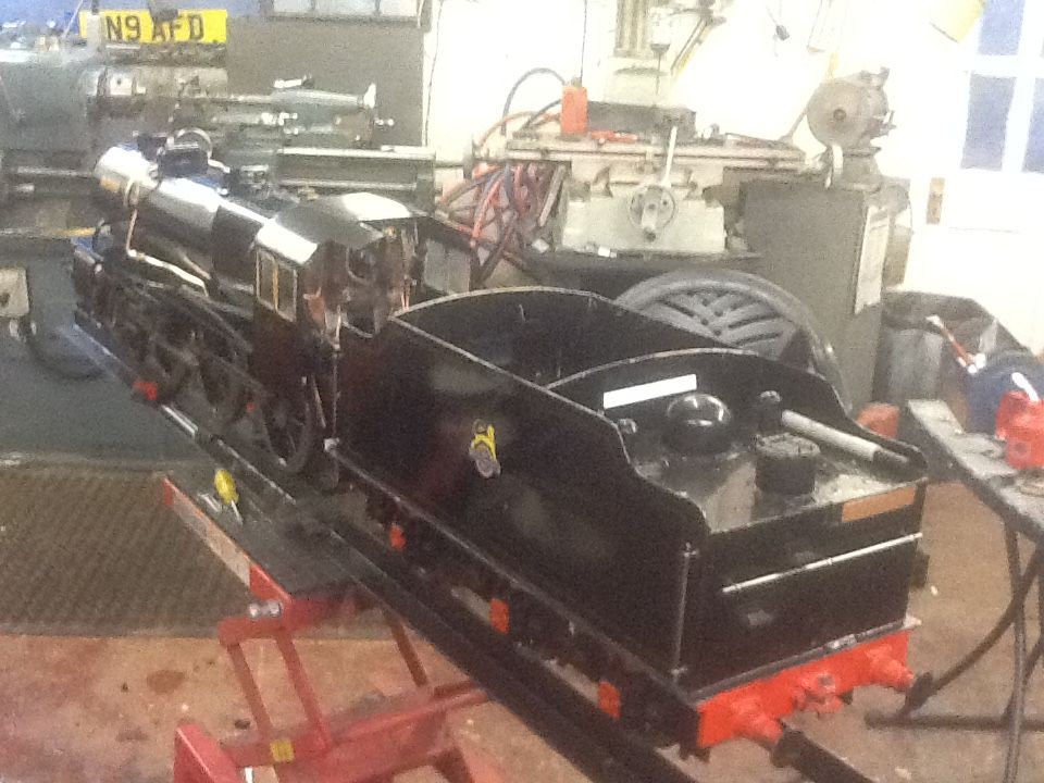

                #231919
                Ron Hancock
                  @ronhancock63652
                  Well today is a good Day I fitted super heater then back head fittings only leak was very slight from gauge glass.
                  They took it up to 135 so now I can start to fit the boiler.
                  I just hope not too many more problems be nice if I can get it done for We'd so I can do the steam test.
                  Thank you all for the help getting here you have been a big help
                  Happy Easter
                  Ron

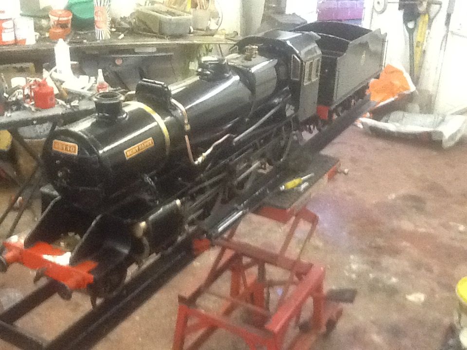

                          #232149
                          Ron Hancock
                            @ronhancock63652
                            #232150
                            Ron Hancock
                              @ronhancock63652
                              Ready to put fire in to slowly bring up to temp ready for steam test on Wed let's hope all will be good.
                              #232167
                              Peter Krogh
                                @peterkrogh76576
                                That's really great, Ron! She's a beauty.
                                Please do me a favor and get some outriggers under the ends of that. I'm worried sick it will fall on you!!

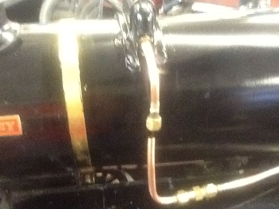

                                                Well still not steaming as yet but getting very close took loco to club and re plumbed the tender to loco for the first time. I tried to steam but one clack valve would not work and its new so i have ordered two more this time from polly at Notts. Hoping to steam her Sunday it went through another pressure test all was fine this time. I have also ordered a new no 3 injector as the one from Reeves 2000 playing up. hope by Sunday might be able to finally run it. Ron
                                                #234527

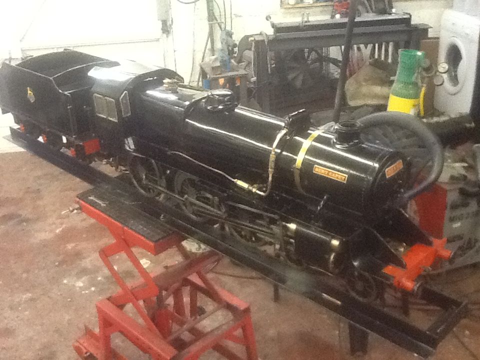

                                                  #234619
                                                  Ron Hancock
                                                    @ronhancock63652
                                                    #234621
                                                    Ron Hancock
                                                      @ronhancock63652
                                                      Finally back together except for new clack valve coming tomorrow. Hoping it will steam OK Sunday.
                                                      After so many problems it feels great to see it together again hope not to many more problems when I do steam test.
                                                      Had a lot of help from club members sorting my Tender piping out.
                                                      Hope it does not rain Sunday now but still going if it does.
                                                      Thanks every one for all your help getting here one happy novice here
                                                      Ron
