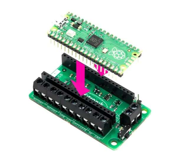

this https://kitronik.co.uk/collections/accessories-for-the-bbc-micro-bit/products/5698-compact-motor-driver-board-for-the-bbc-micro-bit will drive a small stepper.

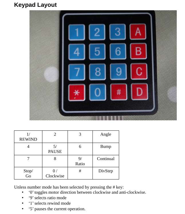

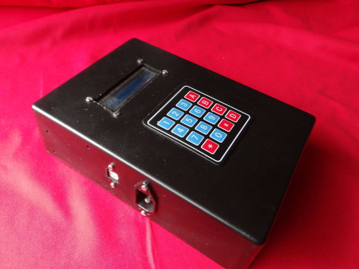

Prodded by the late John Stevenson, who hated nested menus, I wrote an alternative to Gary Liming’s Arduino effort: Gary used a combined 5 button/LCD IO module, whereas I use a 4×4 keypad, and separate LCD display. My version also has some extra features like backlash correction, undo/rewind, and remote control. Performance is similar. Intended to be an MEW article, but I thought World of Ward and Gary got there first.
The keypad eliminates nested menus by allowing numbers to be typed in directly, and simply by having more buttons. I decoded my keypad thus, using A for Angle, B for Bump, ie ‘Jog’, C for continuous, and D for division steps.
I think 4 or 5 have been built, most recently by Peter Cook of this parish, who spotted a couple of bugs and suggested an improvement. Looking at the code to confirm Peter was right, he was, reminded me I’d intended to revisit the code with a view to driving the table faster. At the moment the Arduino drives a 90:1 HV6 reasonably, but I’d like it to be faster.

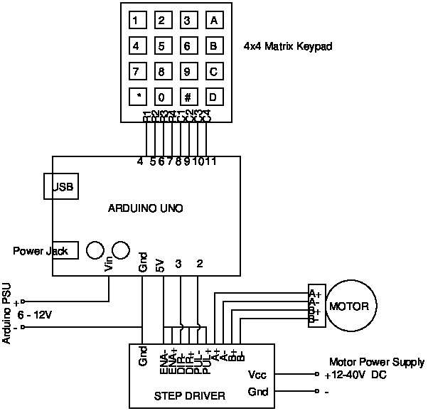

Motor speed is limited by how fast the microcontroller can send pulses to the controller, and is throttled in my implementation by how long it takes a 16MHz Arduino to loop through the control logic. Written in C so adequately performant, but my design does motor control by “bit banging” in software, which is slow. I hoped to use one of the Arduino’s built-in hardware counter/timers to send a stream of ‘n’ steps on demand, which would be much faster but turns out the Arduino family doesn’t support that.
Same problem with the Micro:bit. Python will make it easy to implement the control logic, but Python may not be fast enough on a 64MHz M0 to bit bang a stepper motor as quickly as needed.
The reason I’m looking at the pico is because it includes a Programmable Input Output peripheral/ The PIO contains 8 individual state machines each specialising in high-speed IO, making it very easy to send ‘n’ pluses. Freed of responsibility for pulsing. MicroPython on a pico should be plenty fast enough for everything else.
I’m not sure about the Micro:bit. As far as I can tell from the datasheet pulses would have to be “bit banged” by the software just as I’ve done on an Arduino, making the table’s RPM uncomfortably slow. Confident it will work, but not that a microbit will be adequately fleet of foot. Will a high-level, semi-compiled, user-friendly, garbage collecting Python program on a 64Mhz processor keep up with a fast. efficient compiled C program on a 16Mhz processor? I suspect it won’t, because Python trades performance for fast development, whereas C delivers fast efficient executables that take much longer to write.

My fault Robert, I didn’t explain the issue at all well!
If an Arduino, or PIC, does nothing other than toggle a pin, it easily outruns a motor-controller. The issue is that a rotary table program has a great deal of other work to do. A control loop monitors the keypad, parses commands, and drives a slow-mo LCD display. Commands can be entered whilst the motor is running.
The requirement is to issue ‘n’ pulses that will operate a stepper motor controller at an acceptable rate, ideally user set. Brownie points for altering the pulse width and rate to accelerate and de-accelerate the motor during start/stop. (I haven’t attempted that!)
My ‘bit banging’ solution. At the end of each control cycle, taking a few milliseconds, the program pulses the motor-controller, counting down the number of steps needed to fulfil the last command one at a time. As the motor is slow, the program can’t simply send a stream of pulses at top GPIO speed, rather it emits one pulse only, repeats the control loop giving the motor enough time to move, and counts down until all the steps are sent. Thus the pulse rate is limited by how long all the other processing in the control loop takes, which is much more time consuming than the couple of lines that start and stop an individual pulse.
A messy solution because pulse timing depends on balancing how much work the program does as a whole, how long each function takes, what the motor-controller can take, and how fast the motor moves. Nothing in the code is allowed to block the control loop, and all the functions are engineered to do their stuff quickly.
I’m looking to off-load pulse management to the pico’s PIO peripheral, so that the speed of the control loop doesn’t affect pulse width or pulse rate. Not quite as simple as letting the PIO run independently because the user must be able to pause and restart the motor – the PIO must be interruptible.

Normally, rotary table drivers are just a black box, plugged into the mains, and connected to a stepper motor replacing the rotary table’s crank handle. Meant to be easy to use rather than feature packed as full CNC has to be. The operator plonks the black box down anywhere handy, types in what he wants the table to do, usually just turn an angle, and then hits the go button. Mine is mostly used for cutting gears: all it does is turn the blank one tooth space at a time, and then stops whilst the tooth is milled, before I tell the balck box to turn the blank again. No need to worry about the complexities of grbl or how to generate g-code for straightforward indexed table turning, for which a simple push-button interface is ideal.
My code allows the black box to be commanded remotely by a USB connected PC as well as obeying the keypad, providing a sort of junior CNC capability, but I’ve never used it in anger, and now think the remote feature is an unnecessary complication.
I use this Kitronics motor controller to remote control dual DC motors (with a PicoMite mounted on it) in my model G3 (battery electric) locomotives. It can also be used to run a stepper motor too, although I’ve not done so yet. It’s a very tidy solution and quite affordable (about £9-10 pounds from Farnell or Pi Hut)
