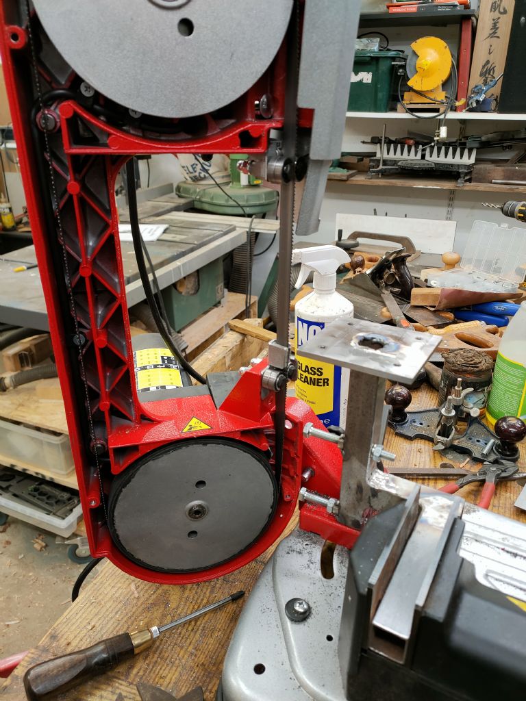

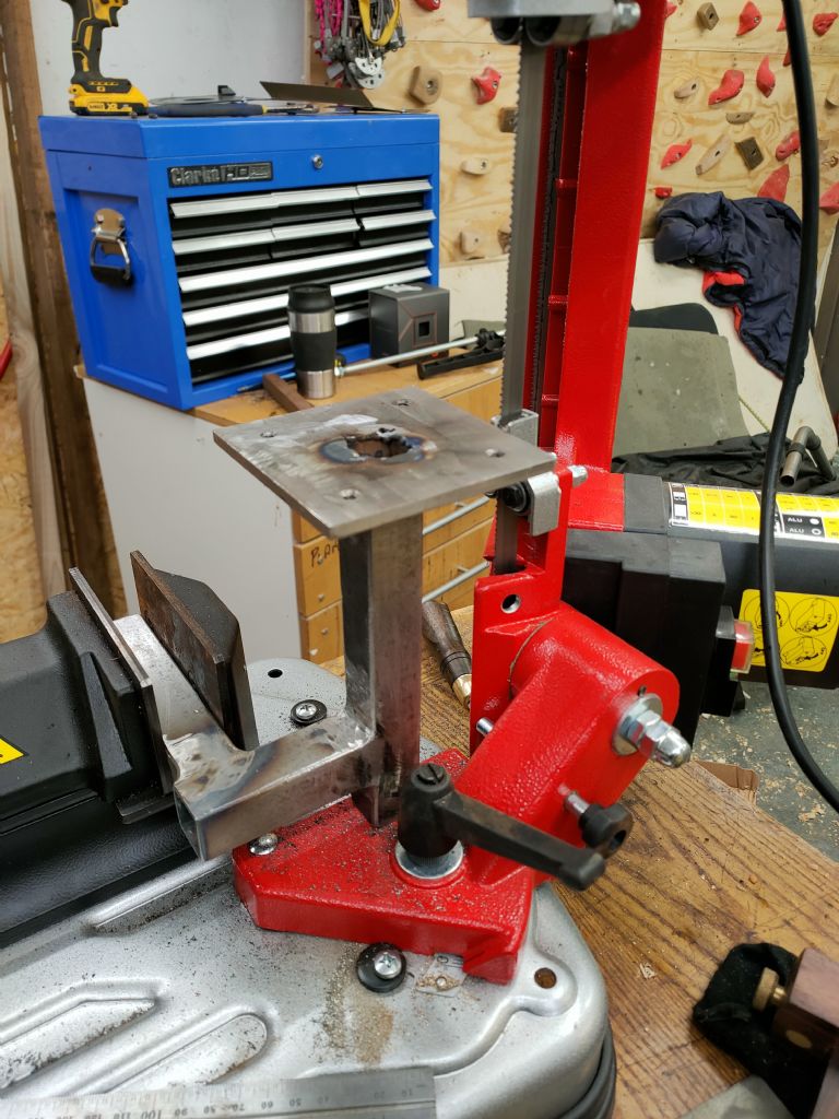

        I just bodged/fabricated a table for my Femi. Works well – self aligns (once set up).

          Shouldn't the table embrace the blade?

            I left the final platen off in the pic so you can see how simple the design is (I copied it)

              Thanks for explaining. I made a false table for mine in SRBP (like Tufnol) for use with delicate materials.
              BTW, it looks very sturdy

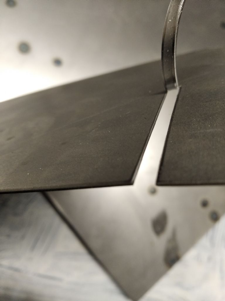

                  I own a Femi but it wouldn't be my first choice for sheet metal work, I've just been making a shelf for inside a tool cabinet, using an 18v Makita shear it took me about 40 seconds to cut a 500mm x 700mm shelf out of 1mm sheet steel.img_20221116_205246.jpg
