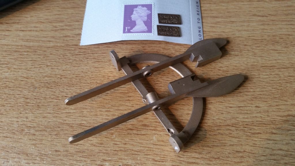

      A couple of pictures of the throttle and magneto quadrant with the levers. One photo includes both lamp plates before they were fitted, resting by a 1st class postage stamp.

        More silicon bronze investment castings from wax prints

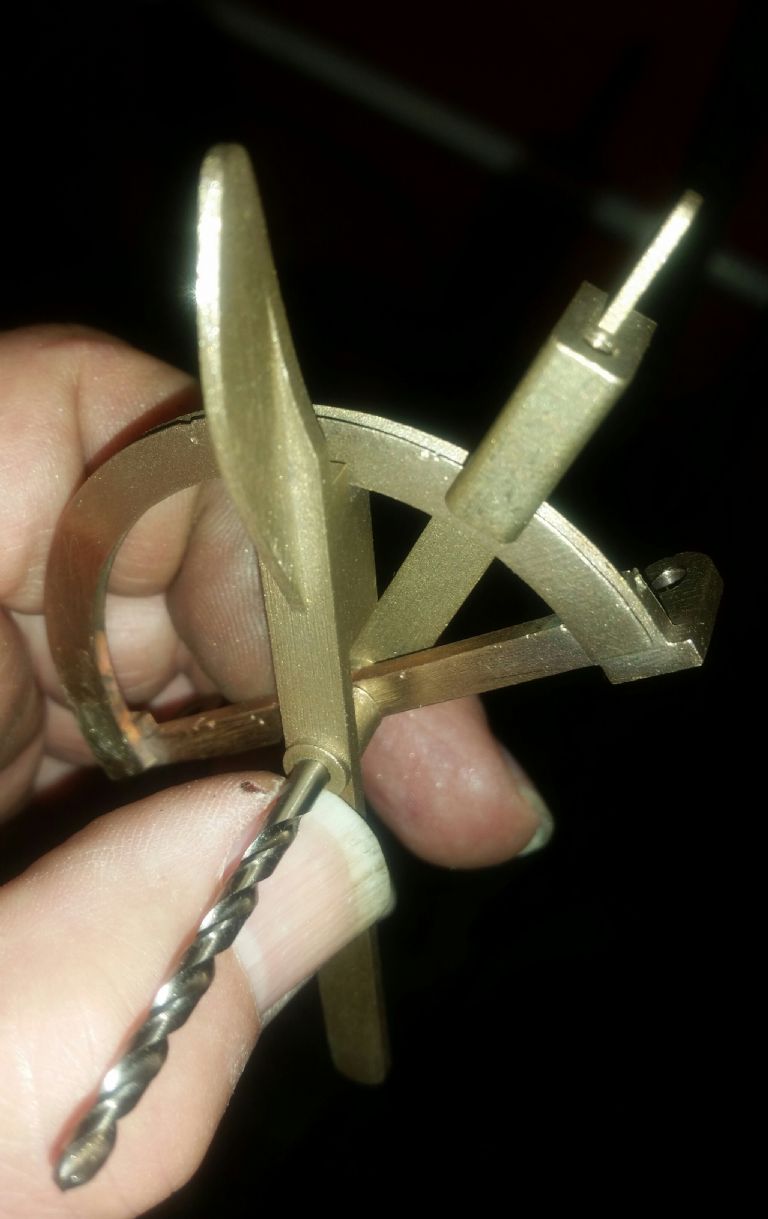

          I've done a bit more today, finalised the drawing of the spring loaded friction parts and drilled and tapped both levers to take the bits. The rear one is drilled through and has a plug, but the front one is blind and has a drilled bush to guide the business end of the pin. I'm going to cheat and put some wavy washer friction in the pivot shaft too. I hope to make them tomorrow.

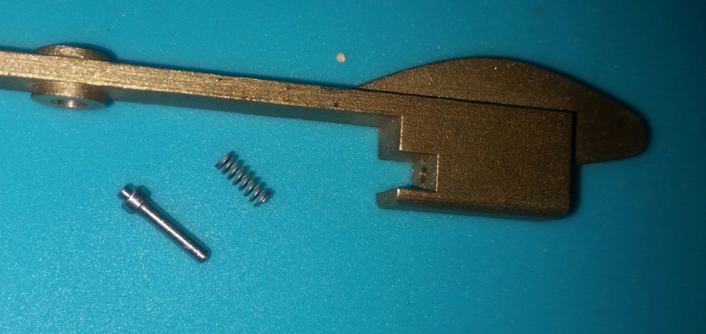

                I have ordered a bit of 3mm precision ground steel for the pivot. I got the spring loaded bits made and fitted yesterday. Making daft little bits in a 5" centre lathe with a top speed of 800 isn't a lot of fun.
                I just need another turn of thread in the lever with the tapped hole in the picture above, to increase the spring pre-load slightly. I managed to use the runners off the nameplates to make the "bungs", so they are silicon bronze too.
                This is one of the friction pins and the spring, 2.2mm x 5mm long.

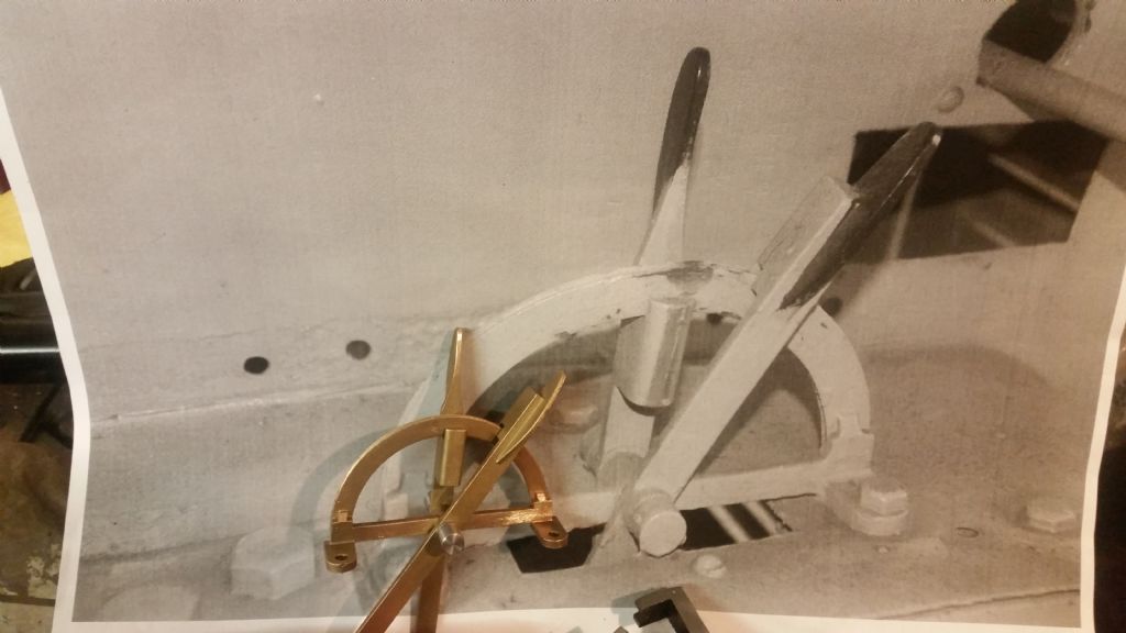

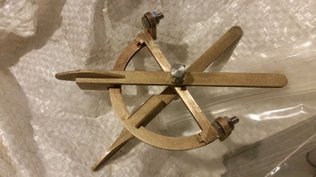

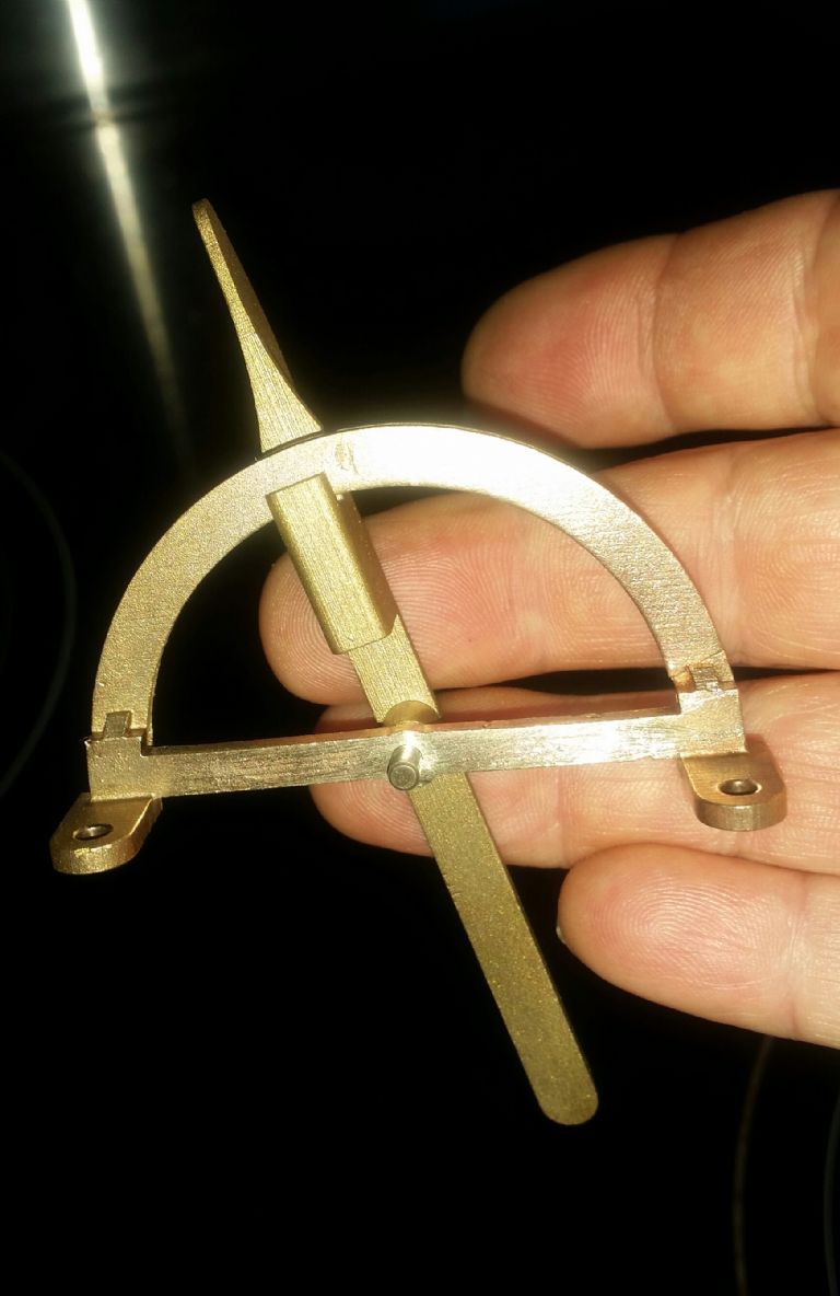

                  Well the 3mm ground steel arrived this week and I have made the pivot shaft and end nuts. These have wavy washers under them to provide a bit more friction than the friction pins in the levers alone can provide. I have cross drilled the nuts 1.4mm today to fit M1.4 setscrews to prevent them from undoing.
                  First image shows the assembly before cross drilling on a print of the full size parts, second one is the almost finished job. It just needs the link to the throttle control potentiometer finalising and then the lever drilling and pruning to suit.
                  Model throttle on picture of real one
                  Throttle almost finished
