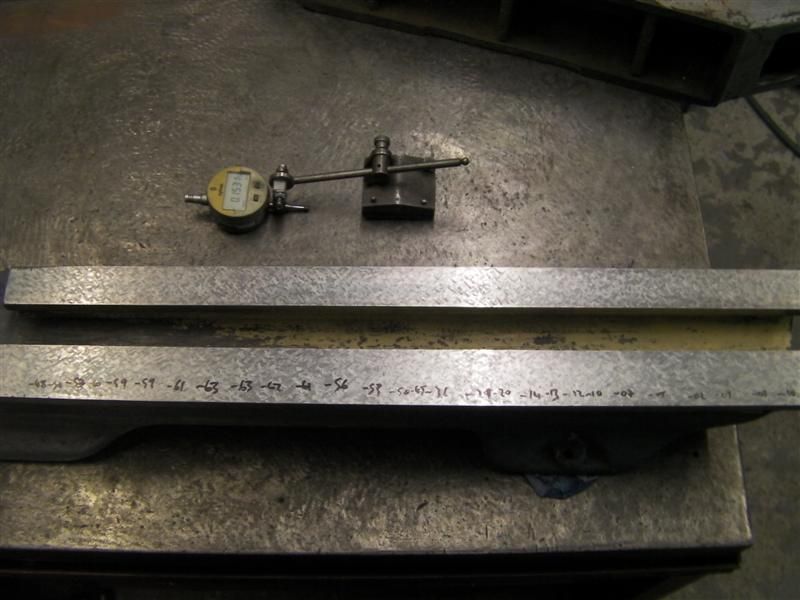

                          Do you have an idea (perhaps from measurements with straight edges and feelers etc) how much wear is on the bed you have? Peter, how much wear was on your S7 bed scraping exercise before you started?

                              Phil, see the image below. wear is marked in ten-thousandths of an inch.
