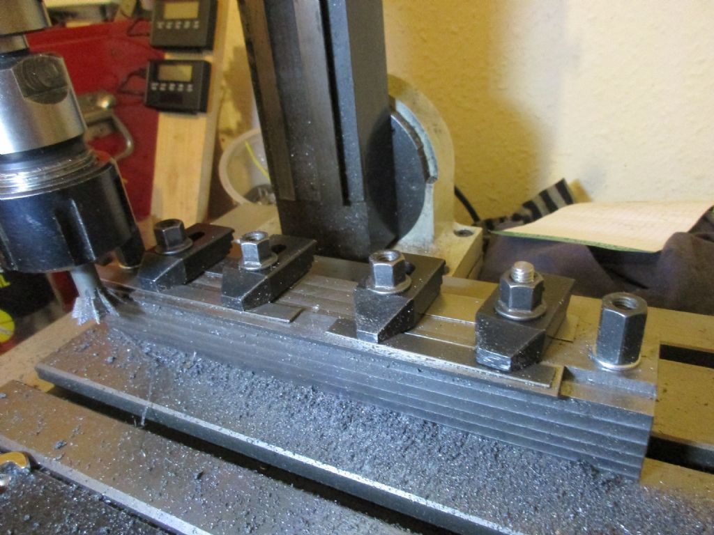

      I recently made a couple of gibs for a friends lathe and I made a block with a step on one edge, clamped it down on my mini mill and trued up the step. I then clamped a stripe of gauge plate on it and milled one bevel with a dovetail cutter and then flipped it over and milled the other bevel. Took a little while to do each one as I couldn't do very heavy cuts, but the bevels came out without any detectable error, using my M&W precision Vernier bevel protractor.
      Regards Nick.

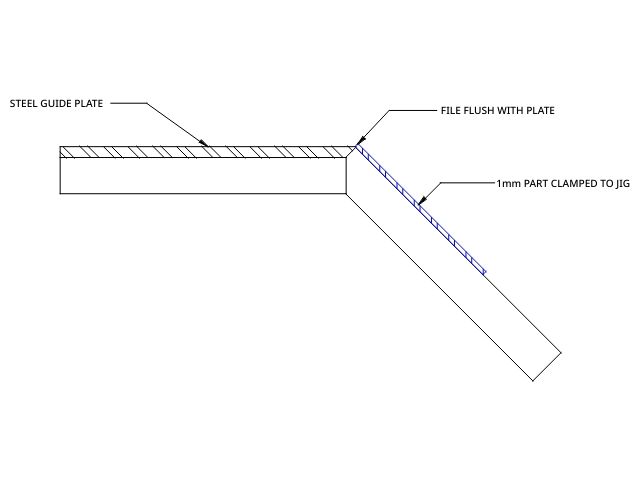

        1 mm is very thin. Even if your 45 degree angle is absolutely perfect, you're going to have problems ensuring that the parts remain flat enough to obtain a <0.1mm gap all the way along the edge.
        Given lack of space, equipment, etc., I'd make a simple jig out of MDF, flat-topped, with a piece of steel plate screwed to it, and an angled support at 315 degrees to it to clamp the part to. Use appropriate fences and dowels (through previously drilled holes in the part, as per your drawing) to register the part so that the edge to be chamfered is just above the steel plate.
        Then file the chamfer level with the plate. You can let the file contact the plate to guide it. It will last long enough for the purpose.
        Add fences, stiffening webs, etc. Draw filing is probably the way to go.

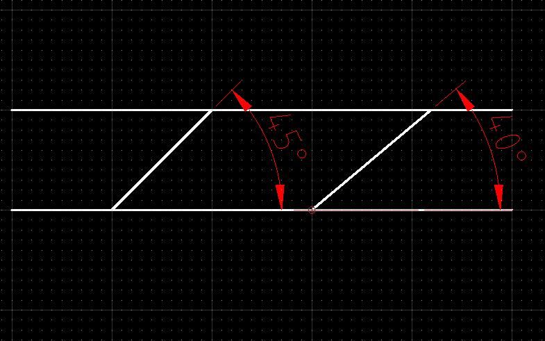

        #535644
          Few thoughts, first, the more information about the requirement the better. Engineers are tortured by customers wanting to implement their solution, however impractical, rather than allowing the expert to suggest better ways of doing it. Secret specifications are particularly evil, because it's so easy to make simple jobs difficult by accident. Putting it another way, be careful what you ask for!
          In John's specification, it may be there's no need to put a difficult to make accurate 45° chamfer on the strip. If John's requirement is for two parts to butt together accurately, it's only necessary for them to be chamfered at the same angle which is much easier to do.
          In the drawing below, both 45° and 40° chamfers butt equally well.

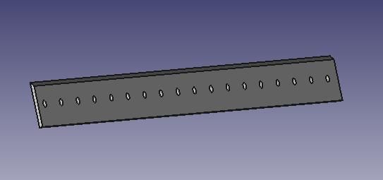

          My approach, ideally with a milling machine, and I think a Proxxon or Sherline would do, would be to mount a long strip of metal flat and drill a sequence of hole pairs spaced 20mm along the strip, widely spaced to allow crude sawing. Then I'd mount the strip in a jig at about 45° and run an end mill along the top tilted edge, thus producing a strip long enough to make several pairs all with the same chamfer, and therefore able to mate accurately.
          The parts can be separated with a hacksaw and then tidied to size by milling or filing. In both cases I'd make another jig to hold several pairs together in a stack by bolting them through the holes, thus letting me square the side edges to the required dimensions in groups, not one at a time.
          The limitation of the approach is pairs have to come from the same strip unless an angle jig is made to guarantee a repeatable chamfer. If 45° really is essential, same basic approach except much more effort goes into making an accurate jig.
          Although a milling machine considerably simplifies the job, it could all be done by hand, creating the chamfer by carefully filing down to the edge of the jig, and centre popping the holes. Hand would be cheaper, but don't underestimate the amount of practice needed to do the job accurately. I'm too clumsy and impatient to do good work with hand tools!
          Edited By SillyOldDuffer on 23/03/2021 20:13:19
          #535647
            Posted by SillyOldDuffer on 23/03/2021 20:11:09:
            Dave, you need to read what little spec we do have, John wants the parts to meet at 90deg not butt together, you won't get that with two 40deg chamfers.
            This is where Martin's suggestion of cutting in pairs has some merit as they will meet at 90 and will compensate for any inaccuracy in the tilt of the Multitool.
            #535648
              Posted by JasonB on 23/03/2021 20:21:57:
              Doh! I think I'll have a glass of wine in front of the telly, something mindless is bound to be on. Armchair engineering is so much safer…

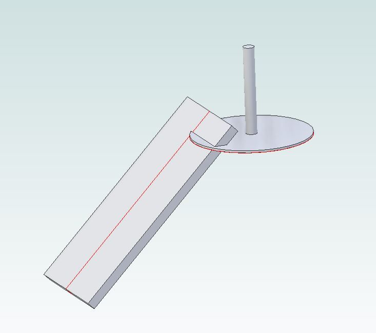

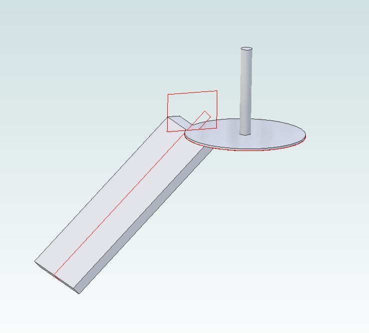

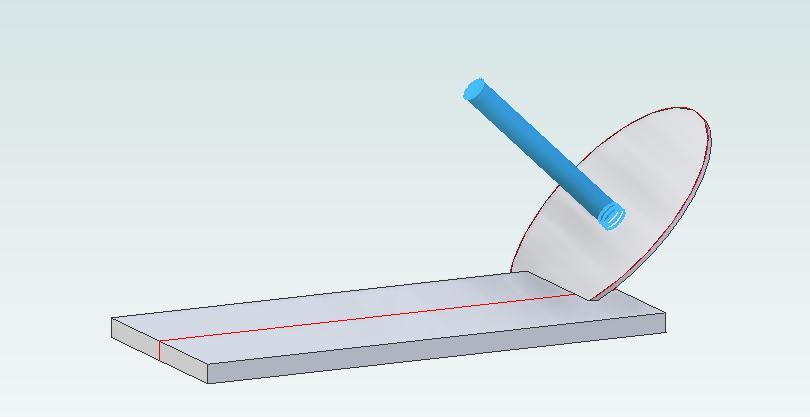

                            First you cut with a disc either with the work angled and tool vertical or you keep work flat and angle the tool using just part of the disc much like a circular saw cuts wood
                            You then change to a diamond coated disc and feed the work across the blade so the diamons just takes the last 0.1mm off.
