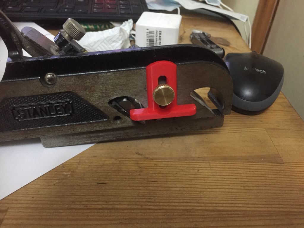

                        The 78's are notorious for being absent depth stops and fences are often broken which is why I snap them up whenever possible.
                        I am in the process of 3D printing a batch of 78 depth stops as we speak! I have been doing the fences for the 71 & 071 Router planes and they sell like hot cakes as the original items make outrageous amounts of money.
                        They are perfectly good for users even if "collectors" send me hate mail! (TRUE!)

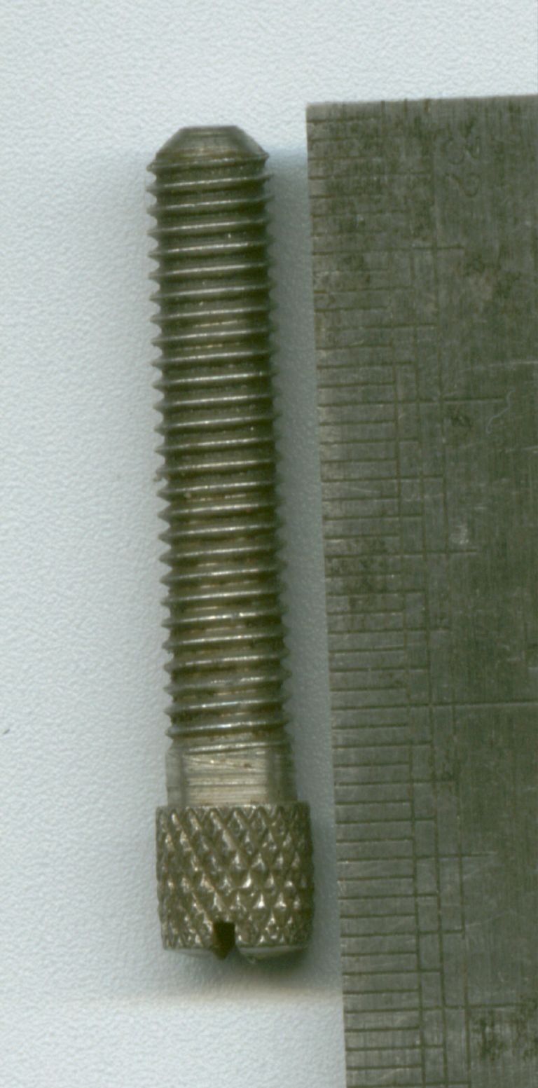

                                        My Stanley 50 plane lacked an adjusting thumbscrew, and I was able to borrow an example and make a replacement.
                                        The thread is a standard #12 x 28 NF. I bought taps and a die from ebay for a modest sum, and still have them. If that is the thread you need I'm happy to negotiate a loan. Send me a PM if you're interested.

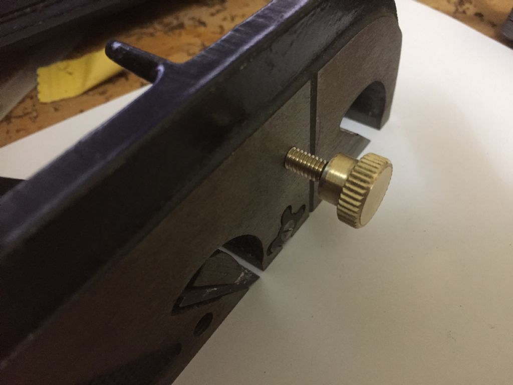

                                          Thanks for replies – JasonB is right, as Martin confirms. I had measured 4.74 mm and assumed that was 3/16" – I was unaware of the existence of the UNS standard so was looking at UNC/UNF/Whit possibilities.
                                          Although Tracy list 3/16" x 28 dies they are out of stock, and anyway £24 is a bit steep for a die which I will probably never use again. Other offerings for dies are the same sort of price. The plane cost me £15. I'll single point it.
                                          Keith – nice idea, but the spare screw on the front of mine (Stanley, made in England) is 3/16 x 24tpi.
                                          Martin – I'm very much a 'user' rather than a collector – it's a bit depressing to hear that you have suffered abuse just for restoring a function of an old tool. Nowt rummer than folk I suppose. If you have any printed stops not spoken for I might be interested. Machining the body of the stop is straightforward, but getting the V which holds the face of the stop parallel to the sole of the plane right might be more challenging.

                                                Thanks for the alert Rob, but I already have the fence complete with rod and screw. If I had needed the rod I would have made it – it's a fairly simple piece, just a 3" length of 9/32" with a 1/4" x 28 (presumably UNF) thread on one end and a cross drilled hole near the other. It's interesting though – at first I thought £10 for such a simple piece was a bit steep, but I suppose it would take me 20 mins per piece on a manual lathe even if I had everything set up. So not such a crazy price.
                                                Martin has very kindly offered me a sample of his 3-D printed stop for evaluation. In the meantime I single-pointed a #10 x 28 brass screw:
                                                It fits perfectly.
                                                Thanks to all for your help with this.

                                                  I am now the proud owner of a depth stop in Ferrari? red:
                                                  I'm impressed by the accuracy of the part – I didn't realise that 3-D printing could do that.
