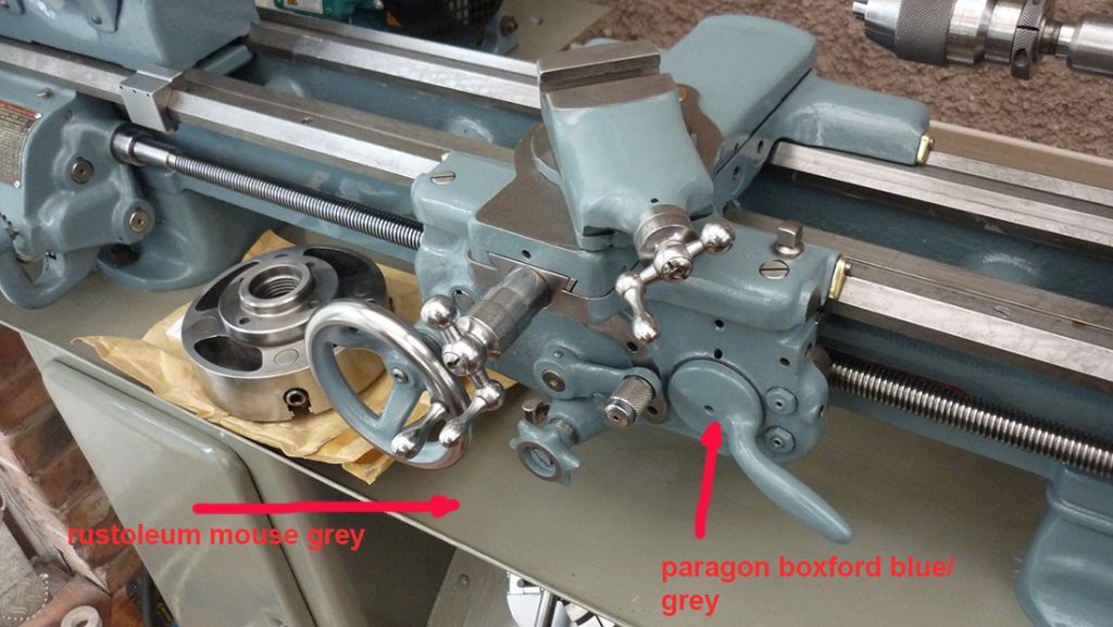

                  Update as promised
                  The southbend is now home and I am pleased to report it is better than anticipated. The rust shownn in the sales pics turned out to be a mix of old oil,dust and sawdust. 14 additional change gears were located,3 chucks,one 4 jaw independent, a drill chuck and drills. Thread form tool,tool steel,tool holders and cutters.
                  It is currently painted white but seems to have been green initially. Any idea what is a close shade of paint?
                  The motor is quiet but it needs a new drive belt as it is perished and broke at the stitch when I ttied to separate it. All in all a good buy,150 well spent,I even picked up a nice 3a vice for an extra 20.
                  Happpy bunny. Just have to strip,clean and refurb cosmetically now.

                    Posted by john evans 13 on 29/01/2017 18:41:15:
                    That's why I like painting my machines black, you can't really get it wrong.

                        No I do not want black but I understand your viewpoint. I would like to keep the colour close to original..not that I have with my 1924 royal enfield. My 1963 norton is green but darker than that on the lathe.

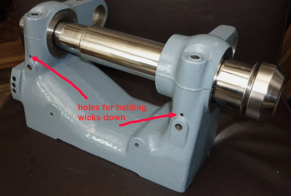

                        Are there any things to watch out for on the stripdown. I hear tge spring loaded wicks can be an issue?

                            According to Tony on Lathes UK, they were a greenish grey, not always the same shade. He suggests a good start would be Benjamin Moore Urethane Alkyd Industrial Enamel, formula: M22-3B, OY-15, BK-27, MA- 1 1/2 per quart.

                              The spring loaded wicks are not usually a problem when taking apart but sometimes a touch fiddly when putting the spindle back. There is usually two small holes in the front of the headstock casting (but not always ) ,which allows you to poke in something like a small allen key to hold the wicks down whilst replacing the spindle. Most of the tear down is common sense apart from the left hand clutch screw (which i dont think you have ).
                              Most people replace the thrust washer at the back of the headstock spindle with narrow needle bearings which cost around £7 and almost eliminates spindle end float.

                                  it is probably Sept 1941 (is that 40 part of the model number?), is that model 413 or 415? My earlier one is 122171 which appears to be end of 1942.
                                  They seem to have been in various shades of grey ,but you could get any colour you wanted if you paid a small surcharge.

                                    Interesting to hear they were grey. I suppose it could have been thoroughly cleaned up and repainted in the past..maybe more than once? One tends to assume paint found on inner faces of castings to be original,if so,green was the colour:if not…?
                                    Anyway it is progressing slowly.tailstock and all guards are off. Info plates refurbed and quite a bit of paint scraped off by hand. I am off to the shops tomorrow to chose a colour then buy 500ml which I expect will suffice.
                                    I favour rustolium which I use on outdoor metal posts with success but it depends if they have a suitable colour. I like originality but do not want to go to extremes as it is only cosmetic.

                                      I painted mine in boxford blue/grey which looks ok in person but very blue in photos for some reason. The original colour on mine was a sort of grey with a greenish bluish tint , and somewhat similar to Rustoleum Mouse grey. If i was doing one again which is very unlikely i would prefer the grey to the blue/grey boxford colour from Paragon paints.
