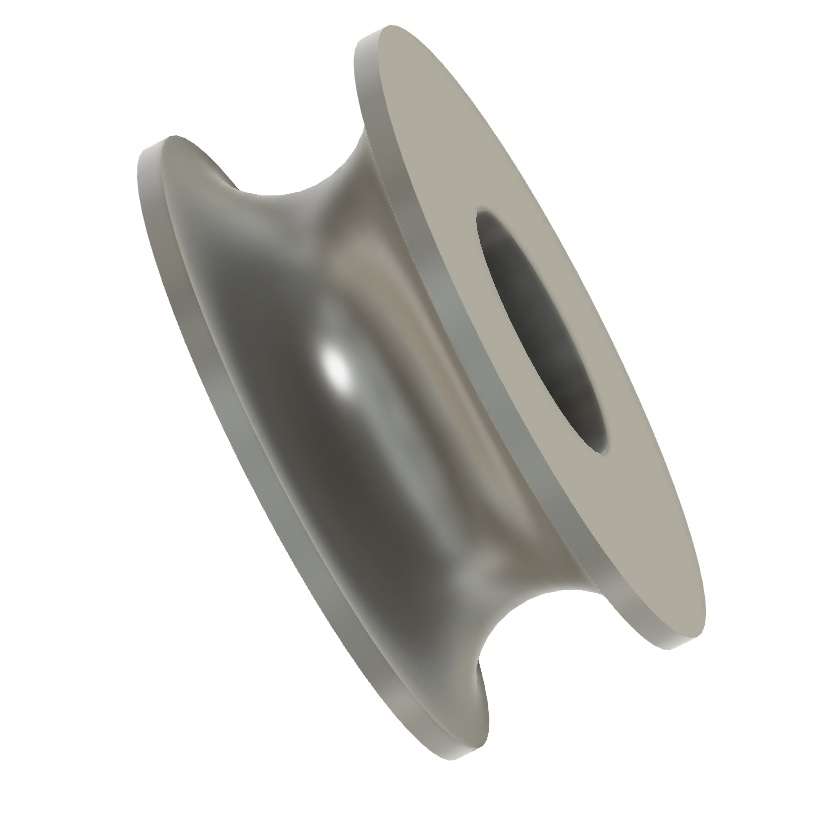

      Hi,
      I’m looking for some advice on tooling. I want to cut a 16mm diameter groove around an aluminium part, a simple pulley style disc. At the moment I’ve been using a ball end mill with the part mounted on a rotary table on my milling machine. This kinda works but is slow, difficult to set up and the finish isn’t great.
      It seems like I really should be doing this on my lathe but I’m not sure of the best tool for the job. I think I should be able to use a circular insert on an indexable tool. I think an RCMT16 is what I need and although I’ve found inserts for this I’m not sure what holder will work with this insert. I’m a little bogged down with the charts showing compatibility. My tool holder has a 12mm capacity.
      Can anyone help on this and point to an example of a tool holder that would work with an insert I’ve described?
      Many thanks.

            Steven Shand
              @stevenshand77617
              but why the need for such accuracy ?
              They are support wheels for a roller bender. It’s very thinwall tubing that’s being bent and if the tube isn’t really well supported then you end up with slight deformations in the tube. Sounds like it could be quite a rough fit but it really can’t unfortunately.

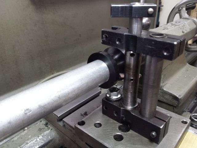

                        Ian P
                          @ianp
                          I made several black Delrin rollers with semicircular grooves for a sliding door to run on 25mm diameter SS tube for a ‘designer’ kitchen.
                          I used parts out of my scrapbox, the two black horizontal bars are clamped to the tubular spacer and the lower bar is fastened to the lathe cross slide with the single hex bolt. The HSS cutter bit is mounted in a cross drilled hole in a bar free to rotate (hand turned with the lever at the top)
                          If I was doing the same thing again I would probably use a small boring head mounted on a spindle running in a journal fitted to the toolpost. Big advantage of a boring head is accurate radius setting.
                          Ian P

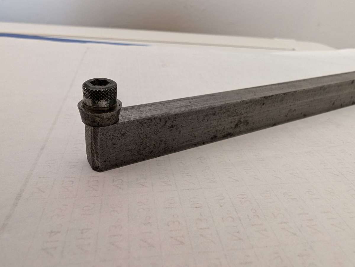

                          Clive Brown 1
                            @clivebrown1
                            I’ve made aluminium pulley sheaves using a silver steel form tool. Turn the disc with, say, a 12 – 14 deg. inc. taper for front clearance. Hardening & temper might not be needed for a one-off. Cheap as chips.
                            PXL_20241122_133555456
                            #766131
                            Steven Shand
                              @stevenshand77617
                              That looks perfect actually. I’m not sure why I didn’t think of that. Thanks.

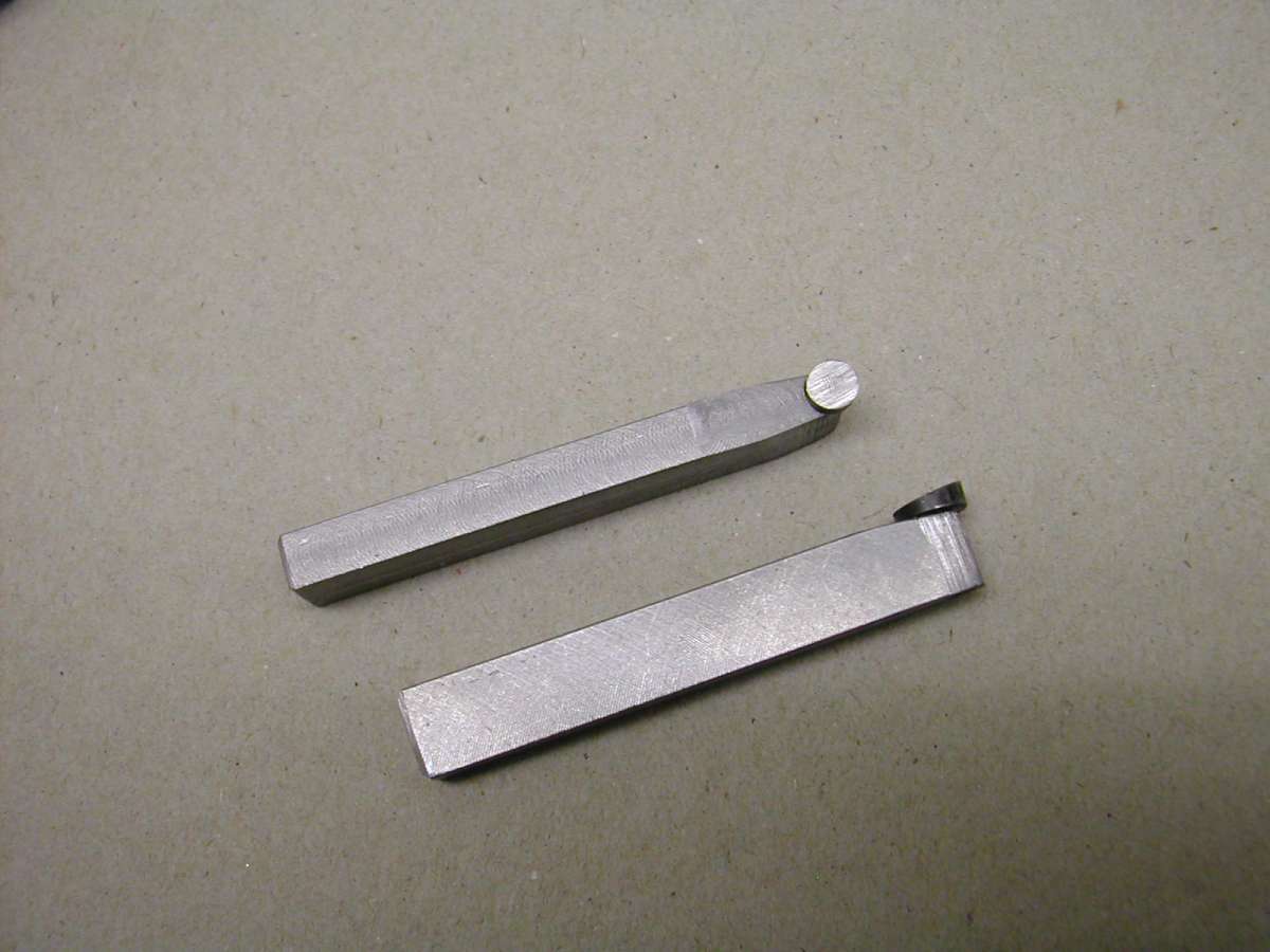

                                Ramon Wilson
                                  @ramonwilson3
                                  This very topical!
                                  Only last night I did exactly the same for the same reason only mine was 9.5 dia (3/8″ actually). The shape was formed by grinding the radius on a piece of 3/8 sq HSS freehand on the bench grinder and plunging straight in. No issues were found in cutting and the form produced is certainly good enough to form the copper pipe around.
                                  Personally for 16mm I would make a circular cutter from silver steel and mount it to a piece of bar – certainly accurate  and sturdy enough for a one off – I made those in the pic for turning gear cutter blanks – the cutter has a spigot that is juts loctited innto the holder and have done others where the cutter is held on by a central screw much like any insert tooling
                                  hope that’s of use
