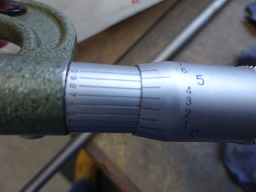

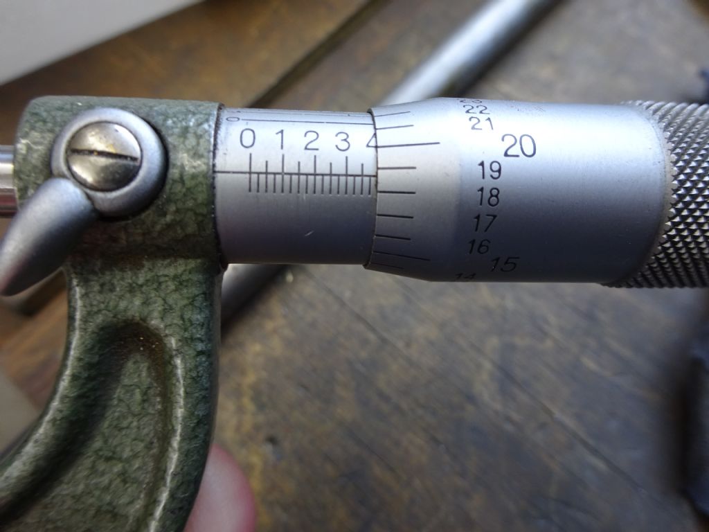

                                        #360522
                                        mechman48
                                          @mechman48
                                          Jason; is your mic a 'Shardlow' . I have a dual scale one that I bought when I was apprentice back in 1963- 55 yrs ago now, & still have it, in decent nick too.
                                          George.

                                              mechman48
                                                @mechman48
                                                A​ couple of pics of aforesaid mic'…
                                                I guess this is same model as yours …
                                                George.
