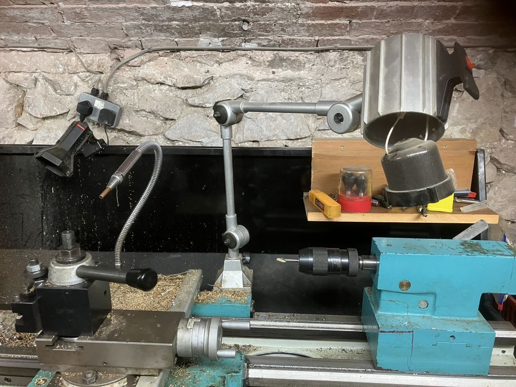

      I'm looking to replace the 24V AC 50W halogen capsule lamp on my lathe:
      It's a horrible lamp. Hard to position, not very bright and the mount attached to the saddle can get in the way for some operations.
      Lots of possibilities I know, but there might be an advantage in using the existing 24V AC supply. Something I'm thinking about is using a 27W Sealey LED array . This works from a 12-36V DC supply, so I'd need a rectifier. A couple of questions:
      Q1. I have diodes suitable to make a full wave bridge rectifier myself but don't know how to calculate the appropriate value for smoothing capacitance. Any advice?
      Q2. Is it nuts to contemplate making something myself? Perhaps there is some off-the-shelf unit which would do what I want? I've looked but so far failed to find, perhaps because I don't know the right search terms.
      Comments along  'if I were going there I wouldn't start from here' lines also welcome of course!
      Robin.

              duncan webster 1
                @duncanwebster1
                To answer your initial query, I don't think you need a smoothing capacitor, just run it off the rectifier

                              To answer the question :
                              For your Sealy 27W lamp the current draw will be over 1A so you need a 1.5A or greater bridge rectifier. I'd suggest a 2 or 3A item. If using individual diodes to make a bridge then you can use 4 x 1A diodes like 1N400x series. This is because each diode is only carrying current 1/2 the time.
                              For capacitor you only need a minimal amount for simple electronics a rule of thumb is1000uF per amp of load. So for your lamp 470uF is adequate. Voltage rating needs to be at least 35V. Even 100uF would probably be enough to stop strobing at 100Hz.
                              Hope this helps.

                                I have just used a variable speed battery hand drill held under one of the down-lighters I referred to above:
                                There is some strobing detectable at certain speeds, but it is quite mild. I don't think it would be enough to "freeze" a piece that was mounted in a lathe chuck, making it appear stationary, but just to warn you.

                                  Posted by John Doe 2 on 19/08/2023 10:16:44:
                                  Without smoothing, your LED light will switch off every half cycle, so it will flicker, perhaps not noticably, but might cause dangerous strobing effects.
                                  Just a guess because the description of Robin's Sealey lamp doesn't say so, but it claims to operate from a 10V to 30V DC supply. The input voltage range implies the lamp contains a some sort of electronics, perhaps a constant current power supply, in which case it may not need any smoothing at all.
                                  My main concern with powering it from 24VAC and a rectifier is that the peak DC output is nearly 34V, which might result in the lamp having a short life. (The blurb says 10V to 30V, not 10V to 36V)
                                  Unfortunately the spec doesn't say how much current the lamp draws. However, 27Watts is probably the light equivalent, not the actual power consumption. As LEDs are abut 10x more efficient than Halogen, I guess the lamp consumes 2 or 3 watts, say 100mA, not enough load to stop a beefy 24VAC supply rated to run a halogen lamp charging a big capacitor up to 34V.
                                  The lamp costs £18.60. I'd either:
                                  • Be a cowardly lion and run the lamp from a 12V supply, or,
                                  • Assuming 100mA is about right and, add a 56 or 63ohm 2W dropper resistor. This would take peak volts down below 30V
                                  • Try the lamp on 24vac (or via the dropper). with no capacitor. If it works without flickering, down tools. If not, try adding a capacitor, something between 470uF and 2200uF. Having an oscilloscope means I could measure the ripple voltage and calculate the correct value, but I suspect it's not necessary. Suck it and see.
                                  How long a slightly over-volted LED lamp will last is anyone's guess: I suspect it will be OK. As the lamp is moderately expensive, I'd fit a dropper resistor.
                                  This stuff is much easier if you have a mutlimeter and oscilloscope because a few simple measurements remove most of the guess work.

                                            Thanks Robert, that's exactly what I was hoping for – a 'rule of thumb'. I have the diodes and some 1000uF 50V capacitors in my 'bits box' so I can lash something up and see how it performs.
                                            John Doe 2 – I came across the formula you quoted (or something very similar), plugged in some numbers (guesswork) and came out with 450,000 uF. Obviously ridiculous, but not being sure which piece of 'garbage in' led to this 'garbage out' I gave up and posted.
                                            SoD – yes, 10-30V not 36V. Not sure what happened there! Thank you for your suggestion of using a resistor to drop the peak voltage. I think I have a box of 5W resistors somewhere. I have an oscilloscope so now I have a reasonable value for the smoothing capacitor I can build a simple circuit and see what happens.
                                            Alan Johnson 7 – it's a transformer. Until I started investigating this I hadn't realised that there is 240/24V transformer which is always energised when the lathe is switched on at the mains plug. It seems to run all the switchgear (interlocks etc) as well as the light. It takes only a few Watts when quiescent so has probably only eaten about £50 over the 5+ years the lathe has been left on at the wall 24/7.
                                            Maybe it's simpler to junk the 24V lamp and go for something mains powered but I wanted to explore possibilities and learn something along the way.
