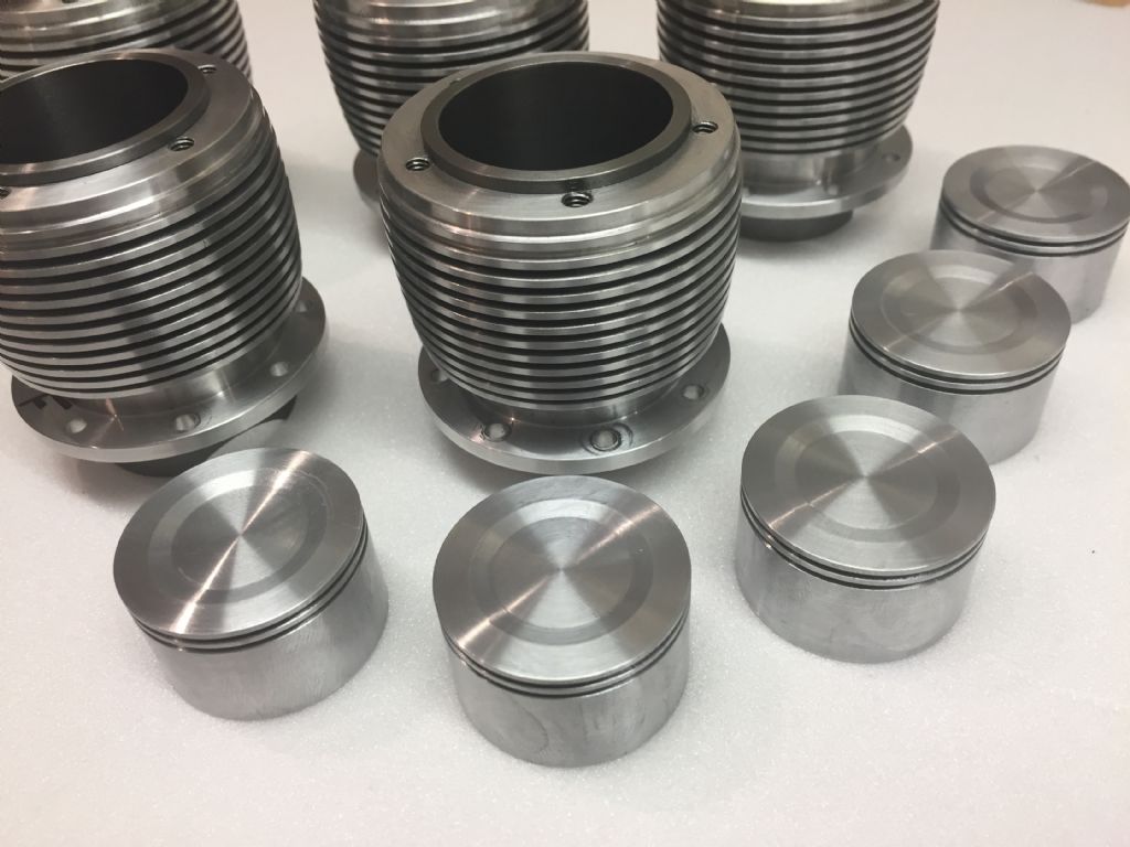

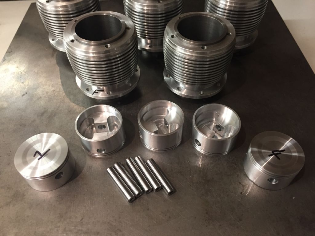

          Set2Cylinders and LinersOriginal Engine
          #330194
          Michael Checkley
            @michaelcheckley34085
            Liners are cast iron and aluminium parts are a mixture of 7075 and 6082. The plan so far is to use EN24T for the crankshaft which will be a little more substantial than the original to take a bit more abuse.
            I have used a few plans and books as reference but found that very few include a tolerance for critical dimensions, I guess most are made as a one off to fit the mating part. For this project I have chosen to go for a tolerance on all the critical features to enable me to make each part individually much like a more commercial/industrial item. So far so good and the fit of the parts is good, perhaps a little more in the scrap bin though!
            Next job is to finish off the pistons and make some gudgeon pins.

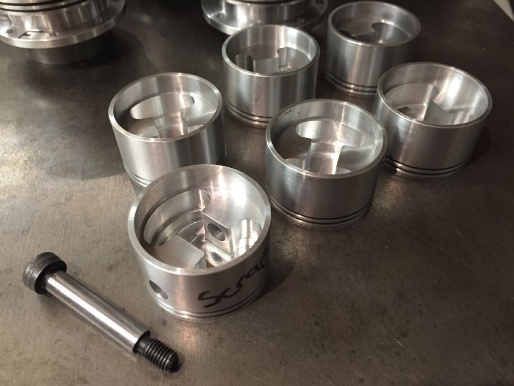

                  Yesterday I wrote the program to mill the the inside of the pistons and following a few iterations committed to the actual 5 pistons which resulted in a few more iterations to the program. It seems that even after 3 practice runs there was still a lot to learn!
                  Today I drilled and reamed one of the test pistons for the shoulder bolt soon to be gudgeon pin. The original plan was to use a dowel pin for the gudgeon pin but I wanted to hollow it out and didn’t think this would work out well. The 12.9 shoulder bolt fits well enough.

                      This looks like it will be an interesting build: I am looking forward to your progress. Your use of 12.9 shoulder bolts for the gudgeon pins is interesting. I was going to use silver steel for the engine that I am making but a quick Google showed that I can buy suitable 12.9 bolts off the shelf, which will be far superior.

                        I’m not sure how well the shoulder bolts will do the job but worth a go. The original plan was to use rollers from roller bearings, readily available and quite cheap but only available solid and I want to keep the mass down on the moving bits!
                        Pistons have all been milled and drilled and the bolts cut down and hollowed out to make the pins. Rapidly running out of 5 off parts to make smiley

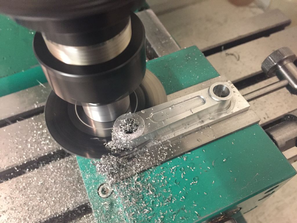

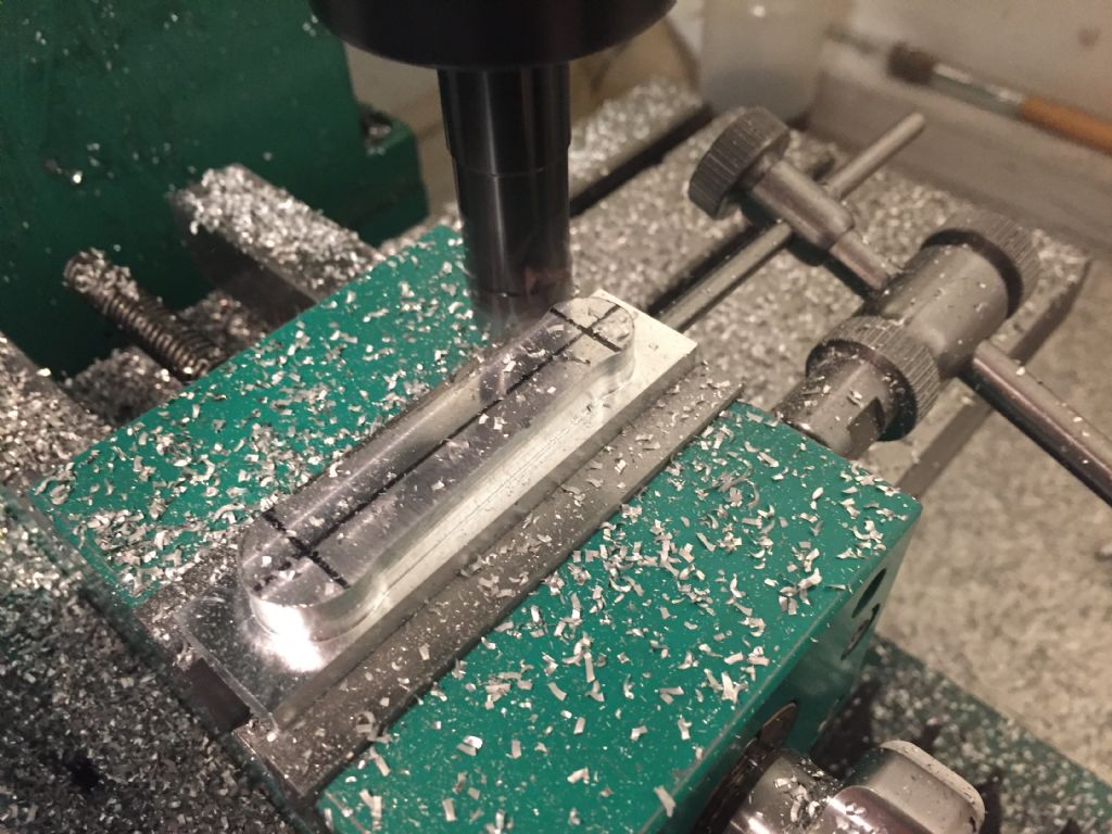

                              The new 16mm milling cutter from Greenwood tools made short work of roughing out the conrod, only trouble is I didn’t leave enough height to get the slitting saw in so it’s either start again with new blanks or make a low profile slitting saw arbor. I think the arbor may come in handy for future jobs…..

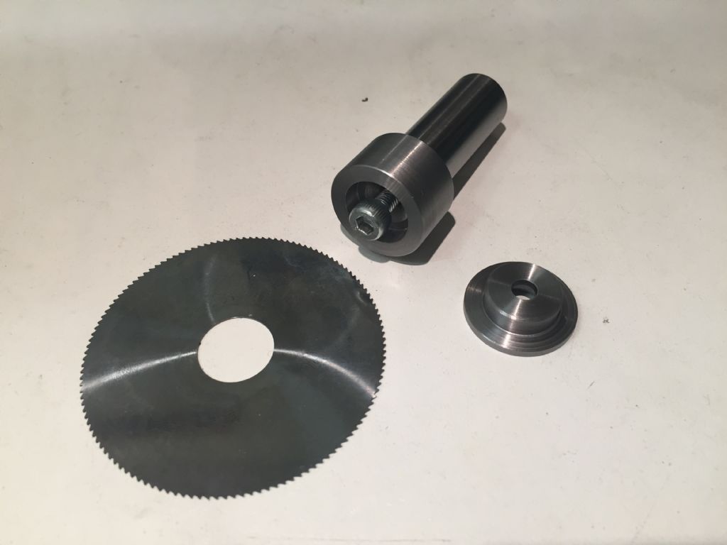

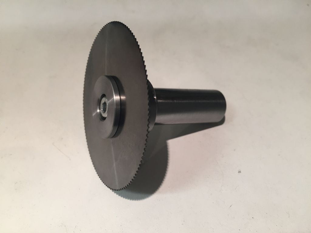

                                        Low profile slitting saw finished and ready to slice off the conrod from the blank.
                                        #334973
                                        Michael Checkley
                                          Slitting saw works ok. A fixture to machine the newly cut face is required next.

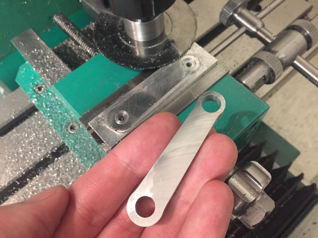

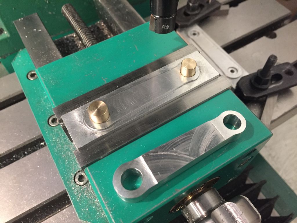

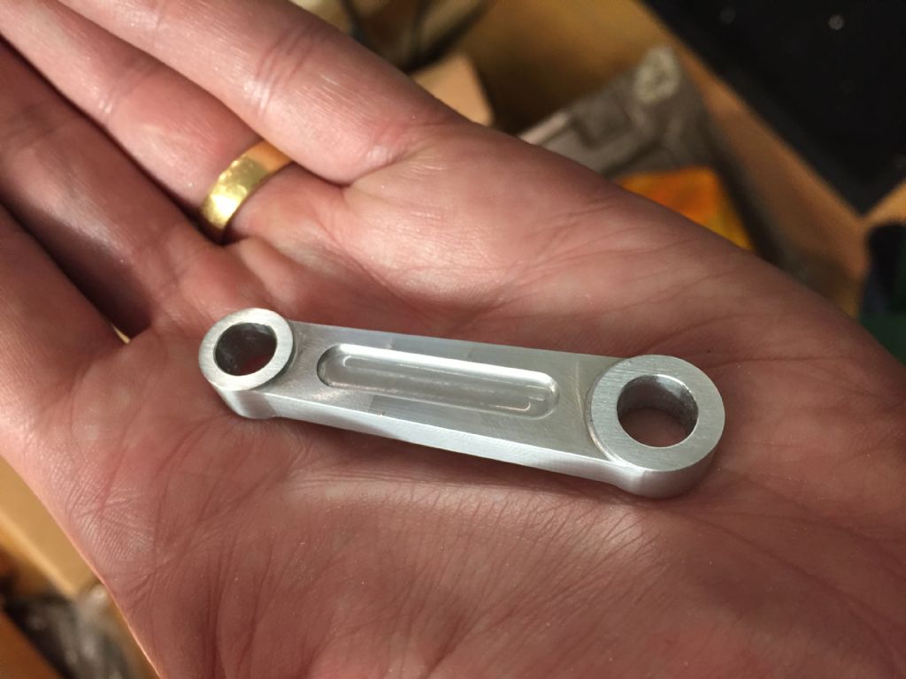

                                                  16 different programs and a good few tool changes later and the first slave rod is ready for bushes. Thankfully I need 4 which will make use of the progams and jigs.
