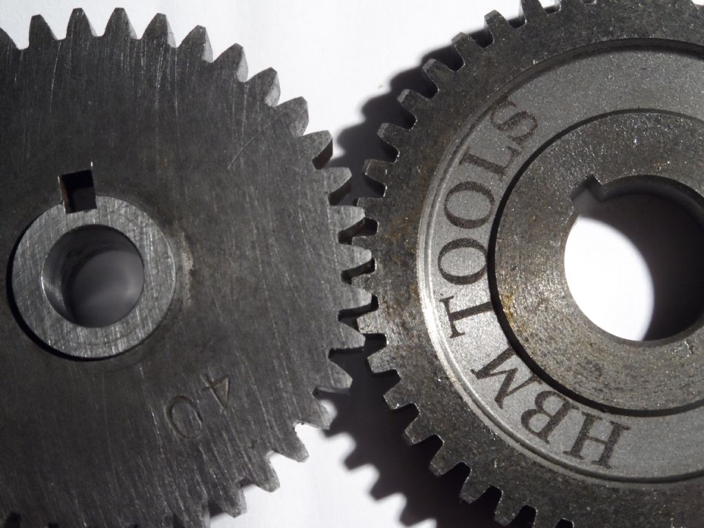

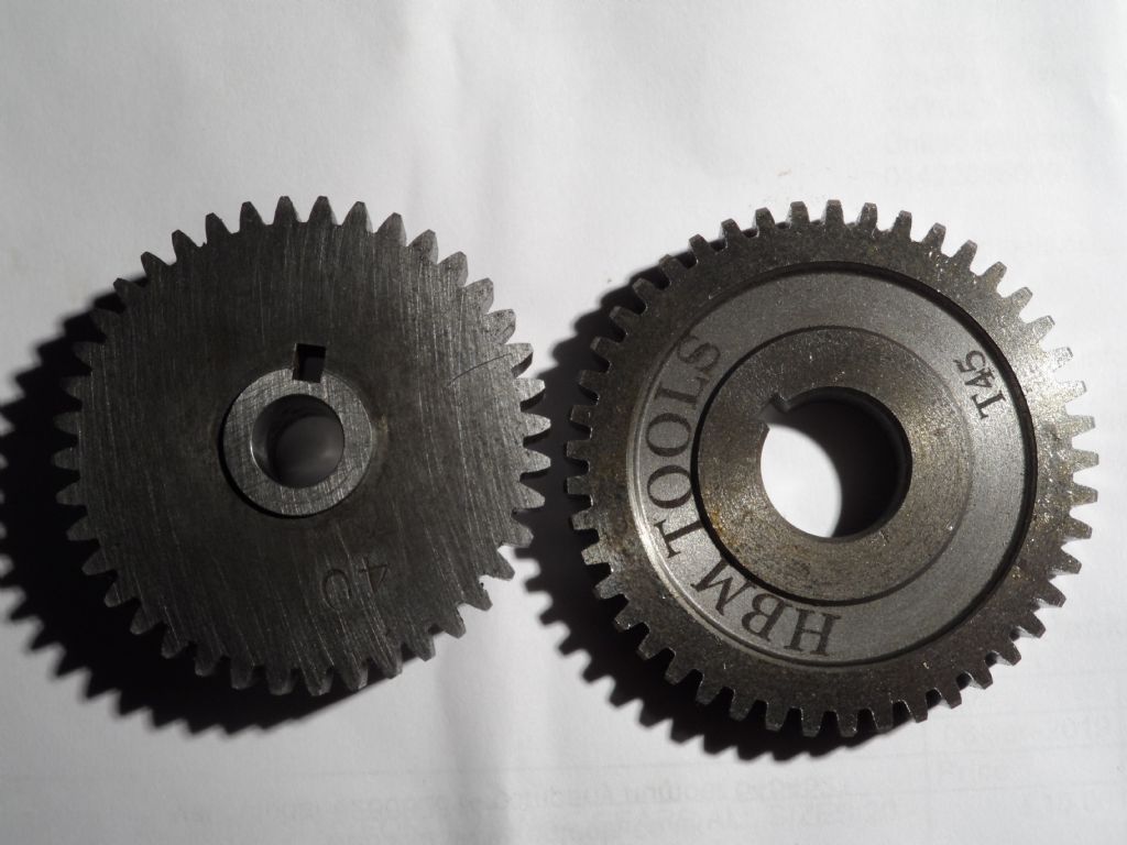

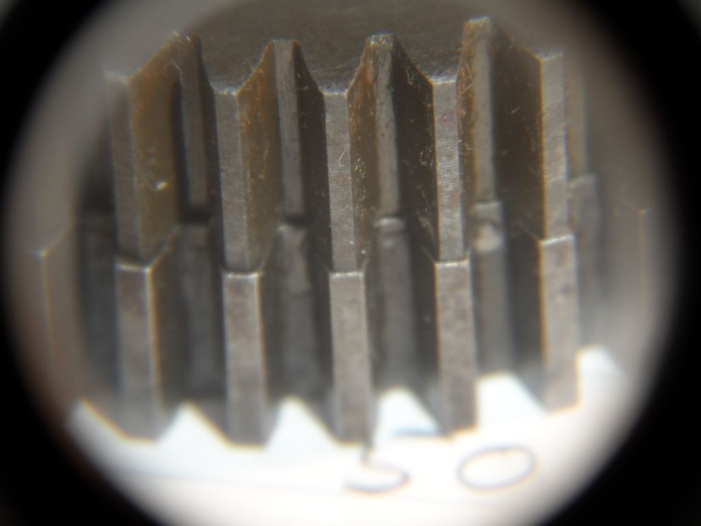

      sam_3317.jpgHey guys, Would like to hear your thoughts on this comparrison. We have here the 40 tooth Zyto gear on the left and a 45 tooth replacement for one of the gears I'm missing. The bore seems accurate and the thickness too. Both are a match. The keyway also is fine. However the tooth profile, sorry if that's not the correct term, differ somewhat. The new gear is slightly broader and thicker at the tip and has a slight chamfer. I'm ok with the chamfer as I know its to prevent teeth from chipping however while the new gear does have curvature on the tooth face its very slight and much more flat in comparrison to the Zyto gear. I fear the pressure point will be different and that will lead to premature wear on one or both gears. Advice on my best course of action is appreciated.
      Thanks

        #390762
          **LINK**
          http://www.homemetalshopclub.org/news/10/pressure_angle_anamation.html
          I suspect that one is 14.5° and t'other 20°
          I suggest you image them on a flat-bed scanner for a better representation than the camera gives.

          #390768
          Paul Kennedy
            @paulkennedy14200

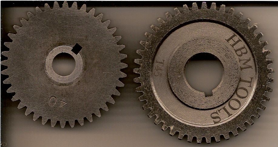

            Thanks for the advice Michael,
            The scan is sharper and the tooth profile is far clearer. Hope this helps.

            #390772
            not done it yet
              @notdoneityet
              The zyto is almost certainly 14 1/2 degree pressure angle.
              All HBM gears on their advertised lists are, I think, 20 degree pressure angle. How well they might mesh for a low power, slow speed application, I don’t know. Likely be noisy but do the job? A cutter, to make the proper gear would be about twenty quid.

                Posted by Paul Kennedy on 12/01/2019 18:57:07:
                It does indeed, and I'm happy with my original estimate.
                … I would not mix them.

                    #390811
                    Nicholas Farr
                      @nicholasfarr14254
                      Hi, Myford series 7 change wheels are 20 DP, 14.5 pressure angle **LINK**. I bought some years ago from the original Myford company for my late fathers RandA lathe, which is in the same band as Zyto etc. and they fit spot on to the original RandA wheels, just had to drill a little hole for the drive pin.
                      Regards Nick.

                      #390824
                      Paul Kennedy
                        @paulkennedy14200
                        Hi Nic, Thanks for the link but that looks suspiciously like an exact match to the HBM gear I'm returning. The Zyto Gear tooth are much more elongated and pointy in comparison.
                        #390826
                          Posted by Paul Kennedy on 13/01/2019 09:12:20:
                          dont know
                          It should not match the HBM gear, Paul … Unfortunately, the illustration is poor, but the description is clear.

                            #390861

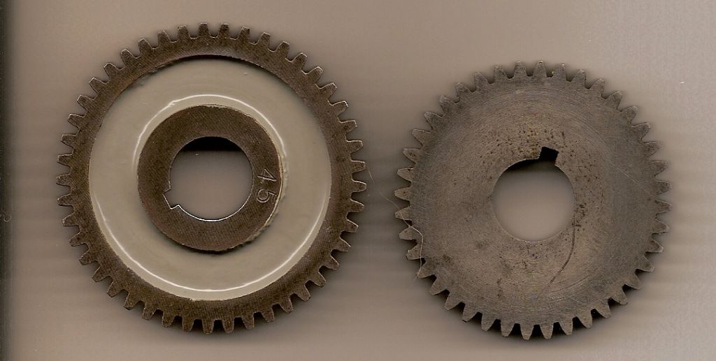

                            Paul Kennedy
                              @paulkennedy14200
                              UPDATE !!!
                              Hey guys the HBM was supposed to fit the Myford and I was worried that the Myford Gear also was similar albeit the photo was maybe not clear as Michael pointed out. So I went up to my garage and sought out an original Myford Gear from the ML7 and it appears to be the same pressure angle as the HBM and also the Myford photo that Nicholas kindly linked me to. The Zyto gear is different.
                              The Myford Gear is on the left. It appears obvious to me but the Zyto teeth seem longer and sharper. The base width of the teeth appear to be the same but the zyto tooth point narrows quicker than the Myford. Perhaps a pressure angle of 10 degrees ? There's very little in it and im fairly sure the myford gear would work but Im curious now how i can confirm my suspicions about the zyto tooth pressure angle ?
                              I've since put the gear teeth under x60 magnification and the tooth point on the Zyto gear is most definately narrower than that of the Myford. All other dimensions such as bore diameter, thickness and keyway depth and breadth appear the same.
                              Edited By Paul Kennedy on 13/01/2019 14:07:36
                              Edited By Paul Kennedy on 13/01/2019 14:17:49

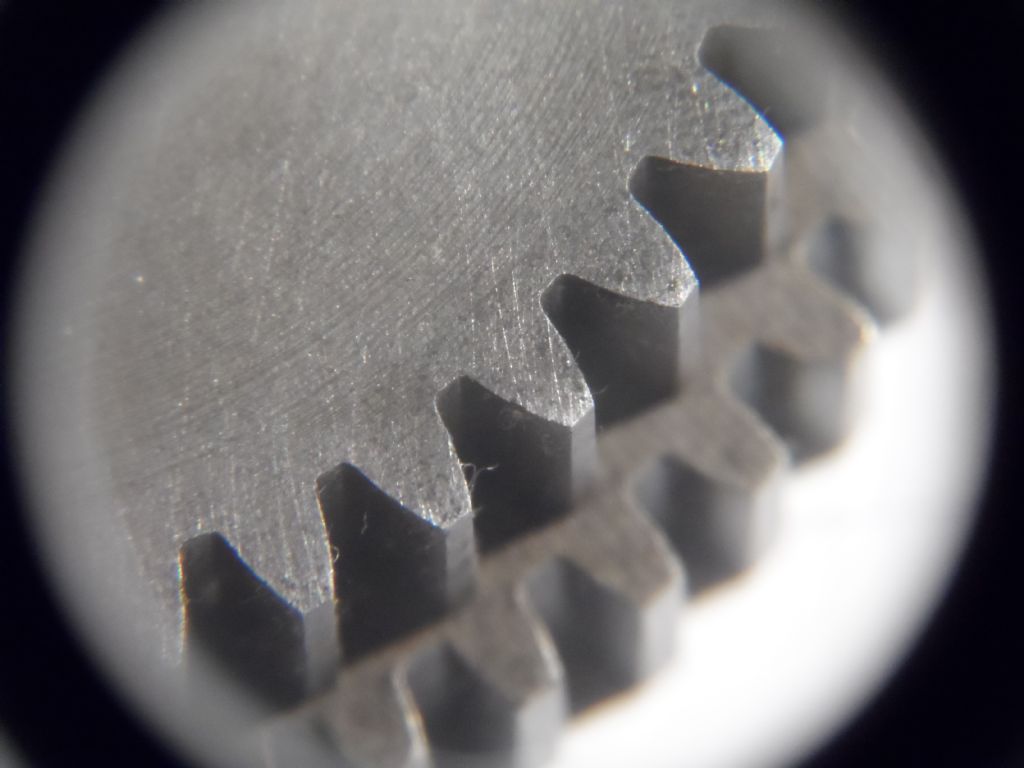

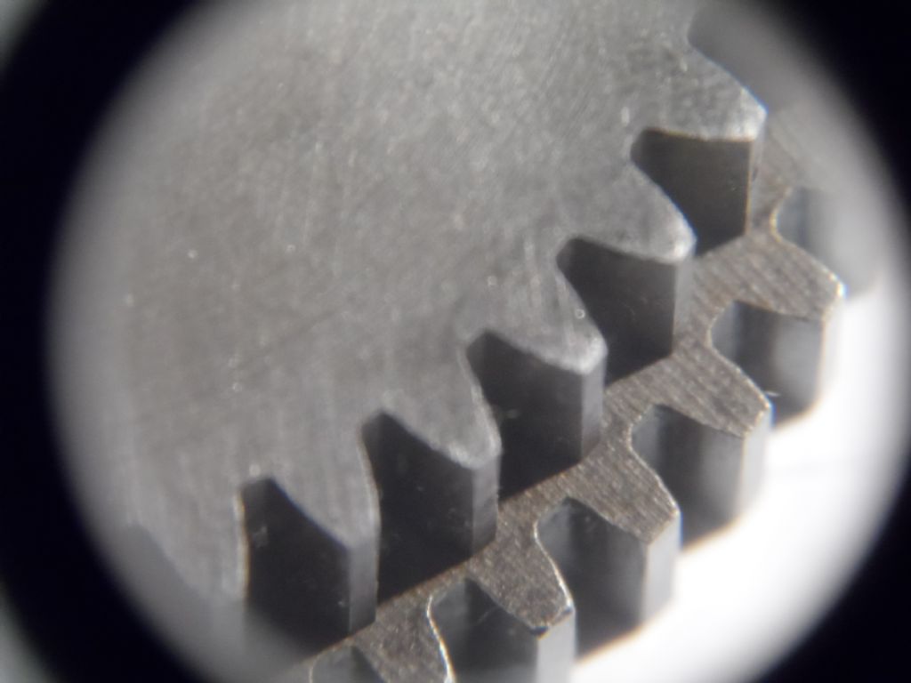

                                #390873
                                Paul Kennedy
                                  @paulkennedy14200
                                  Some x10 Photos.
                                  Myford gear is on the bottom.
                                  Edited By Paul Kennedy on 13/01/2019 15:53:59
                                  #390877
                                    I vaguely recall that some gears on a Myford are 20 degree and only the change gears 14.5 degree.
                                    Yes! I am not going insane (yet), however it seems all ML7 gears are 14.5:
                                    Posted by John Stevenson on 24/02/2012 22:40:23:
                                    Jim,
                                    I can't comment on the rack or it's mating pinion as I don't have any details on these but could get them if I wanted.
                                    However as regards the screw cuting gears they are all 14 1/2 degrees PA with the exception of the first 4 on the Super 7 and like family.
                                    The first 4 being spindle gear, the two tumblers and the gear the tumbler drives. These are 20 degrees PA.
                                    Outboard of this they are all 14.5 degrees.
                                    The ML7 are all 14.5 including back gear but the backgear on the S7's is special and requires a special hob as the tooth form is modified.
                                    John S.

                                        #390901
                                          Posted by Paul Kennedy on 13/01/2019 15:53:09:
                                          Some x10 Photos.
                                          [ etc. ]
                                          Very useful photos, Paul yes
                                          Something certainly doesn't look right …
                                          This may be worth a look: **LINK**
                                          https://khkgears.net/new/gear_knowledge/gear_technical_reference/involute_gear_profile.html
                                          #390902
                                          Paul Kennedy
                                            @paulkennedy14200
                                            Thanks Neil, I've not done the necessary calculations as yet but I'm leaning towards a 20 degree pressure angle looking on the website the tooth profile matches my teeth perfectly. I will fire up autocad at some point to confirm this however..

                                                #390939
                                                  Posted by Paul Kennedy on 13/01/2019 14:02:28:
                                                  I think Neil's link sorted that one out nicely; but I'm posting this image because it shows all the major features very neatly:
                                                  Picture credit : KHK Stock Gears : **LINK**
                                                  https://khkgears.net/new/gear_knowledge/abcs_of_gears-b/basic_gear_terminology_calculation.html
