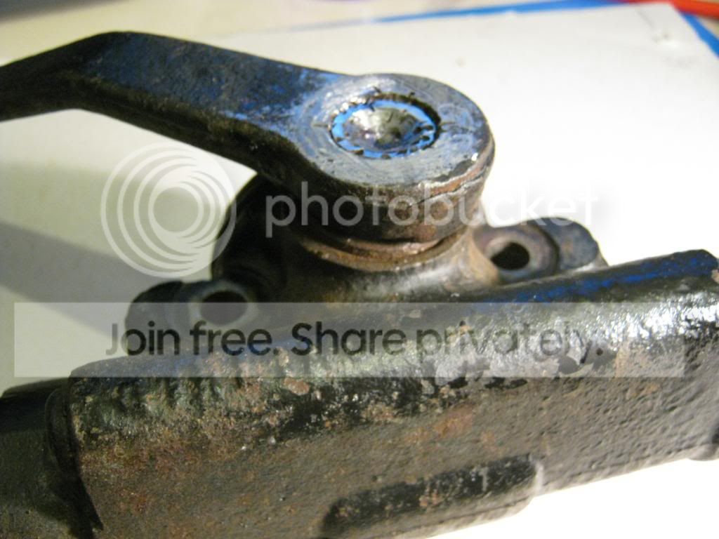

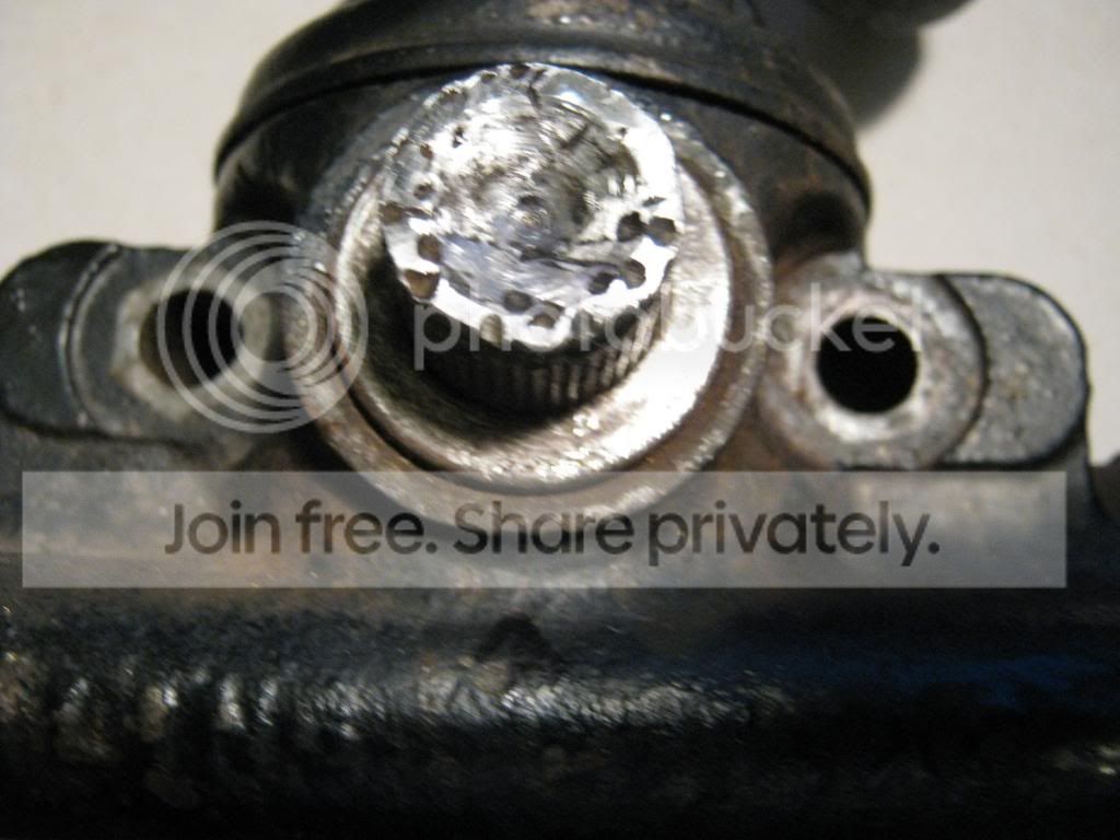

        I have a ’51 MG TD shock absorber that needs attention – the damper arm needs fixing back onto the splined shaft.
        Originally, the arm would have slid onto the splined shaft and then the end of the shaft would have been flared to fix the arm in place.

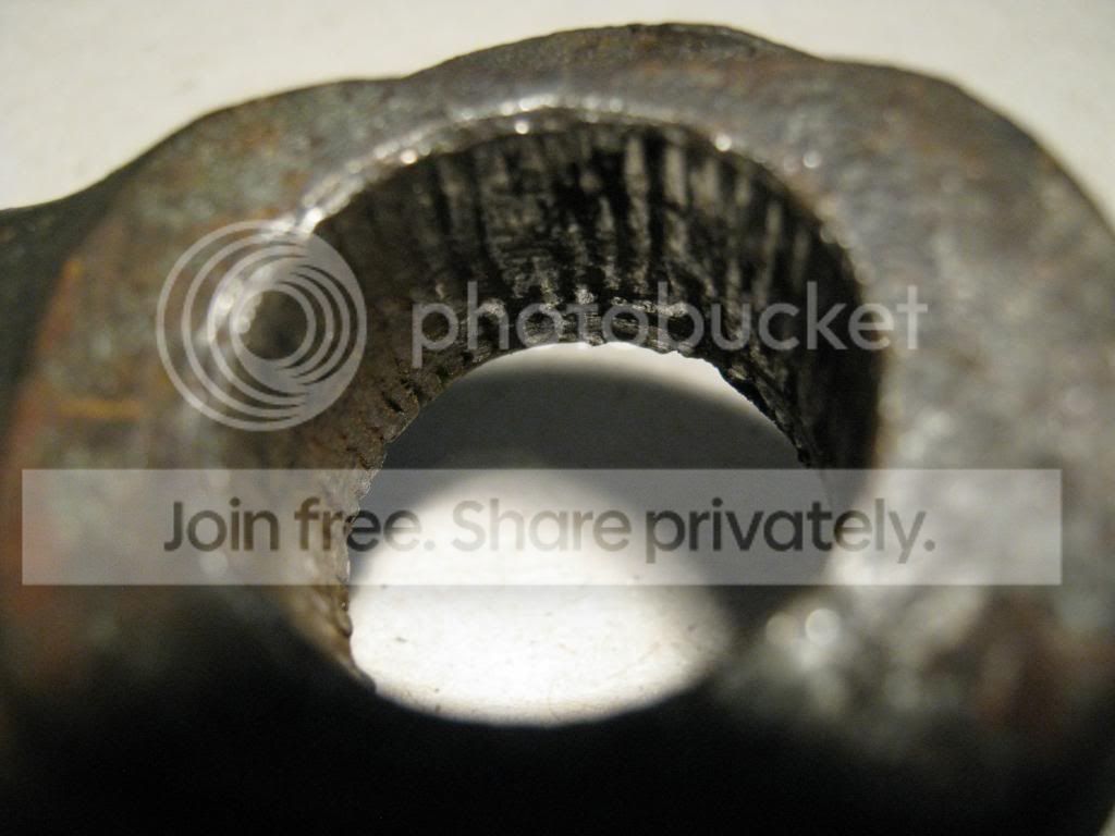

        The splines in the cast damper arm on mine are badly worn.
        Sometime in the past, the shaft has been ground down, punched and welded and is now in a sorry state.
        Would it be appropriate to fix it by pinning ? The shaft is 3/4" diameter.
        Last photo shows the general arrangement, The arm is just in place loosely and will go further onto the shaft, probably until it is flush.

          Pinning may well not be appropriate. Well fitted splines are very effective at transmitting loads from arm to shaft with minimal stress on the components. This was why the original parts got away with relatively soft material. Hence vulnerability to mechanic abuse. In comparison pins put quite high stresses on small areas. Taper would probably be better than parallel.
          Trouble is you have no idea what the ral loadings onthis component look like. Given the failure I'd suspect they can be surprisingly high. Making new shaft and arm would be best or at least re-making the shaft end. Next best would probably be several small dowel pins e.g. ex needle roler bearin needles in a ring of drilled holes dutch key fashinon as course splines. Done nice and tight with loctite its very effective. Pig to do though. Sounds easy but a gremlin magnet.

                Even though parts must be hard to find for your car I think the only way to go is replacement!
                The shaft is normally hardened or at least pretty tough steel (Rockwell 60?). In normal use no movement between the two parts takes place so that joint would last forever.
                Both parts could be refurbished by welding on more metal and then recutting the splines but I think you would have to be both well equipped and pretty desperate to go down that route. The loads on that suspension joint are very high if the damper is working effectively (especially if you drive over a pothole!)
                Clive's method of multiple small pins and Loctite would work but the shaft and bore would have to be a very close fit, and if the shaft is hardened then its not going to be easy to drill.

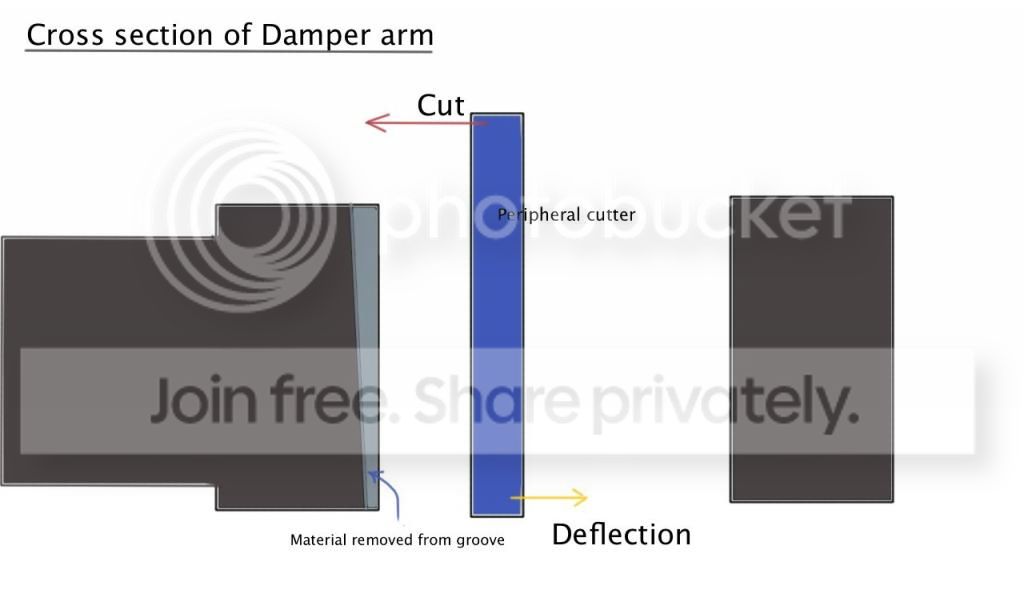

                        To follow Clive's suggestion of 'mini' dutch pinning, I think I could use a 1/8" peripheral end mill and working on the inside of the hole, put some 1/16" (nominal) deep internal grooves into the circumference. Then I would put corresponding external groves in the shaft again 1/16" (nominal) deep so I end up with 1/8" diameter holes on re-assembly. A bit of trial and error on the depth, but hopefully this avoids a lot of snapped drill bits.
                        Plan is to have nine grooves/holes; this gives a space between the grooves/holes of about 1/8".
                        If I'm lucky there may be some deflection of the cutter at the lower end as I mill the grooves out, which would give a slight taper to the groove.
                        Thinking aloud, I could start by cutting just 3 grooves/holes to test the principle; if it's not going to work I can revert to the welding route and use the grooves for the plug welds suggested by Gordon.
                        Any further thoughts will be very welcome.

                                          Personally if absolutely one was not available, I would remove the shaft build it up with weld, and re cut the splines, then Id either make a matching broach to cut the inner splines, or use the dividing head to broach them individually, I have a couple of spline cutters I've made over the years to reclaim bike kickstart shafts etc. So it can be done it just takes time, and really its the only proper way to do this, I know its only shifting oil about but at speed hitting a pothole the oil must move quickly, this will induce more stress than you perhaps think, if it was such low stress it would never have striped the splines, in most cases the shaft twists before the splines strip.
