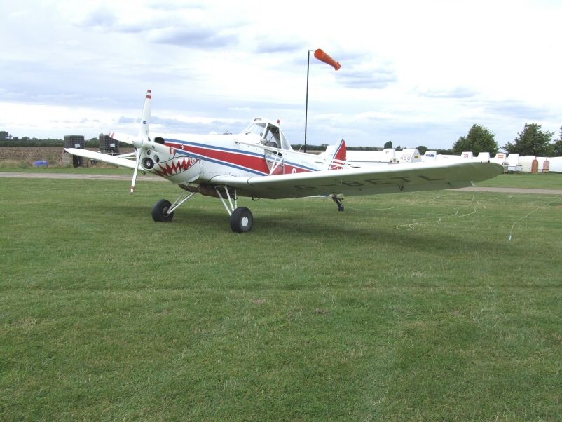

                Ps. is that a tractor you`re driving?

                #110395
                Anonymous
                  Posted by alan smith 6 on 28/01/2013 23:33:06:
                  Alan,
                  Close, it's actually a Pawnee 235, and I was about to tow a glider into the air. The Pawnee is an ex-crop sprayer, and is known as an aerial tractor; simple and basic, but gets the job done. Here's the whole thing:
                  The picture was taken a while ago, the 'sharks teeth' no longer adorn the cowling. Neither does the engine at the moment, but that's another story.
                  Regards,
                  Andrew

                            Ahh happy memories Andrew, we had a pawnee at Bicester when I was in teh RAF, was the best tug on the field, although the Supermunk came a close second smiley
                            The only problem we had with the Pawnee was that it tried to rip the wings of a K8 or K18. Great for towing out a Blanik though, would love to give one of those old tin tubs another rove around the skies wink

                            #110624
                            Ian S C
                              @iansc
                              Interesting Andrew, the prop appears to be fixed pitch, is it metal, wood, or some other construction?
                              Ian S C
                              #110683
                              Anonymous
                                Ian,
                                Yes, it is a fixed pitch prop; fairly fine pitch for towing, so good acceleration and climb performance but a bit slow in the cruise. As far as I'm aware it's a wooden prop with a fibreglass/paint protective layer. Primary reason for a four blade prop is that it is quieter than the normal two blade metal props originally found on Pawnees.
                                Regards,
                                Andrew
                                #110698
                                Chris Trice
                                  @christrice43267
                                  Presumably a slightly smaller diameter too which gives it a bit more ground clearance?
                                  #110722
                                  Ian S C
                                    @iansc
                                    Chris, if the prop dia is reduced, its not for extra clearance, the old two blade prop had enough clearance to opperate from rough farm airstrips in NZ. The reduction of dia reduces the tip speed of the prop, normally the tip speed is very near the speed of sound, and that is where the noise comes from. Even the early Spitfires and Hurricans had fixed pitch props, they had the opposite problem, very poor low speed, course pitch, high speed, from a two blade Watts wooden prop. Ian S C
                                    #110726
                                    Anonymous
                                      Chris,
                                      You are correct, the prop is smaller in diameter, so the ground clearance is better. However, as Ian says, this is not normally a problem with Pawnees. For some taildraggers it can be, like this:
                                      This prop is variable pitch, so another lever to play with. I need to carry checklist cards when I fly this aircraft, in case I forget something. surprise Ground clearance is often worse with tricycle undercarriage aircraft.
                                      To a first approximation the power absorbed by a propellor is proportional to the area of the propellor disc versus the percentage of that area occupied by blades. So, if the power is constant, adding more blades means that the diameter can be smaller. Again, as Ian says, that means the tip speed is lower, and hence less noisy. Noise is a particular problem with tugging as we use full power from takeoff to the top of the tow.
                                      Regards,
                                      Andrew

                                        Ian, generally if you increase the number of blades, you decrease the diameter as the propellor is matched to the engine horsepower x the duty it's intended to perform. A fixed pitch propellor is like being in a car with only one gear. The number of blades on the aforementioned Spitfires and Hurricanes went up with the engine horsepower because they couldn't make the the propellor bigger in diameter without hitting the ground. Again, generally speaking, two blades are the most efficient because they're less likely to be in the prop wash of the preceeding blade although at high speed this becomes less of an issue.

                                          Yes Chris, thats it, there were all sorts of methods tried to get the power harnesed, 5 blades, contra props, the reason for the cranked wing on the Corsair was the extra large dia prop, even when they went to 4 blades.
                                          Andrew, you'v got to remember the shutters on the front of the engine cowling, I suppose the Russians need them in the winter. Ian S C

                                            Posted by Ian S C on 03/02/2013 10:21:27:
                                            The shutters are useful on the descent off tow to prevent engine cooling, but the golden rule is to make sure that they're open before take off, otherwise it gets stinky pretty quickly (burnt oil), followed by an overheated engine.
