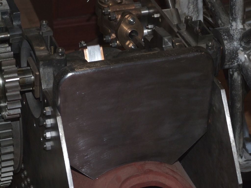

                                            Third time lucky I've managed to hot form a spectacle plate from 3mm sheet that is acceptable. Here's the plate after forming and cleaning up, with holes drilled in the sides and the bottom shaped with a hacksaw and files:
                                            And the plate in place with previously made BSF nuts and bolts:
                                            Pleasingly the spectacle plate was a nice push fit between the hornplates right off the former. No machining or filing needed, so I must have got the sums about right. The outside of the flanges are a bit pitted where I finished off with the copper mallet to ensure a good fit on the former. I hope that a whizz over with U-Pol will fix that. smile
                                            Andrew

                                                Andrew, that's really crisp – Is that over the same former as before (the former former?) ? ..if you have the allowances easily to hand, it'd be interesting to know. I'm in awe of your even flanges .D
                                                #447094
                                                Anonymous
                                                  I did indeed use the former former, with one modification. I've increased the radius on the edge to about 3/32". Here's a close up of the former:
                                                  The flange is designed to be 3/4" high. I originally allowed an inch bending allowance. This was far too much. For the plate shown I allowed 7/8" on the straight edges and down to 3/4" on the corners. The height of the corners still grew to more than an inch. So I plan to cut the allowances down a bit more on the corners. This is especially so for the front plate where the corner radius is 3/4" rather than the 1" for the spectacle plate. I intend to reduce the corner allowance to 5/8", ie, undersize. It's like school uniforms, we hope it'll grow into it.
                                                  Andrew
