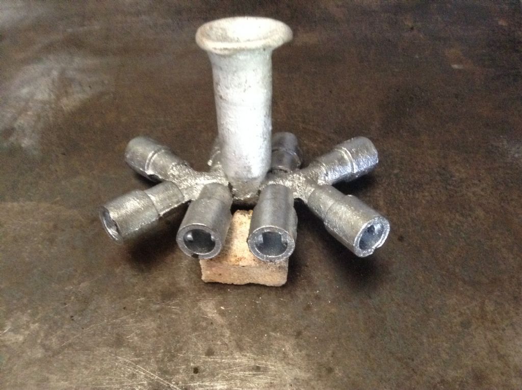

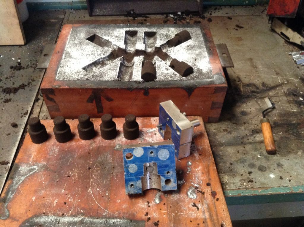

                                        Four stroke Fred
                                          @fourstrokefred
                                          image.jpegimage.jpegAs it's supposed to be cooler during the winter I try to do most of my castings for projects the next few months. Today's winter temperature was 26C , even saw a snake sun bathing in the fence ,image.jpegso with the furnace going the workshop it was quite warm. I did manage to make a "hand" of pistons for my V8 using a double sided pattern and small sand cores made in the aluminium core box. I melted down some old pistons in the hope that my piston would inherit their characteristics. My piston will end up being 22mm dia.
                                          George ( Bundaberg)

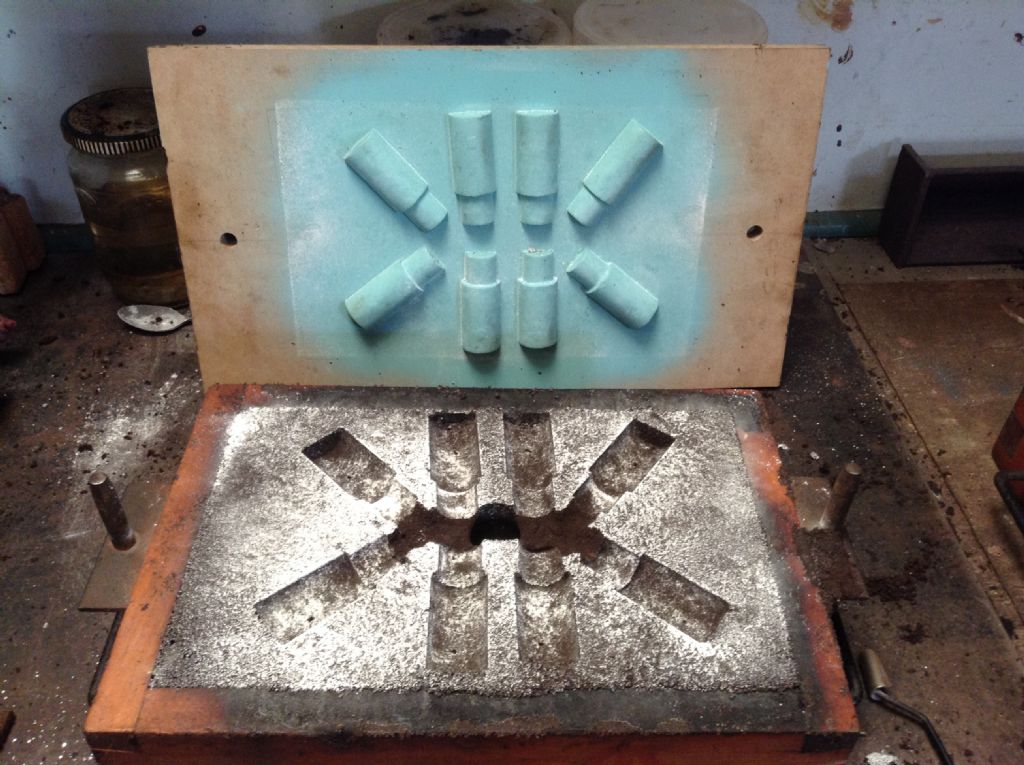

                                              To learn how to cast pistons correctly you should watch the film The World's Fastest Indian,    very informative!
                                              Edited By Richard Marks on 20/07/2016 09:49:49
                                              #247328
                                              Four stroke Fred
                                                @fourstrokefred
                                                I have seen the film and did see that Burt die cast his pistons but they were not 22 mm dia and needed 8 of them! Each man to his own.
                                                George

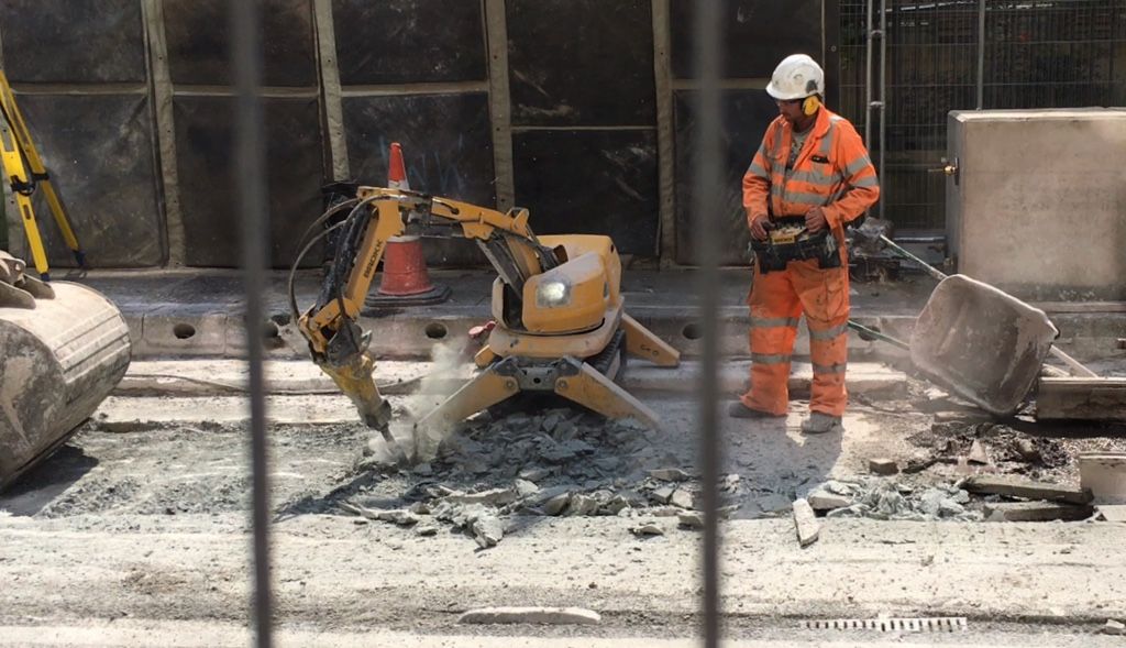

                                                    Roadworks, in central Manchester … Just watched a guy pneumatic-drilling some concrete.
                                                    The drill was 'robotic' and he was controlling it with an oversized handset [same style as RC models]

                                                    duncan webster 1
                                                      @duncanwebster1
                                                      The big brother of that remote control digger is widely used in decommissioning nuclear plant. I've also seen them used inside kilns during relining when it was too hot to put men in. They have obvious health and safety benefits, even when you're stood right next to it, and not that expensive as they make a lot.
                                                      Go to http://www.brokk.com/applications
                                                      and select movie clips to see some applications
