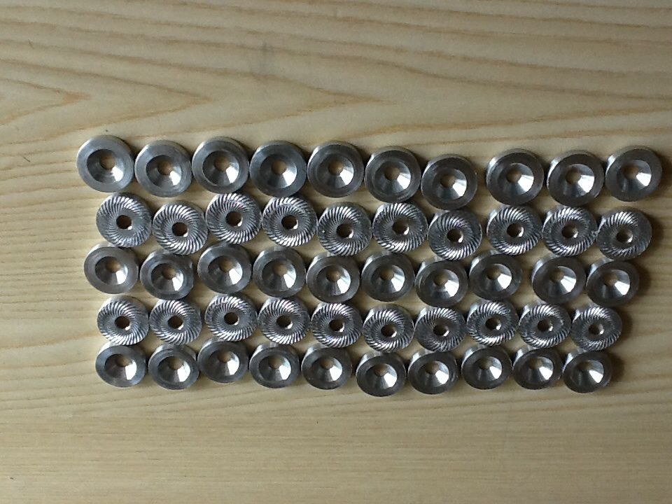

        Not today but over the last few days ,I've made these washers ,one face has a knurled finish and the other face is counter sunk .

          Those look interesting, Kevin
          What's the application ?

                      Thanks Michael, they're fan brace washers to hold an engine in place on a model car , the idea is the knurl will bite into the chassis and the larger diameter and washer thickness stops the washers from splitting .

                        Kevin, what sort of knurling tool makes those nice swirls ?

                          Hi Bob thanks for your interest , it took me a while to work out how to do the knurl ,I tried different ideas and a lot of head scratching ,I'll give it a day or two and see if any of you chaps can come up with a solution .
                          It will also give me a chance to takes some pictures of the process .

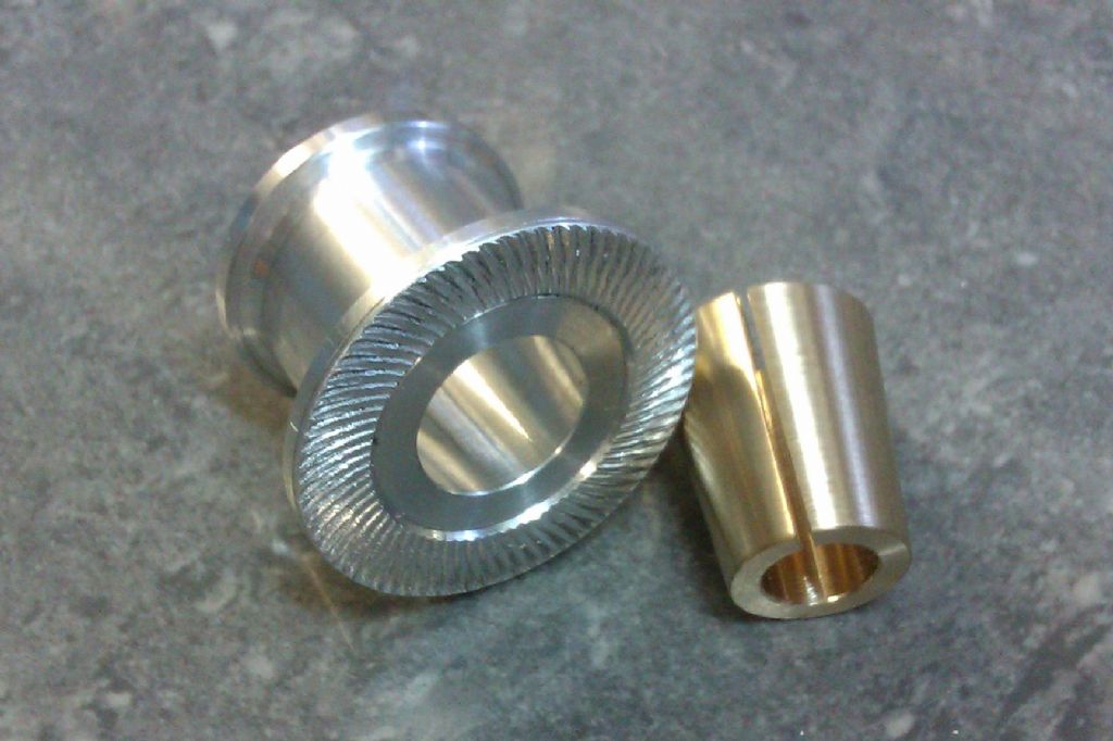

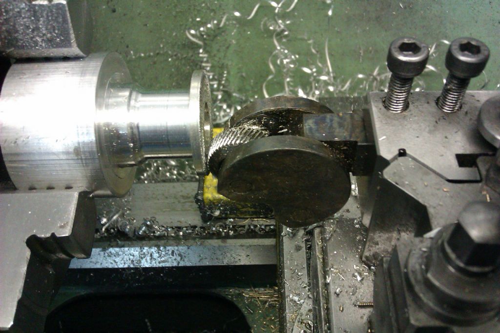

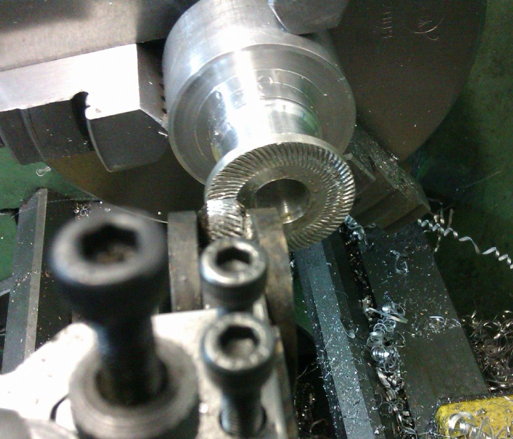

                            Can't wait that longsmile p
                            Its the usual way for doing prop drivers on IC engines, heres one I did earlier
                            Edited By JasonB on 02/08/2014 20:49:14

                              Yep thats the way I did it ,I wasn't convinced it was going to work at first .

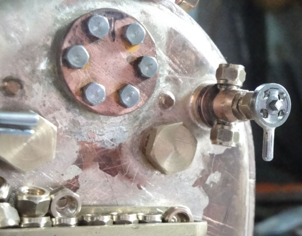

                                i made the handle today for the blower valve for my 5"g Terrier Stepney. the valve is a captive valve a variation of that described by Don Young for his Doncaster. it also has a steam feed below for the steam brake, as the terriers didnt have manifolds or turrets, i want to avoid as many steam feeds as possible on the turret i will make principally for the whistle valve. the blower valve handle is stainless and didnt take too long. the round part is 3/8" dia and will take a bit more work till im happy with the appearance of the spokes.
                                partly seen below in the scale 'tray' is part of a batch of 3/16" x 40 tpi union nuts i made on wednesday evening.
