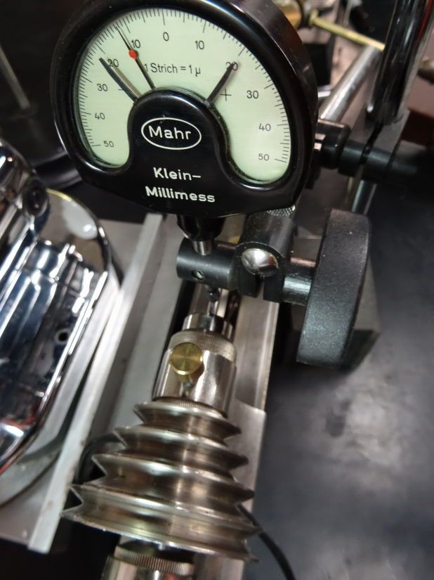

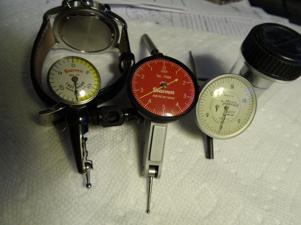

        dsc00552lathe10.jpgdsc00563dialindicators5.jpgNow this may be hard to believe but the Boley Leinen 8mm lathe, I've owned for 15 years has amazing, to me, spindle runout accuracy.
        About 5 five years ago I measured the spindle runout, starting with a last word indicator with .001 divisions and the indicator never moved. I switched to a .0005 division dial indicator and again no movement. So I switched to a .0001 division indicator and saw very slight hard to see movement.
        Since then I’ve acquired a Mahr Klein Millimess 9129 and last night I went through the .001 to .0001 indicators again and got the same results. So I set up the Mahr indicator and the pointer moved about 1um which is equal to .00004 (1um actual vale is .00003937…..). This is amazing to me or is it normal for watchmakers lathes? All my indicators are calibrated using my Mitutoyu height gage.

          It's quite possible.
          But that very tall magnetic stand anchored to the bench next to the bed with the flexible fine adjustment joint in the middle of the second arm could be flexing all over the place by several thou too.
          A more stable set up might be to mount the clamp that holds the dial indicator gauge directly on the first upright bar of the magnetic base and then clamp the magnetic base to the lathe bed. The more direct the better. Whatever you do, get that fine adjsutment joint out of the equation. They have no place in precision measurement.
          And I can't see exactly what you are measuring from there — the spindle itself or a piece of bar held in the collets, or something else. An overall view picture would help.

            Thanks for the reply. I was an inspector in a state of the art metrology lab in one of the largest aerospace companies from 1969 to 1974. I was just curious about accuracy of these old lathes.
            #534083
            Hopper
              @hopper
              Well if you are happy with your measuring process — I still have some mistrust of those flexible joints based on experience — then the answer is yes these lathes can have that little runout. Enjoy.

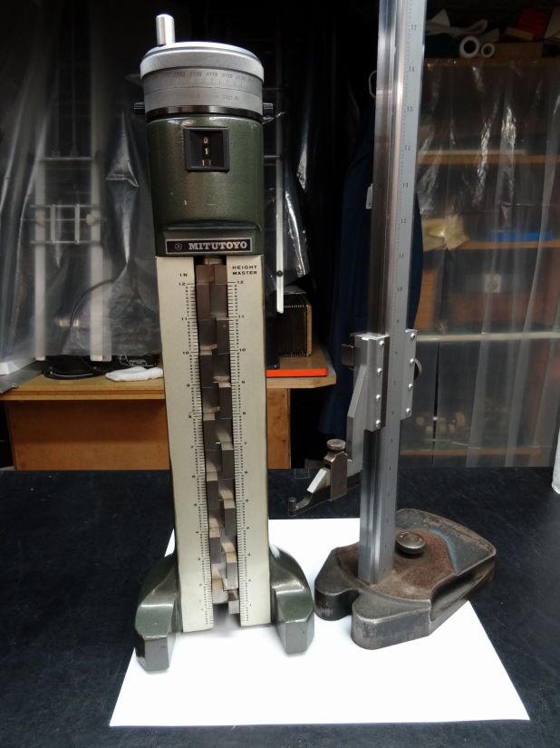

                Superb accuracy!
                I would be proud to own a machine of such quality. But probably frightened to use it for fear of causing wear!
                But you won't find many folk with Height Mics, outside of industry, unless they have been involved in quality, inspection and metrology. If only we could measure in such conditions of cleanliness and controlled temperature and humidity.
                I second Hopper's comments about flexibility in measuring set ups.
                You can't measure, reliably, to a tenth of a thou if the measuring device is supported by something which can move that much of itself.
                A bit like measuring with a tape measure when your hand is shaking!
                But, in practical terms, often, we are making a one off part to fit another one off part, under whatever the ambient conditions happen to be at the time, so the absolute dimension is of lesser importance.

                  Could the OP edit his first post so we know what the units are please, (2nd paragraph).
                  I presume the the lathe spindle is supported on plain bearings? If that is so then there will be some clearance so the bearing can be lubricated properly.
                  How where the measurements taken? Just by rotating the spindle, if so I would expect the results quoted. What about up and down/side to side movement? Try measuring with the DTI on top of the spindle and then gently lift the spindle, (simulating a cut) . I would suggest that the necessary clearance in the bearing would show if the measuring equipment is a s good as you suggest.
                  Also, some measurements after the the machines been running would be interesting.

                        Posted by John MC on 16/03/2021 08:33:38:
                        If you are asking what the value of each division is, it equals .00003937".
