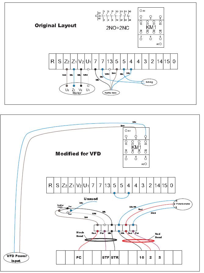

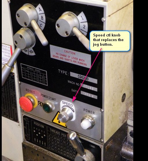

                I converted my Chester 12×36 Geared Head lathe to VFD some years ago. I wanted to be able to operate the machine exactly as before, but with the addition of a speed control knob. It has a control box which houses the wiring and relays that implement the NVR and motor forward/reverse functions. It was a complicated mass of wires and devices that seemed impossible to modify.
                Modification for the VFD turned out to be very simple. The VFD output goes straight to the new 3ph motor, and both are outside the ctl box. There is a power lead that supplies 220v to the ctl box, so that was unchanged. I used a voltmeter to discover the power supply output from the NVR relay and used that to power the VFD directly. Nothing else in the ctl box was powered from the NVR relay. It was an easy job detecting which wires were used to activate the motor direction relays, and these were used to control the VFD. There was a jog button which I never used, so I replaced it with a suitable speed ctl potentiometer for the VFD, and made a suitable label for it. That was it. It was much easier than I originally thought.
                Different VFDs need different speed ctl pots, so you will need to check the manual for your VFD.

                    Gary, your controls look pretty nice as well. Did I understand you correctly, that you have 220 V coming to your lathe, through the NVR switch, and then into VFD's power input? I don't know about your VFD, but the manual for mine doesn't recommend such an arrangement, in fact they say it's better not to power cycle the VFD more often than once in 30 minutes. It's better to have VFD hard-wired (possibly with a disconnect switch for servicing and maybe a magnetic contactor to implement some kinds of protections). Most VFDs have digital inputs for wiring start/stop and rev/fwd switches, with various arrangements possible (2-wire: on/off switch and rev/fwd selector, 3-wire: momentary NO push button start, momentary NC push button stop, rev/fwd selector switch). Even in 2-wire mode, VFD itself (with appropriate settings) prevents undesired restarts after power loss. Your NVR switch will also live longer when used this way (as opposed to full current at 220 V).

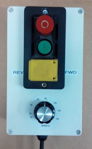

                          I took the easy way out, buying one of these kcAAOxy4XNSOXKm”>https://www.ebay.co.uk/itm/INVERTER-PENDANT-CONTROL-BOX-POD1-with-Estop-MYFORD-BOXFORD-DRILL-MILL/184153593092?hash=item2ae068d504:gkcAAOxy4XNSOXKm from ebay.

                              My VFD (a Mitsubishi) is powered directly from the output of the NVR relay. When I first switch the lathe on from the wall socket, nothing happens. But when I press the Power Start button the NVR relay is energised and the VFD is powered up. The VFD then remains powered up until I switch the lathe off at the wall socket, or I press the RESET button.
                              Here's a schematic of the wiring – all the original relays except KM1 (the NVR) and wiring have been omitted for clarity. The speed ctl pot is a 3/4 turn version that I find is exactly right for my use.

                                Gary, I understand your wiring and the way it works is fine, as long as you don't hit the NVR stop button every few minutes . I just think that you could get rid of the KM1 magnetic contactor, and just wire the buttons connected to it directly to the VFD's digital inputs. On the other hand, why mess with something that works for you?

                                          The only reason for hitting the NVR stop button is for an emergency, and it's location on the lathe control panel is very handy for such use. The KM1 output is at mains voltage so is certainly not suitable for connecting to the VFD digital inputs.

                                            Ok Gary, maybe I misunderstood you. Is your emergency stop button a single unit with the KM1 relay/magnetic contactor? Or are they separate units wired together? If it's the latter, what I'm saying you can remove the relay and keep the e-stop button, wiring it directly to the VFD (it provides a 24 VDC power supply contact and digital input contact, the control buttons are between those).
