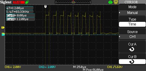

                Pleasant hour with an Arduino tells me more about the HC-SR04 rangefinder module:
                The receive and transmit transducers appear to be identical.
                The module is self-contained. Supplied with 5V, it's set off by a short pulse of about 2uS on the trig pin. This causes the module to emit 8 12uS pulses at about 41.7kHz (my module).

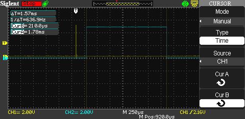

                The unit averages the echo and replies with a pulse proportional to distance. Trigger pulse in yellow, reply blue:

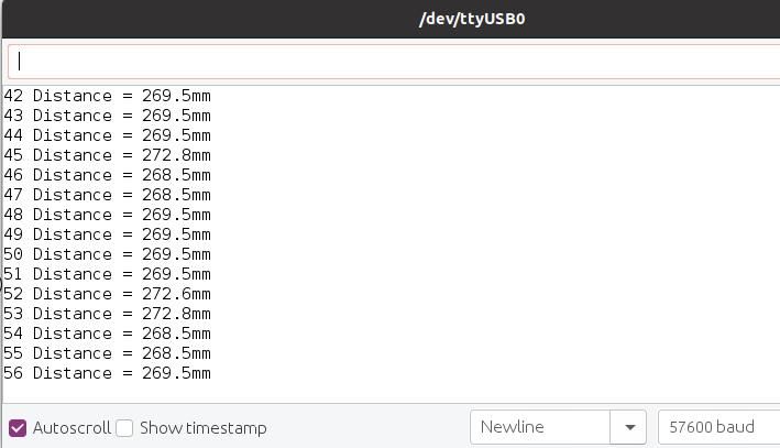

                The Arduino measures the length of the blue pulse, and calculates distance based on the speed of sound in air. Off the web, I used 334m/s which is correct for Standard Temperature & Pressure and 50% humidity, but not my dining room today. The distance is roughly correct; aimed at a target 270mm away, I got:
                The variable results are probably due to my wobbly experimental lash-up: target is an address book leant against a fan-cooled oscilloscope while I rest my elbows on the not very stiff table and the sensor is within 20mm of the tabletop
                Given that the module sends 8 pulses, and needs to be triggered, I don't think it would be easily confused by a second module, but it could happen. Can't try it because my spare module has gone awol. I remember putting it safely in a box, not which box.
