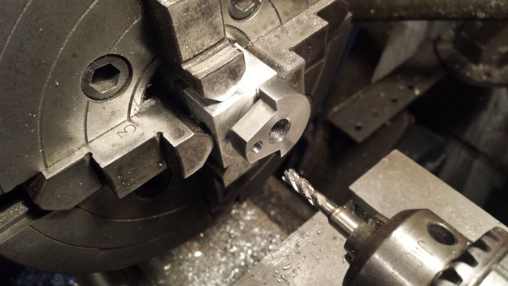

      I've been reading a book that describes how to accurately position holes using buttons. Basically, I think it says:
      • drill and tap a small hole approximately in the right position using the usual methods.
      • screw the button to the hole
      • accurately position the button. (The hole through the button is bigger than the screw so the button can be moved relative to the screw. )
      • Mount the work on a lathe faceplate or 4 jaw chuck
      • Use a DTI to accurately centre the position of the hole using the button
      • Remove the button and bore out the hole to size
      It's very possible I 've misunderstood the book, but the method seems to rely on correcting a mildly inaccurate pilot hole by boring it out. My smallest boring bar starts at 9mm diameter. Does that mean that the method isn't suitable for accurately positioning small holes, or am I missing sometjhing?

          You could always make the first trueing cut with a 2 or 3 flute milling cutter held in the tailstock which should be less likely to fiollow the wayward pilot hole than a drill.
              That's the way to do it, keep the center fixing screw as small as is practical

                Don't let the 9mm bar limit you. You can buy or make much smaller bars. You can grind one out of a square tool bit or an old end mill.
                The standard screw for toolmakers buttons made by Starrett or Brown and Sharpe was 5-40 (1/8" dia.) I suppose a smaller screw could be substituted.
                the smallest bored hole when using buttons would be one that just removed the pilot hole.
                +1 on using an end mill to true the hole before boring to size. It is short and rigid. Its square end will not follow the pilot hole.

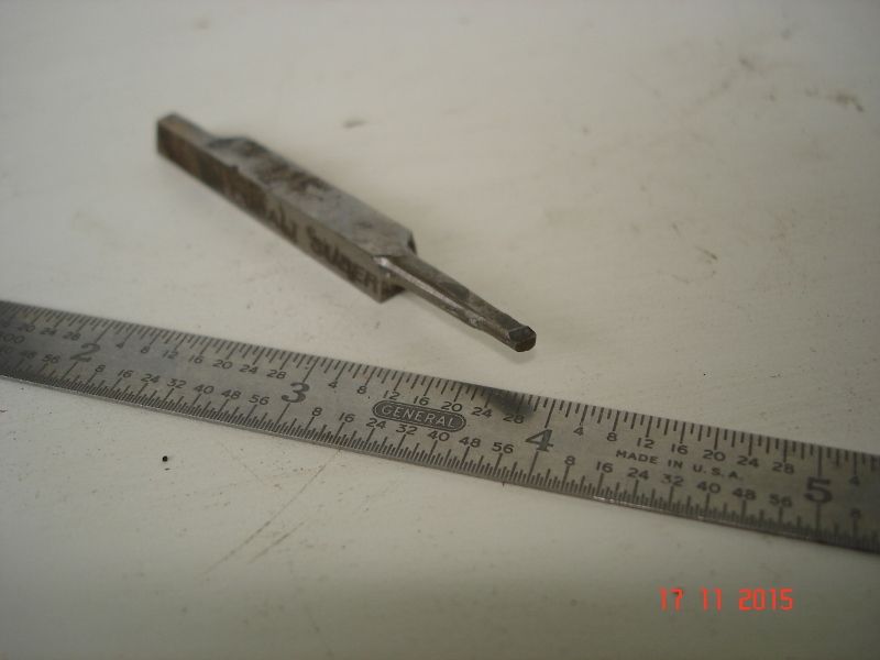

                            Here's one made for a job years back from a bit of 1/4" squ HSS, its still in regular use, when first made it went in a 3/16" hole, now the end looks more like a D bit, and it will go easily int a 1/8" hole.
                            Ian S C

                              For small holes you do not need to fully bore the tapped hole to correct it. It can be done with a graver or better still (if somewhat cack-handed & short sighted like me) a slim 'pointy' tool held at centre height in the tool holder. The aim is to come in at a 30 degree angle and effectively chamfer the edge of the previously drilled/tapped hole – which if correctly marked out in the first place should not be too much out anyway. This will true the hole and help guide the following drill in about as accurately as you can do so. I'd use a new drill for the job if possible.
                              I've done this on a set of gearbox plates where I wanted the mesh to be as good as I could get it and I didn't have a small enough boring tool for the holes required (and frankly was too idle/impatient to make one). It's exactly like using a slocome (centre) drill to start the hole but where you know the 'cone' will be dead on if done carefully. My old S7 tailstock has quite a bit of droop in it – so it's not ideal for really accurate drilling and sometimes needs my help. Obviously, fully boring the hole out is the better option but this is a workable alternative.
                              By the way – you describe drilling just a single hole and generally for that I'd just use an optical punch to get the best 'dimple' I could, centre the work from that and then just centre drill it. If I was really worried about accuracy (for the reasons previously given) a quick truing/coning cut helps reassure me. Traditional "buttons" are sets of the same diameter as described by another poster (with one long one) but I've not really needed a set of this kind that I can recall.
                              The 'buttons' I have used have generally been turned to a specific size to set the relationship between holes (or other reference points/edges) as well as I could get it given my antique machinery. For instance, for the gearbox mentioned, buttons were turned to the gear PCDs (which I could check with a micrometer) and then screwed to the work touching each other – obviously the first one set has to be slightly longer. I also use a form of simple button when I have work with a existing hole in it that I need to centre. Maybe it's not called a "button" but to my mind, it's a button with a turned stub (to fit the hole) that can be clocked in exactly the same way to centre the work.
                              Not the way it's done in industry (or by others here) perhaps but I'm afraid I don't have a jig borer or a mill with DROs, so these simple dodges help….
