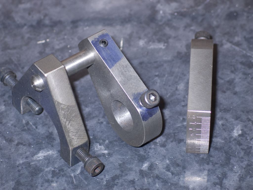

                              Phil P
                                @philp
                                I made my own angle setting gauge for the Union grinder, I can let you have the drawing if you feel inclined to have a go at making it.
                                I found the original motor to be unsuitable for my use due to its speed limitations, so I designed my own grinding head for it. This unit will also fit onto the Myford super 7 lathe and can be used for cylindrical grinding as well.
                                Here it is grinding the big end journal on a model engine crankshaft.
                                The Union gets used for all sorts of jobs, once you get it up and running you will think of plenty of new uses for it.

                                    Phil, I agree with Thaiguzzi, your Union looks very nice; I didn't realise that it was THAT one.
                                    I'd be very grateful for a copy of your drawing for the angle setting gauge.
