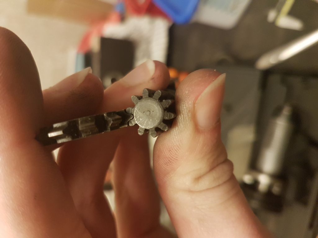

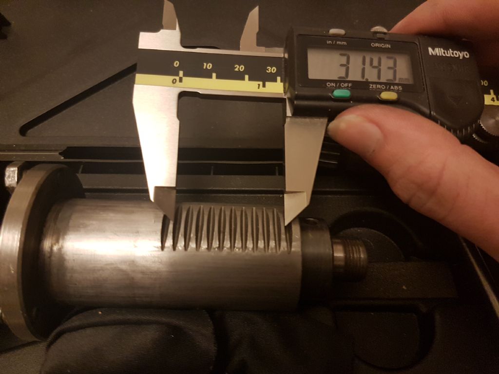

      Hi guys, I’ve just been fiddling with a quite well worn unimat 3 lathe I recently bought, and in trying to sort a few things out, I found something rather interesting/ peculiar about the rack and pinion Z axis.
      The rack on the bearing carriage has a pitch of 3.14mm, which is a module of 1 (pi*mod) which I measured over 10 points and divided for better accuracy.

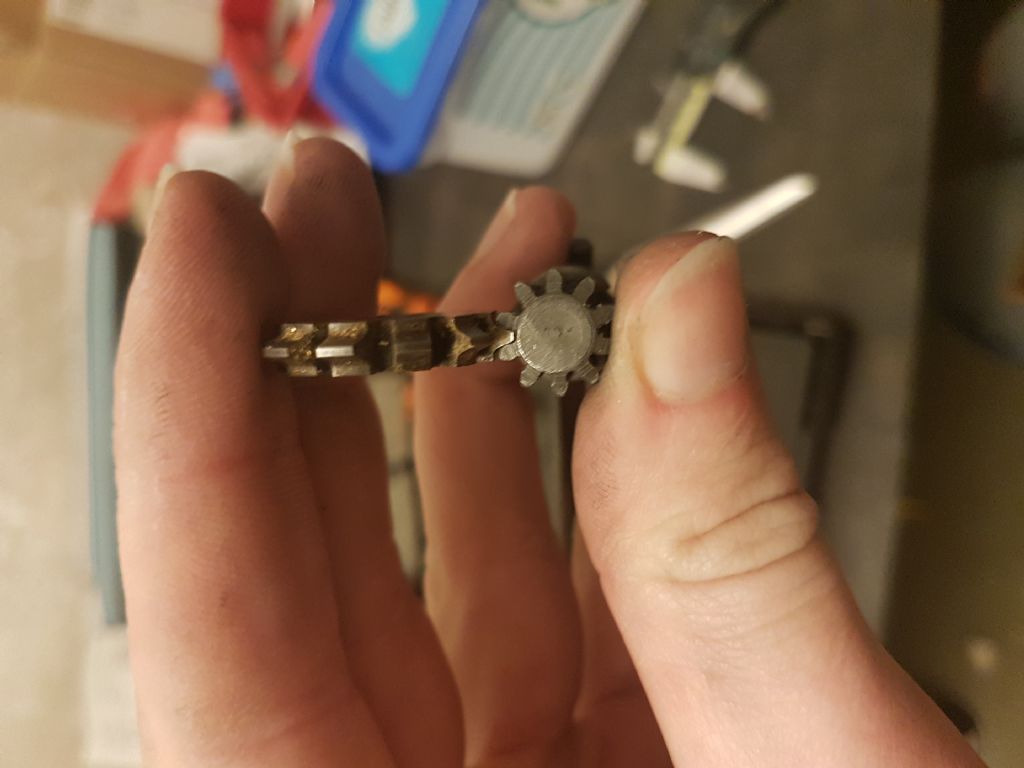

      Now when I look at the handle (which I am 99% certain is the original) and offer up gear cutters to it, the closest fit is a 0.9 modulus cutter.
      When the pinion is placed in the rack outside of the housing and rolled, it does not seem to move smoothly all the way.
      This seems like quite an oversight by emco unless it is for a reason?
      The reason I am going through it with a fine toothed comb is that I am looking to make a stepper motor attachment for it and the play that it has at the moment is not good enough.
      I will try and add some pictures when I work it out.
      I look forward to the discussion!
      Pete

          Here is the bearing carrier with the Mod 1 rack
          This is the 0.9 cutter, and it may not look too conclusive from the image but the involute curves match pretty closely.
          None of the involute curves come anywhere close to touching on this gear cutter, yet the gear does not look excessively worn.

              Involute cutters are a compromise on shape so if the pinion was hobbed then you won't get an exact match, also may be a modified form due to the small number of teeth.

                  #1 cutter (out of 8 cutters in the involute cutter set, PA 20 degrees) is for 12-13 teeth, so the 10 tooth pinion cannot be formed accurately with an involute gear cutter. There probably is slight undercutting on the tooth form.
                  The 10 tooth pinion gear was most likely hobbed.

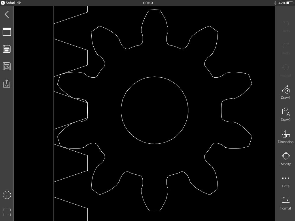

                    This calculator might be useful: **LINK**
                    http://www.otvinta.com/rack.html
                    As Jason has mentioned, the original pinion would have been a commercially convenient approximation.
                    … it would be interesting to compare this with the calculated profile.
                    P.S. Unless you happen to have a decent 'profile projector' to hand, scanning the pinion on a flat-bed scanner, at [say] 600dpi would a useful start.

                        I've just been playing with this: **LINK**
                        http://hessmer.org/gears/InvoluteSpurGearBuilder.html
                        I think it might be just what you need to design a better pinion.
