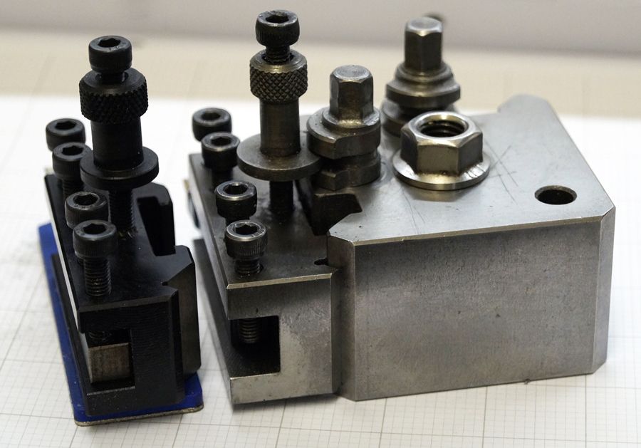

                                      A picture below of the Dickson type post that came with my s/h 918 lathe. I dont know if it was from a supplier or home workshop made but whichever it is certainly very good quality. The post came with 12 holders, 8 quality ones which match the post and a set of 4 black holders which are definitely from a supplier.
                                      The black holders fit the post but not as well as the quality ones plus they are smaller in some of the dimensions so lighter duty. Although the black ones do fit the post it is only just when it comes to clamping them down, I have noticed that the cam spindle rotates further around and with one of them I think a bit of extra leveridge and it would pass the cam high point and be loose again. Having said that they do work and I have had no issues when using them. Unfortunately it is not that helpful here as there is no markings on them so I dont know which supplier they came from.

                                        Of the 20plus holders I have only 4 are originals but they all seem to fit, the last few needed a bit of encouragement but at about £10 each fair enough. Anyone tried a Bison one on a Dickson post…
                                        I have a Bison tool post set up on my WM250V-F; of the 18 holders I have there are two with a 'W – M' stamped on, so a right mix 'n' match some were bought from Harrogate exhib', eBay, RDG ( usual disclaimer ) & all fit the tool post without any 'encouragement' maybe I've been lucky buy so far so good.

                                          Hi just putting in my own experience. I have the original Bison Dickson type tool post with 7 original tool holders. I bought the RDG tool post which is a Dickson clone just to see if it is compatible. I bought the whole set just incase the tool holders won't fit on my Bison then I can still use the RDG set on its own. Bison tool holders are more or less twice the price of the RDG. The tool holder fits really good on both tool post. My only issue is the RDG's adjustable set knob fouls the locking cams of the Bison but I can still lock it tight. Its the diameter of the setting knob that is slightly larger on the RDG. I did test the Bison tool holder on the RDG tool post and it fits/aligns very well and its tight on the lock and the cams is not fouling the adjuster knobs base. So my current combo set up is the RDG tool post and tool holders plus my existing Bison tool holders. Since then I have added more RDG tool holders and works fine with me. I accumulated a total of 25 tool holders 7 of which are the original Bison tool holders. The rest is from RDG cheap, Chinese and happy with it.
