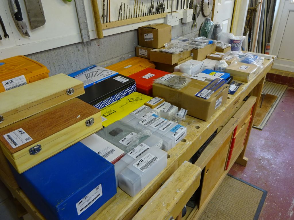

                          This lot came with the SX2.7, there may be one of two items there you don't really needsmile p
                          As has been said both Neil and Myself have a beginners series in MEW that may help you, Neil is doing the lathe and I am doing the mill.
                          As a basic kit for the mill
                          Clamps set, Vice, ER Collet and 6 collets, Lever DTI and magnetic stand, Edge/ctr finder, 6 & 10mm 3-flute cutters should bet you going, buy anything else as the need arrises.
                          Edited By JasonB on 04/02/2018 08:17:50

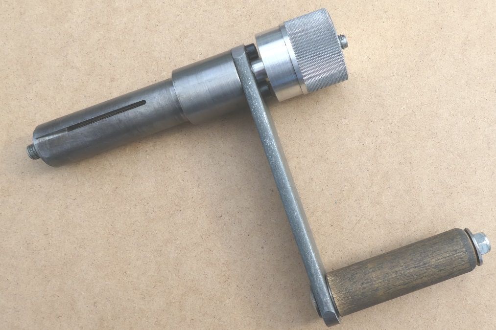

                                  Rik Shaw
                                    @rikshaw
                                    Hello Ross – I have had a 250v-f and still have a 16 mill. +1 for all suggestions from chaps on here so far.
                                    I would not be without my QCTP for my lathe. I currently have 17 tool holders but still could do with a few more.
                                    Also, you might consider making yourself a spindle turning mandrel as my 250v-f lowest speed was way to fast for safe screw cutting (for me anyway!)
                                    As for the mill, DRO scales fitted to the X and Y turn the mill into a virtual jig borer – highly recommended. And don't forget a centre/edge finding device or "wriggler", cheap as chips but essential.
                                    Rik

                                      Ross Lloyd 1
                                        @rosslloyd1
                                        Posted by JasonB on 04/02/2018 07:55:00:
                                        Wow, that all came included in the price? Can I ask how much you parted with for it and who you went with? On the arc-eurotrade site, that gear doesn't seem to be included unless you stump up the readies!
                                        The kit suggestions sound good, I think I have a great shopping list now. Re: the beginner articles, my google-fu is failing me, how do you get hold of them?
                                        Apologies for the barrage of questions, and thanks again!

                                            Ross Lloyd 1
                                              @rosslloyd1
                                              Posted by Rik Shaw on 04/02/2018 10:21:00:
                                              Rik
                                              Edited By Rik Shaw on 04/02/2018 10:22:44
                                              That mandrel looks like an excellent project to try! Looking at the pic I posted above of the 250, can you tell if that is a quick change post or… not-quick change? laugh At the moment my beginner eyes don't know what to look for.
                                              Would you say the powered crossfeed is a must-have?
                                              With the mill, I have some future plans to CNC it, and so a DRO would end up being surplus to requirements eventually. That said, what are the benefits you find day to day with using one?
