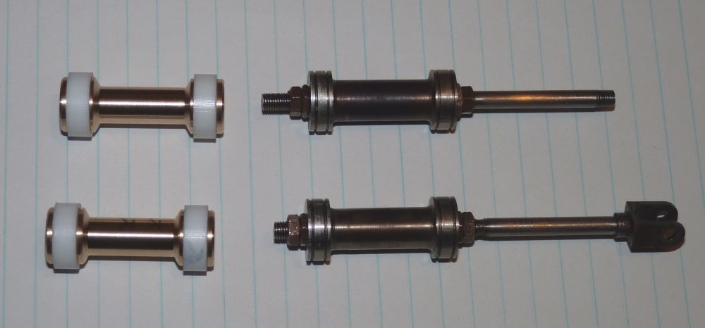

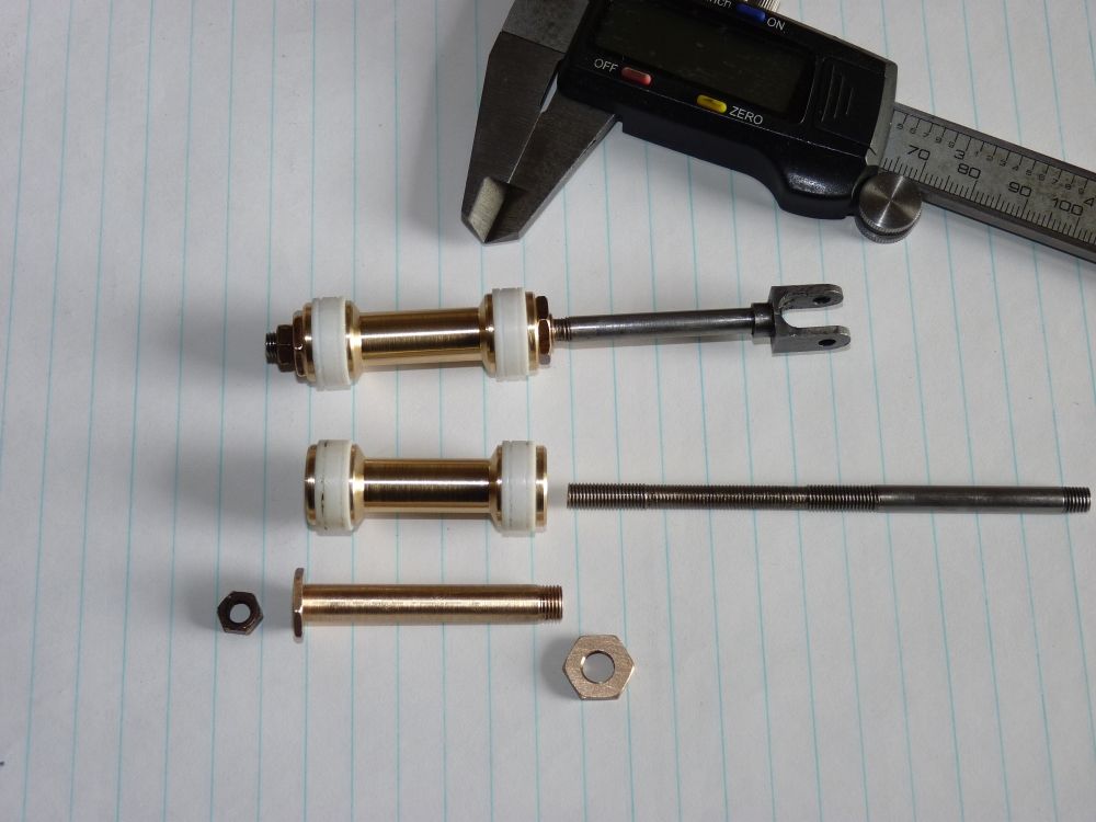

              Here are a pair I made for a chap at our club. They are for a 3½" gauge 75000 class loco which originally had plain stainless bobbins that leaked badly:
              The valves consist of a central bobbin made of bronze, stainless, or even brass. The heads are rings of PTFE held onto the bobbin by threaded caps. You machine the PTFE heads to a push fit in the liners and the fit sorts itself out as soon as you steam the loco.
              The bottom photo shows that I altered the method of valve adjustment to a much better method. The originals were adjusted by altering the nuts on the threaded valve rod which is a right pain to do. In my method the valve floats on a central 'bush' threaded onto the valve rod. To adjust the valve you just rotate the bush and secure it with a locknut. Think I got the idea from an article in an old ME
              There's a bit of a description of these valves here:
              **LINK**
              Unforunately, I didn't take any photos of the bobbins before I assembled them but hopefully you get the idea. I might have done a CAD drawing before I made them, I'll have a look.
              It might be an idea to see if you can check the valve liner bores to make sure they are truly round and parallel. It's possible they may have distorted when they were fitted to the cylinder block? PTFE heads will accommodate slight ovality etc. in the bores though but better if they are true.
