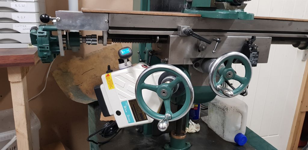

      I forgot to post a picture of the finished item. In the end i had to tilt the motor as i had not realised when the X axis was driven to the far right, the end housing was going to hit the speed control pot.
      Steve.

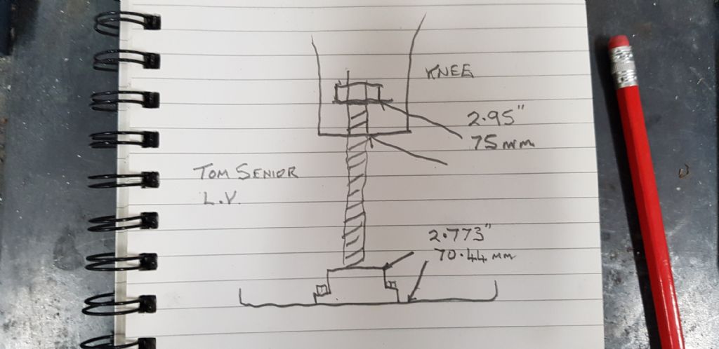

              So you want to know the distance the screw has left when the knee is wound fully down. I could measure mine by putting a straight edge across the knee base & using a mirror/ camera see how much thread is left. Minus the distance the nut & holder stand above the cabinet , that would give you the gap you required to know.
              Steve.

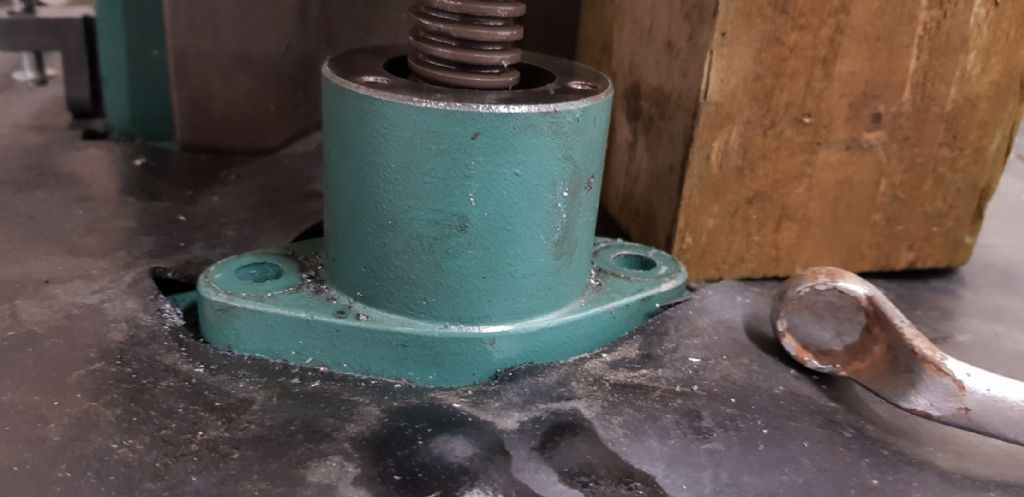

                I took a pic & did some measuring. This is the result.
                Steve.

                                      Sorry to confuse with my architectural drawing. The top part of the picture is the knee with 75mm clearance from the underside of the knee casting to the thread end. At the bottom of the picture the nut & housing stick proud of the base by 70mm. Giving roughly 5mm clearance with the knee at it's lowest point.
                                      Steve.

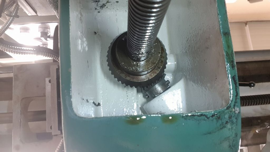

                                          Steviegtr
                                            @steviegtr

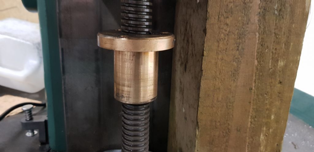

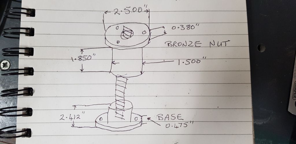

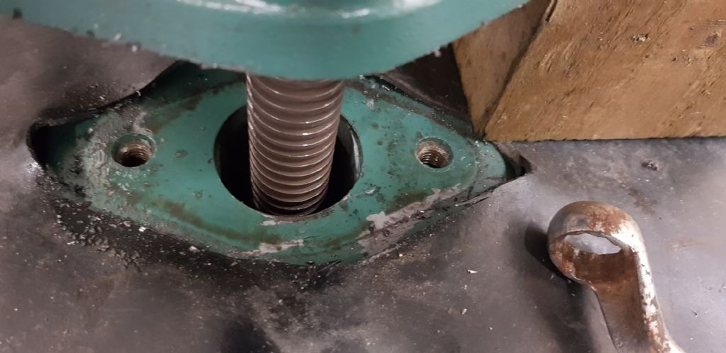

                                            Did it tonight for you old mart. One thing i discovered is that after you mentioned the bump when lowering the Knee i assumed mine must be worn too.
                                            So when taking these measurements i put a lever under the Knee to see how much play there was in the Nut. The play in the nut is literally immeasurable. The bumping noise is from the top of the screw where it is connected to the bevel gear. It looks like the bevel gear is held in place by something like a cross pin of sorts, which can be rattled up & down. I assume it was made like this, as it always has a great weight on it.
                                            Have you actually checked your Nut for play. It is a huge affair. Pictures & drawing below.
                                            Steve.

                                            #507727
                                            old mart
                                              @oldmart
                                              Thanks, the hole looks like 1 5/8" diameter, so there will be plenty of room for part of a nut down there. It looks like you will end up removing the bed and cross slide to get at the knee mechanism. I can say that the tapered gib for the bed is removed from the left hand side and the X axis wheel and both endplates for the X leadscrew have to come off, then the bed can be slid off easily. After that, the X leadscrew will have to be unscrewed to get at the Y axis nut holding screw in the middle of the cross slide. After that, I can't remember. The whole lot is pretty easy to dismantle, we took the mill to bits and put all the bits on pallets when the museum inherited it.
