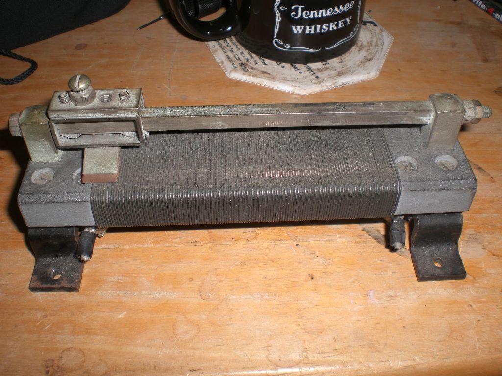

                            Nicholas Farr
                              @nicholasfarr14254
                              Hi, basically, it is the same type of construction as the variable resistor/potentiometer/rheostat shown below, but only the slider and one end of the coil would be used. Therefore enamelled or insulated wire would be of no use.
                              I guess the idea of a threaded tube would give a consistent spacing while keeping each turn of the coil separated and only have the slider able to make contact with the outermost side of the winding.
                              Regards Nick.

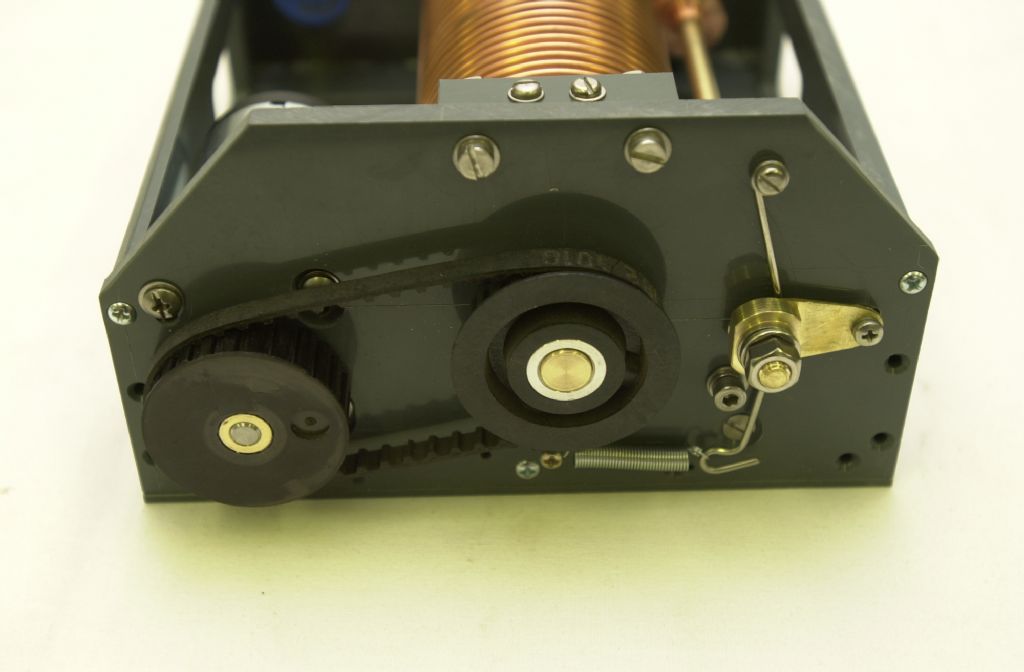

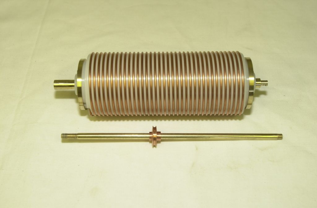

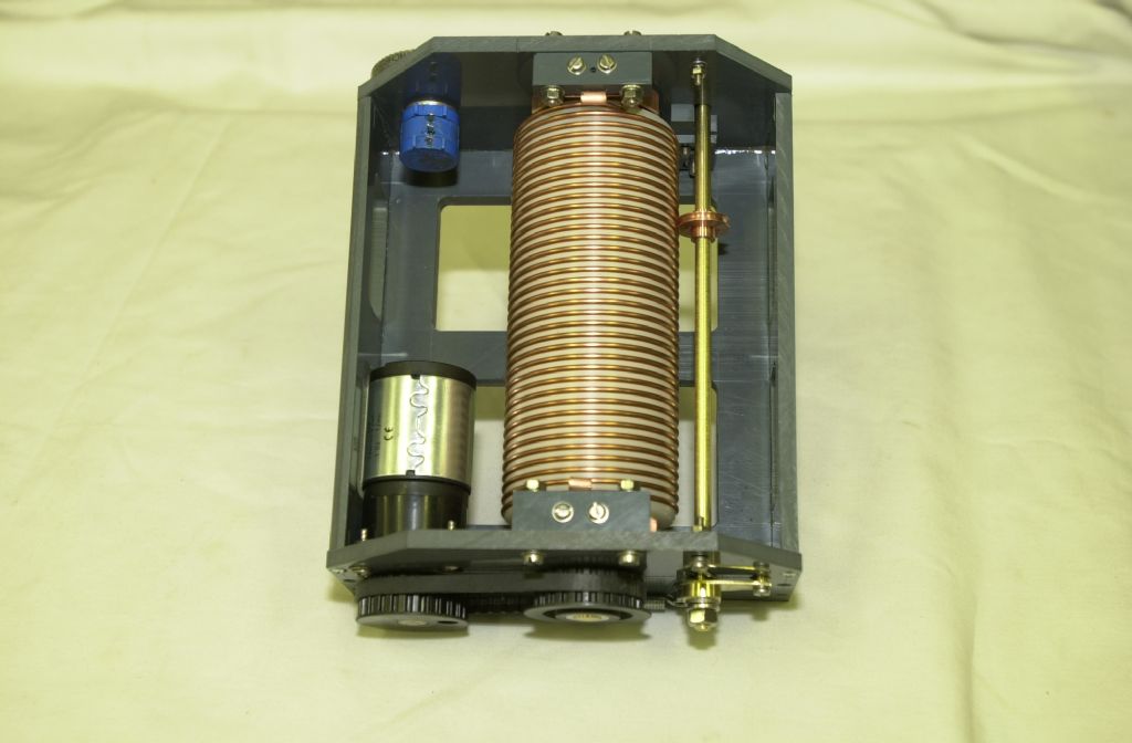

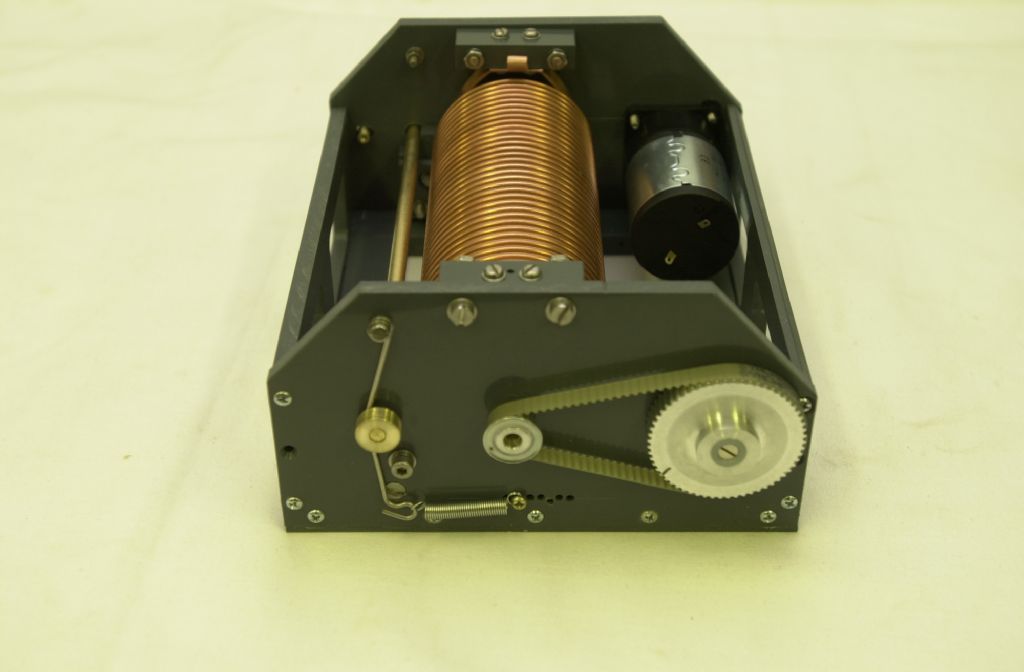

                                Joseph Noci 1
                                  @josephnoci1
                                  This should give an idea of the intent…Although this one progressed a little beyond the screwdriver concept..
                                  Joe
                                  Coil and rolling contact
                                  Coil drive assy1
                                  Coild drive assy 2

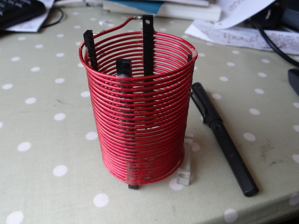

                                    Bit more detail would help Chris – presumably this is a transmitting HF whip antenna? If so the frequency and power matters, white drainage pipe probably fine with 50W at 3.5MHz, and dodgy with 150W at 28MHz. Well worth applying Joe's microwave test – I've found some PVC drainpipe to be much better than others, probably because they use different fillers.
                                    Does the coil have to be part of the structure? The other possibility is to air-wind a large diameter coil and run the smaller whip through the axis, the bigger the gap the better. This example kept in shape by gluing wire to four thin black plastic strips.
