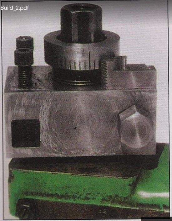

      threaded_tpost.jpgHave been pondering this Norman Toolpost – the block and the post are both threaded to allow for tool height control.
      Locked at the top by a lock nut on the post.
      But if you are cutting towards headstock, then surely the block could be pushed back towards the headstock as there is nothing underneath it to stop it it could rotate on the thread and it might simply drop away from the lock nut ?
      Did anybody apart from the author ever make this one ? How did you stop it unscrewing ?
      Gotta be a few different ways of doing it, however was wondering if I had missed something in the text
      EDIT : Think I got it – relies upon the pinch bolt to squeeze it tight ? Would that be good enough ? That way no lock nut required and  the vernier arrangement is easier to understand.

          Does the hex-headed screw pinch the body enough to lock it ?
          … or is it just to improve the fit of thread ?
          Edit: I think we can safely assume that you didn't build it,
          … so; where does the image come from ?

                I have two of these toolposts. I bought one for the Myford Speed 10, and made another to for my Cowells lathe. They are very much better than the standard toolpost, and well worth having in my opinion. They are also a lot cheaper to either buy or make than QCTP s. There was a Myford sized one on ebay a few weeks ago.
                The body block will be split so that it grips on the threaded upright when the bolt is tightened. I assume that the upright has a 40 tpi thread about 3/4" diameter. It appears to be a useful design variation.
                Regards. Mike.

                  If the threads are closely toleranced in the first place, and the tool is not doing very heavy work … it should be quite adequate.

                            I've built two of these for use on my Myford S7LB. One as a replacement for the originally supplied 4 way tool holder and the subsequent replacement expensive QCTP. The second one as a rear tool post replacing a parting off tool post that I made. The idea being that I can just swap tool holders between both back and front at will.
                            All the tool holders that I've made will take a maximum 1/2" tool and right down to a 4 mm square tool. Also the original Norman Patent tool holder used a split pinch bolt and not a slit with a bolt through the block. A split bolt gives better rigidity and better clamping. A quarter turn on an M6 clamp screw from loose to locked tight is all it takes.
                            I believe that the slit block was used to make the tool holder easier to make !

                                              Hi Chris,
                                              Take a look at these pictures !
                                              This picture shows the pin after it has been split into two halves and before one half has been drilled to remove the threads.
                                              This picture shows the above being checked for clearance before drilling out the threads in one half..
                                              Note that the split pin is machined at the same time as the hole is being bored.
                                              It did occur to me that you may have thought that the first picture in the original post was mine !  I can assure you that it was not, although I do admit to having looked at that design and discounted it as poor.
                                              I have all my original drawings should you want a copy. My drawings are based on the original Van Norman 1880's patent document and not on the later modified ones using a slit and a pinch bolt to clamp the tool block. It was Norman's original design that was used by Rolls Royce in their experimental workshops.

                                                  An excellent method to provide positive clamping with instant release, I first used it on a Dore Facing and Boring head to retain the tool, it was the method described on the plan.
                                                  Used it a couple of years ago to lock a rotating turret type 8 tool toolpost to a stop on my cnc lathe.

                                                    ….Still trying to get my tired old brain around the locking pin mechanism…….what anchors the ends of the thread?….one end is obviously a hex socket normal head, but does the other end have to thread into the block?
                                                    ……….A bit cheeky of me, but could you post a rough cross section please?
                                                    looking at your photos, left and right, the tail end of thread looks like it threads into a washer larger in diameter than the pin sections…..Is this right?…….what stops that washer from revolving with the thread?
