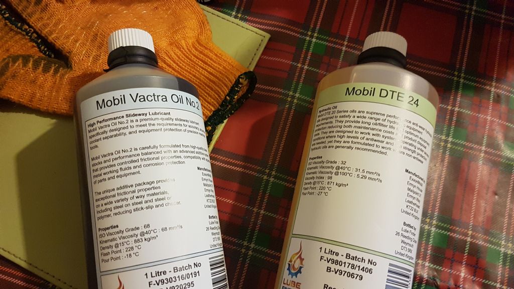

      Evenin' all,
      I have a mill arriving tomorrow and completely forgot to get oil for the ways and ballscrews. I have ordered some mobil dte 24 lite and Vactra #2 but it wont be here until wednesday/thursday and I know I wont be able to wait until then to play so out of the following which would you use temporarily for a couple of days if you absolutely had to:
      1. engine oil 10w40
      2. 3 in one oil
      3. chainsaw oil
      4. rapeseed oil…. stop laughing
      5. olive oil…. please stop laughing
      6. white lithium grease
      Think that's all i have in the house.
      Cheers
      Mark

        #441966
        Grindstone Cowboy
          @grindstonecowboy
          I guess the chainsaw oil would be best, good and sticky, but liberal applications of the 10W40 would also be OK, but a bit more drippy.
          #441967
          Pete Rimmer
            @peterimmer30576
            Just use the engine oil. You won't wear it out in a day.

                  #442037
                  Shent
                    @shent
                    Thanks all for the responses, engine/chainsaw oil it is then.
                    Cheers
                    Mark
