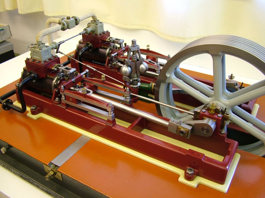

All,
As discussed elsewhere, my second ME project after building a Stuart 10V will be their Twin Victoria.
Since I've not started it yet – it will probably be early next year funds permitting – I didn't want to start a "work in progress thread", but I will do once I make a start.
I thought I'd start this thread to keep all my questions, and people's advice, in one place. From my "which second model?" thread, I've concluded the following:
* I will buy just the main castings, and brass/gunmetal extrusions etc. from Stuart, the rest I'll source myself, and hopefully save some cash.
* As suggested by Jason, I will fabricate the beds out of aluminium, modified slightly to omit the un-used bearing pads. I've not decided whether to machine casting draw on their sides yet, or whether to add a step around the bases.
* I have sourced all the fasteners, although according to the images on the BA Bolts website, the terms "bolt", "set screw" and "part threaded" aren't clearly defined in terms of which type is available in which size. I know the difference between a "set screw" and a "bolt", but not between "part threaded" and a "bolt". All a bit confusing; the images show a mix of types under "bolts". Of course I may have misunderstood their definitions. Anyway, I've found the threaded rod, and will buy lengths and cut to size. Same with some of the shorter bolts/set screws (or whatever they end up being!).
* I have a local materials supplier, and am awaiting his price for all the stock materials.
* I have already bought the Stuart plans, and have the parts list.
* The model will be mounted on a hardwood base, and possibly only ever be run on air.
* I'll go with Ramon's suggestion of bronze pistons with PTFE impregnated yarn rings.
* I'll try to reduce any drawn Bright Mild Steel in size symmetrically to avoid too much distortion, although I notice that the upper crosshead guide bars are tapered on their upper faces from nominal stock size. Can't be much of an issue presumably. Likewise the connecting rods are turned from square, leaving the angular ends. Presumably turning in this way wouldn't be much of an issue becasue they are symmetrical (bulged in the middle), or would distortion in-process be a potential problem?
So on to some other questions (there will inevitably be more):
1) Is it worth getting the Stuart book on building the Victoria (or are there any other relevant books I could request for Christmas)?
2) I'd like to add a governor, but am aware that they are not easy to get to work effectively at this scale. The Stuart governor kit appears to have linkages that imply it works – is this correct? Even if the governor wouldn't be functional in terms of controlling speed, I'd still like to include one, with operational linkages that perhaps feed into dummy valves. I like the look of the governors on a separate central pedestal – Jason mentioned a "Princess Royal" version, but I can't find a reference – are there plans for this type? I'd also like to use a shaft and bevel gear drive, I think the spring band drive looks a bit Mamod.
3) I'd like to add a few details like railings, which isn't an issue, but are there any other details I could add, such as perhaps a feed pump, or mechanical oilers? If so where can I get kits or plans for them?
4) Bearing in mind it will be run on air, is it possible to add oilers with isolation taps to the valve chests (or somewhere else) to lubricate the valve gear and cylinders?
5) Does anyone have reference images of real-life twin cylinder mill engines as inspiration for perhaps adding a few other details?
