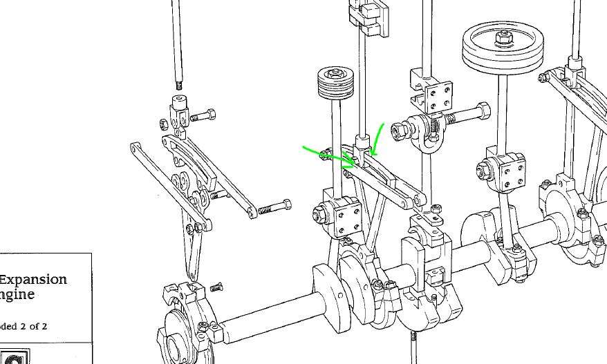

      I’m in the close to final assembly stages of my Stuart triple build, and have hit a snag I haven’t been able to figure out. I’m going to use the component terms supplied by Stuart as I attempt to explain my conundrum.
      When the drag links are assembled, they cannot pass the little 7BA fastener that holds the steam chest valve rod to the reversing eccentric..they need to be spread out more, for lack of a better explanation. The parts are build to the drawing, but there is absolutely no way that I can see it would work without either making new drag links with thicker offsets on the ends, or making small spacers to space the drag links apart so they won’t contact the cross-head bolt that goes through the eccentric.
      I’ve looked at a bunch of pictures, have watched Keith Appleton’s videos and I see nothing obvious other than the drag links in those pictures have thicker spacers on them. My print sheet calls out one end at 3/16″ thick and the other end at 5/32″. The item I’m blabbing about is #31 on my print sheet, which is dated 1981.

        Hi Stuart a picture of your engine would help.
        David
        #719485
          Would reducing the bolt head and nut height help.
          Snip of the drawings for others to see the point of contact
          clash

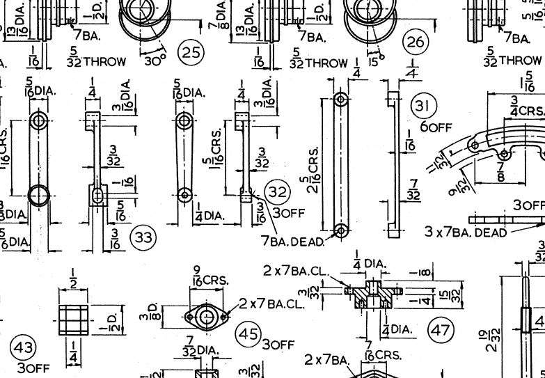

            Thank you for those comments, I’ll try to post a photo. As an update, Andy from Stuart Models replied to my questions and stated the drawings I was working off of were from ’77, and the updated drawings indicated the ends of the drag links should be 1/4″ and 7/32″ on the ends versus the old measurements of 3/16″ and 5/32″. Making small spacers seems like a fiddly pain so I’ll just make six new drag links with adequate end dimensions to clear that cross-head bolt.
            Jason’s comment about reducing the total length of the cross-head bolt is valid, but for some reason, in my case it would result in almost a total loss of the fastener, and thanks for posting that drawing, that’s exactly where the problem is.
            Stuart
            #719564
              Ah it will be a bit tight with those dimensions, should be OK with the new as below, I was thinking your figures were after the 1/16″ had been deducted.
              drags

                Jason,
                Thanks. I’m actually going to make the dimensions fatter than even the new call out, just to make some comfortable clearance between the moving components.

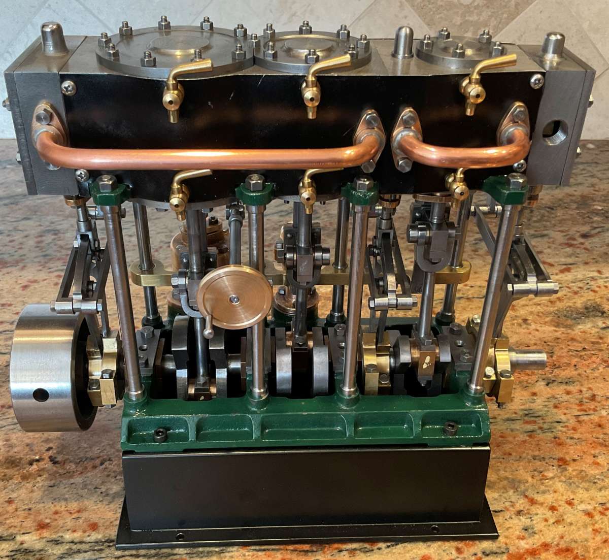

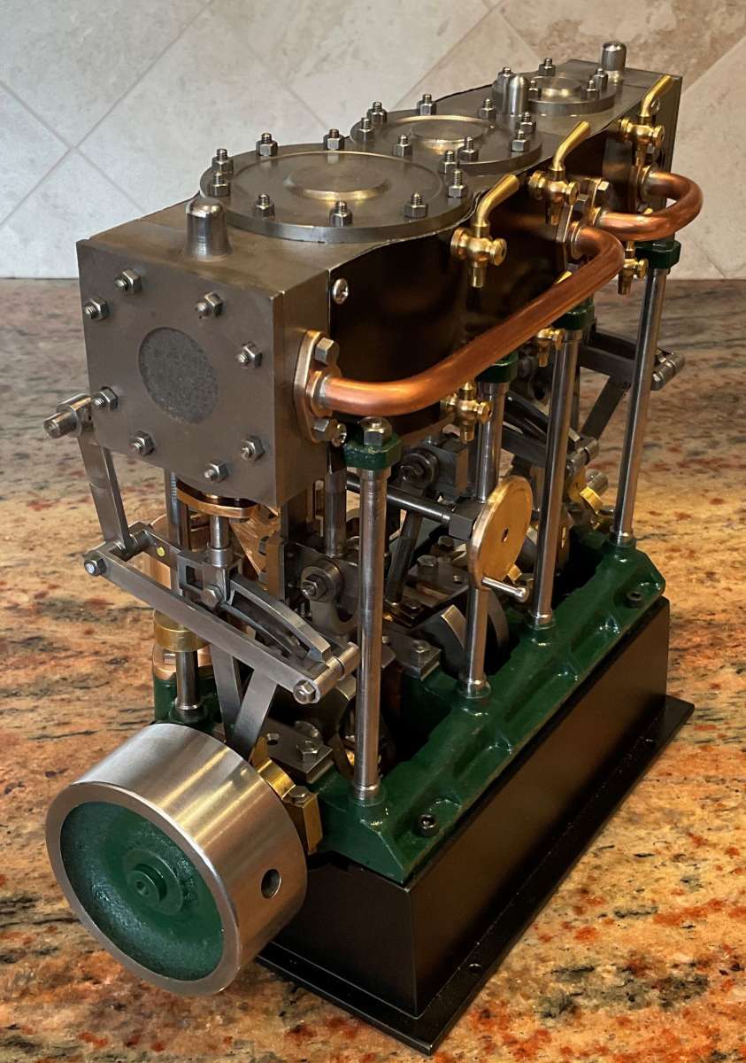

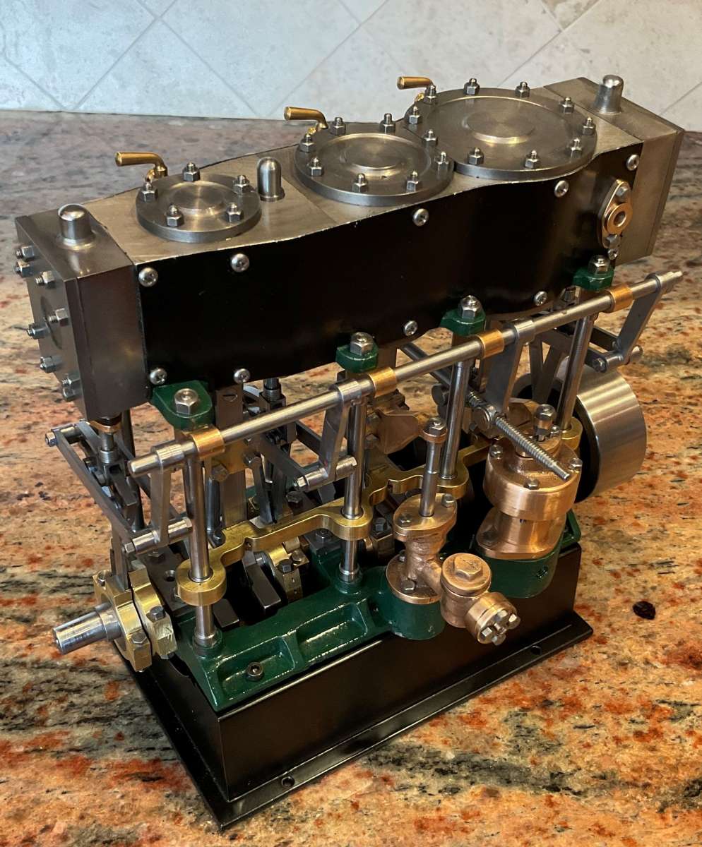

                    Gentlemen,
                    I modified the drag links and nuts and bolts and now all is good. The engine is finished, runs both directions nicely, albeit using only the HP cylinder on compressed air, but that’s fine with me..I’m not going to run steam. I’ve included some pictures of the finished product and I hope the images aren’t too big. There is a wood base, freshly lacquered sitting in the shop that will be added when it dries. Although the engine is not perfect, I’m happy with it and am proud of how it turned out. I started the project in 1981 and it only took me 43 years to finish it…wow!
