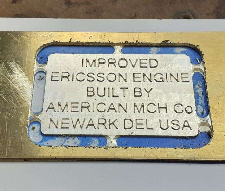

        Wal Werbel
          @walwerbel59154
          I also CNC cut thin sheets of brass and alu, quite often I need to run a round-over end-mill along the edges, so flatness is important.
          I screw down 18mm MDF to my bed and surface it.
          I then apply 50mm wide 3M masking tape to the back of the plate and also to the freshly surfaced MDF (dust removed, obvs).  Super glue then applied in thin beads along the lengths of the masking tape, plate positioned and weighted down using another flat bit of MDF along with several 20-odd-kg handled weights (shown in the last pic aiding a wood gluing effort).

              Wal Werbel
                @walwerbel59154
                Indeed – Valchromat is lovely, but I haven’t been fortunate enough to have any larger offcuts come my way.
                Metal to metal before boiling off works great when you need a stronger bond, ie. for milling fiddly shapes where a lot of the glued area gets removed.  Just don’t glue over any screws that you may need to get to in order to remove the sacrificial bit of metal – that ol’ chestnut I know so well…  😂
                OR direct (no tape) to hardwood worktop off-cuts like in the image below – once done you can dab on acetone which will degrade the super-glue and let you release the work without needing to use too much force.

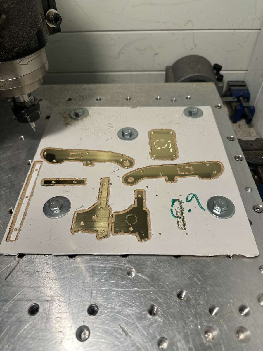

                    Steve355
                      @steve355
                      Sorry, video was too big to upload , even when I made it small. Pic below instead.
                      I have tried the superglue/ double side tape approach in the past and it would not reliably stick. Perhaps it was the substrate I was sticking it to – which was probably
                      Imagine doing several of these a day… I thought it would be easier to drill a spoilboard and the workpiece and bolt it on. No tape to put on or clean off etc.

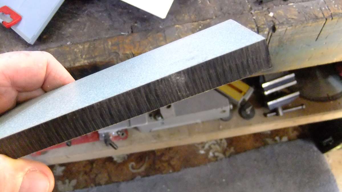

                      Dalboy
                        @dalboy
                        For many jobs I use the dividers from toilet cubicles (Washed first) It is about 1/2″ thick and very solid and does not bend easily. That is if you can find somewhere they are refurbishing some. Mine came from a school; that was having work done.
                        It machine well as I have just made a part from it.
                        DSCF4278
                        The cut edge was done with a circular saw
                        DSCF4280
                        DSCF4279

                          So what is that board made from? Is it a solid perhaps plastic impregnated wood, or a good quality board with a thick plastic layer? Is it machinable – I’m thinking other uses really.
                          #798799
                            CGL Compact Grade Laminate, think of thick Formica and you get the idea

                                  Right, I had another go at this today. I bought a plank of MFC from Wickes, and drilled it for mounting on my CNC bed.
                                  I realised that previously I had used double sided tape rather than the masking tape and superglue method. That worked really well.
                                  Plus I cut the O1 dry, which worked very well.

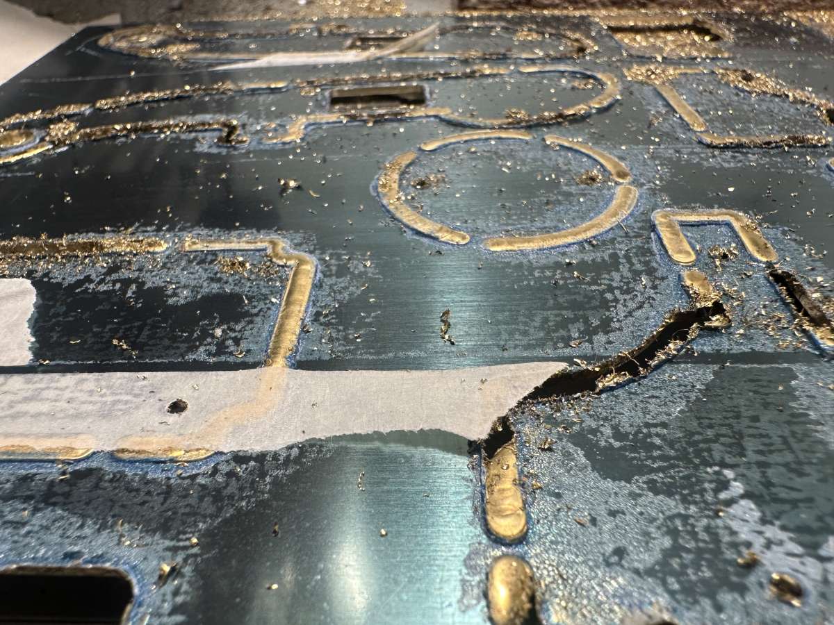

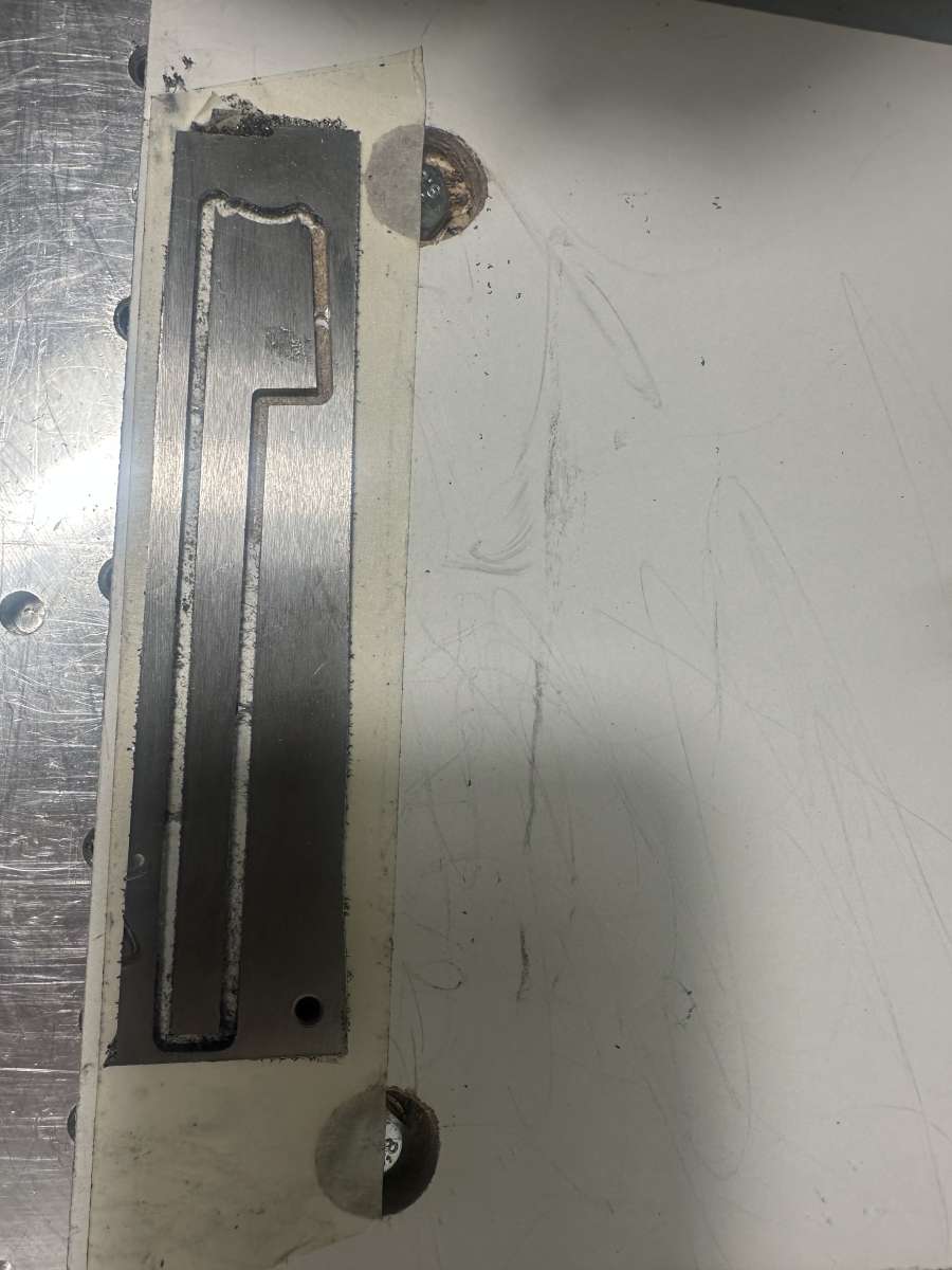

                                  Steve355
                                    @steve355
                                    Just coming back to this topic after more failure.
                                    I’ve done this quite a few times (tape & superglue) and it has worked ok. But the problem is, burrs on the underside of the brass are approx 1/2mm thick and cause the brass plate to delaminate from the spoil board. Once even slightly loose, the problem gets quickly worse.
                                    It may be a way to deal with a single profile on a sheet, but when there are many, I’m not convinced it is practical.
                                    IMG_5531
                                    #804344
                                    John Haine
                                      @johnhaine32865
                                      What grade brass are you using?  I profile 1.6mm engraving brass with no problem and little burr.  I only just cut through the metal by 0.1mm or so.  “Softer” brass I can imagine would burr badly.
                                      #804347
                                        You also want a sharp cutter, if it is throwing up an excessive burr then chances ar eit ha slost it’s edge. Ones for nonferrous metals also help.
                                        As John says the softer more golden looking brass is not as nice to machine and I would only use that if I wanted to subsequently bend it.
                                        #804352
                                        Steve355
                                          @steve355
                                          Hi
                                          Brass is CZ108 0.9mm. True, the cutter is probably dull – been using it for a while including on O1.
                                          I can’t do much about the brass – I have a small pile of it. But I can change the cutter.
                                          I wonder if the spoil board is an issue. It is 1/2 inch MFC, which is quite rigid and I don’t think gives much if pushed. I moved away from softer chipboard, perhaps that was a mistake.
                                          New cutter then.
