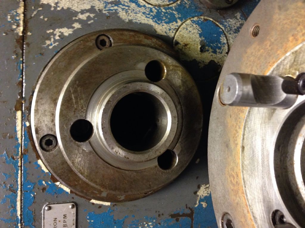

        image.jpgI have a MK practical 1550 lathe & I need to centre the tail stoke to the centre of the spindle, I have taken the chuck off & taken a measurement @ the end of the nose 44.25mm & at the back it tapers down to 43.25mm. In the manual it words Spindle nose D1-4" or A2.4". Nose MT3 bore 1-5/8" can any one tel me the correct size for a tapered centre for this size taper please. Rob

          Think you have measured it wrong.
          It is a D series camlock and if the book says D1-4 probably is but a D1-4 if 63.5mm at the largest part of the taper.
          No D series is 44 odd mm

            Yes point taken, but the Manuel gives 2 figgers A2.4" as well, so could ether be fitted? what is A2.4" ? And it states 1.5/8" I measured it with a bore gauge.

              Read the bottom of this page.
              You measure across the tapered register, not the bore. The bore size has nothing to do with the chuck.

                    Rob if its a D1-4 spindle nose it's 100 to 1 that you need a number 5 morse taper sleeve to reduce down to a 2 or 3 MTcentre

                        The size given at the end of the spindle matches up with a No 5 Morse but the inside measurement doesn't.

                            MT5 taper is 44.399mm at gauge line with a taper of 1:19.002 as given here.

                              Don't you need to know the axial separation between the 2 diameters as well? You could have a stub version of a standard taper.

                                These taper bores are generally machined with a relief inbetween the taper at the front of the spindle and the remainder of the taper further into the spindle, completely unlike the taper in the tailstock barrel which is a continuously machined taper from front to back.

                                  Sound like it's an MT5

                                    Note that for D1-4, the diameter of the (external) conical taper is 63.5mm. If it measures 54mm, it's a D1-3. The Bantam also has an MT5, so clearly it's used on machines with both D1-3 and D1-4 and different spindle bores.
                                    The critical dimensions for the MT bores are presumably the major diameter and the taper angle. Whether or not the bore extends the "full length" matters less.

                                        Hi Murray" it's 44.25 not 54. D1-3 . it will be a chuck size D1-4 = 63.5 mm buts that's the OD of the spindle. I'm ID.

                                                      You asked what I meant by a stub taper – well it's simply a standard taper but cut short, about half the normal length, keeping the same angle – the small end is removed leaving the larger end. The reason for doing this is that you still get the benefits of using a standard taper, alignment and drive, but it allows a greater through bore size on the machine spindle without having the make the OD of the spindle larger to contain a larger taper size – economics!
                                                      The sizes that you quote would strongly suggest MT5 from the open end, but the smaller diameter you quote is way above the small end of a MT5 taper – but a lot smaller than the small end of a 6MT. So you've something between the two.
                                                      Now to positively identify the taper in the absence of a male MT5 you will need to measure the axial separation between the two diameters.
                                                      I have the same issues on a lathe I have, badged as an IXL Leader and with an IXL bed (lathes.co.uk) but the headstock is a Colchester Master – re-badged as IXL. That has a short taper in the spindle, but even more fun it's was it know as a MT4.5 ie part way between the 2 standard sizes – try finding that in a catalogue!
                                                      Your best bet is to borrow a male MT5 taper of some sort, blue it up and check the fit in the spindle. If the fit is OK at least you know what to look for. If not then it's head scratching time again. Your lathe is of Indian manufacture I believe so I would hope that they've used standard Morse taper angles but there are a host of other standard tapers that it could be, the most common other candidate being the Browne and Sharpe, but the larger diameter doesn't seem to coincide with any the the standard sizes there.
