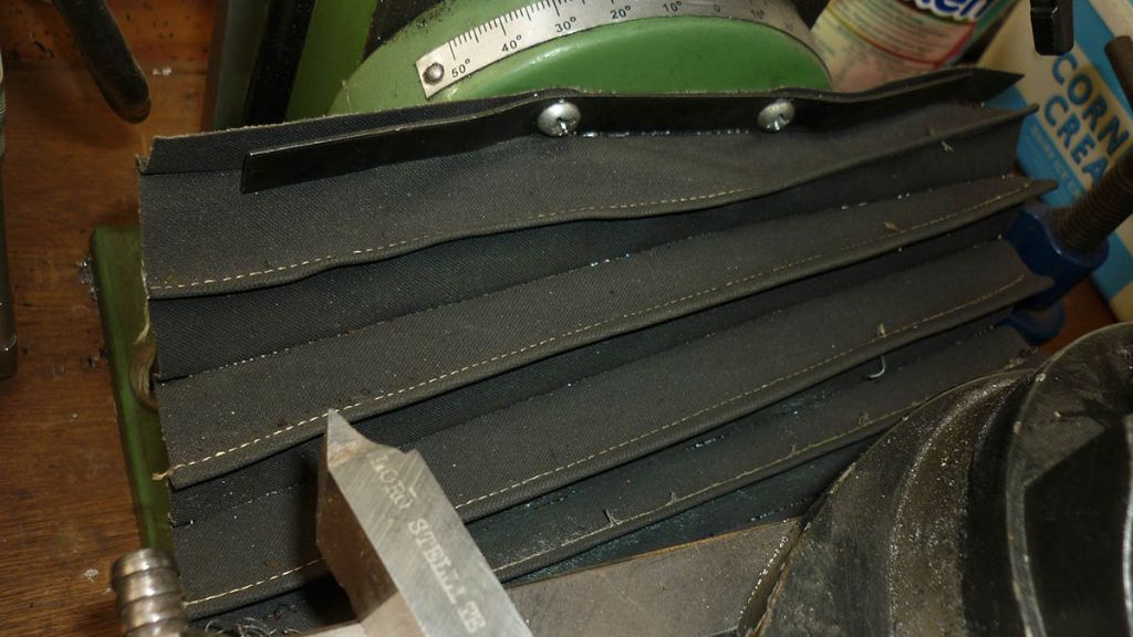

                      When the rubber cover on my small warco mini mill fell to bits , i made these up of rubberised kevlar sheet bought off a supplier on ebay ,stitiched on a sewing machine using kevlar thread. Tuff as hell and does the job .

                              That looks like a bullet-proof solution

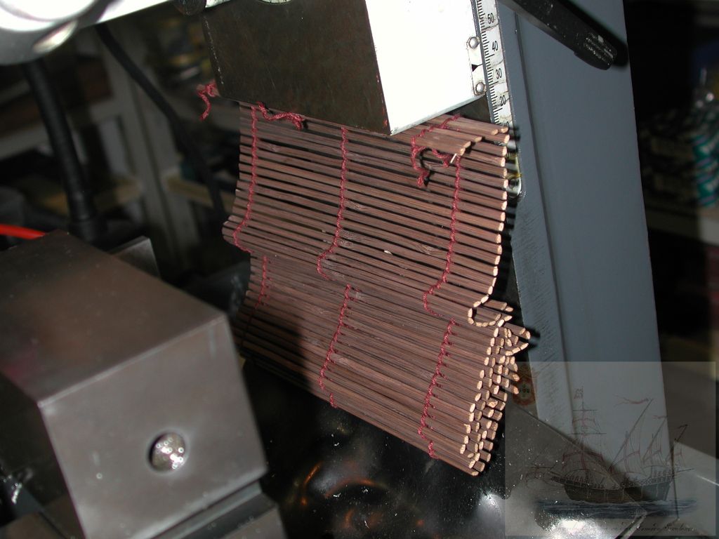

                                Good morning to all.
                                After the original protective bellows has disintegrated by the action of the oil, and while not applying new bellows, a small panel cut with scissors from a curtain of chopsticks plays a good role, is easily replaceable and very cheap.
                                I fastened to the panel, at three points, a wire guide that runs on the slides of the router.
                                You can see more images in my album.
