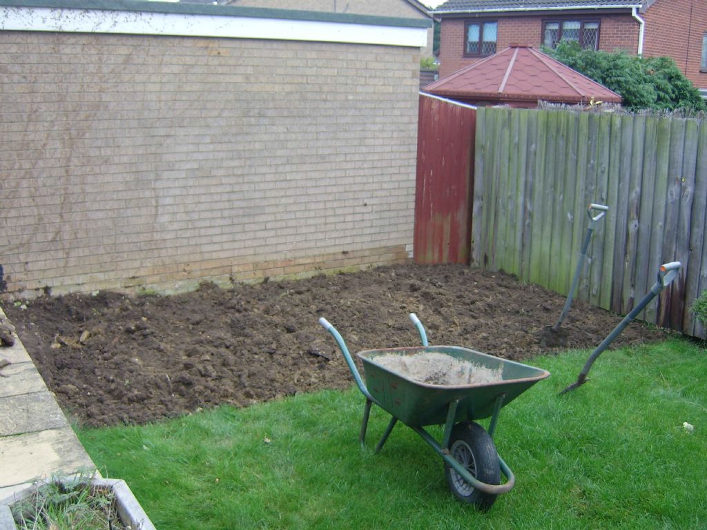

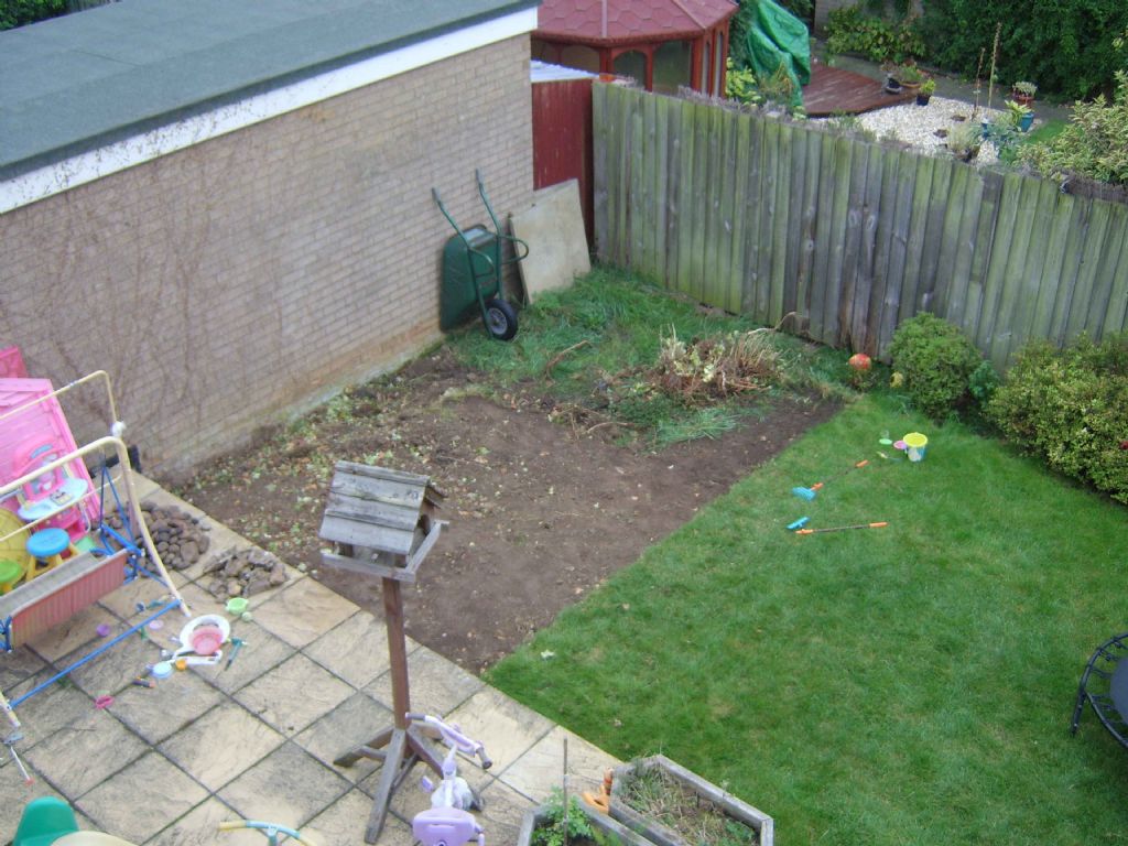

                                            Well got stuck into this today
                                            A few weeks ago I began
                                            and then today I spent five hours digging it over and then wielding a sledgehammer to break up some concrete for the hardcore
                                            I am now bloody knackered and in need of a hot bath and a single malt !

                                                  You really need to get rid of all that topsoil if you are putting down concrete. The biomass inherant in topsoil will break down over time and shrink leading to cracking. I'm afraid digging over is also a bad idea as it is just loose stuff now which will take ages to compact. The bottom of concrete needs to be flat as embedded hardcore acts as a stress raiser. That's why building groundworks are finish dug with a flat bucket not one with teeth that would tear out the bottom of the trench.
                                                  #133095
                                                  John Coates
                                                    @johncoates48577
                                                    Bazyle: I dug it over to make it easier to work. Next stage is to put the boards in to delineate where the edge of the base will be. Then I will dig out within the boards to establish the datum for the hardcore and thence the top of the base as the finished height of the shed must be 2.5m to comply with planning. Before the hardcore goes down it will get flattened either by whacking with the spade or stomping over with hard boots.
                                                    Thanks for the info tho'
