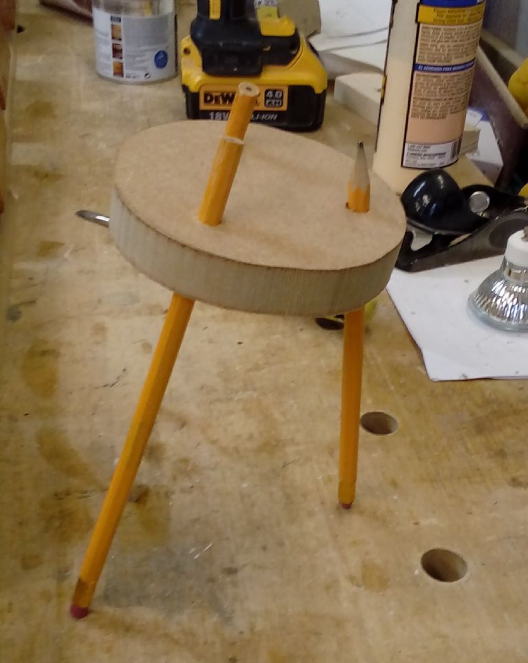

                  I'm inclined to agree with JS on this one that in this particular use having 3 screws will not make things anymore stable than 4.
                  Taking Michael's 3 legged stool as an example if we were to shorten one leg then the stool will just tilt until all three legs touch the ground due to the downwards direction of the forces on the stool. So the stool is once again stable.
                  Now take our Gript-tru or Hemmingway item, if one of the screws was slackened off the chuck will then only be resting on two of the screws or even one depending on what position the screws are in , fail to retighten the third screw or even not tighten it with the same torque as the other two and the part is unstable, same as if you had one jaw of your 4-jaw looser than the others.
                  Infact the stool can reach a point wher even with three legs it will start to become unstable if one leg were a lot shorter than the others therfore all the downward forces would be acting on the short leg until you get to the point where the stall will fall over.
                  J
                  Edited By JasonB on 24/02/2017 10:31:02
                  Edited By JasonB on 24/02/2017 10:35:09

                          As I said if one leg were shortened a lot then the stool would lean to such an extent that the mass would start to move beyond the base and then it will become unstable.
                          I know Michael's kinematic theory ignores forces but in practical terms we have the force of a milk maid on the stool and the force applied to teh screws to make the chuck move both against gravity and the friction from the main chuck retaining screws which are just eased off to adjust the chuck. So as soon as a force is applied to one of those adjusting screws things become unstable unless balancing forces are applied via the other two screws

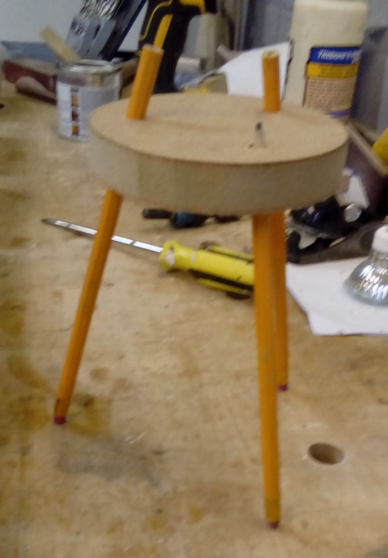

                                #285746
                                  Posted by not done it yet on 24/02/2017 11:36:23:
                                  IFthe milking stool was perfectly symmetrical (and built with the legs sufficiently spaced, as it should be), shortening one leg would never cause it to fall over (centre of mass would remain within the effective base). But if two legs were shortened by different amounts …. it would no longer remain stable in all circumstances – unless the legs were vertical and at the extreme edge. I think!smiley
                                  Well while waiting for another coat of lacquer to dry I thought I would test the theory.
                                  Nice stable stool with 3 equal legs on a slight splay.
                                  Shorten one leg ( thepointed one) and so far the stool is still standing but you would want to be a bit carful how you sat on it as more likely to tip to the right.
                                  Now as I said if the leg was shortened a lot then you will reach a point where it decomes UNSTABLE
                                  J

                                    #285753
                                    Martin Kyte
                                      @martinkyte99762
                                      Yes Jason but if you bolt the stool to the floor it is unconditionally stable.
                                      regards Martin

                                        That is more like a BAR stool than a milking stool. A good milking stool would bump on the rim before falling over.
                                        Made by someone who has clearly never milked cow from a stool. I have, btw, on very numerous occasions. One side was always made, or worn, shorter so that one could 'lean' in towards the cow. You also need to be fairly low down to reach her teats. Small pails were used for two good reasons too!
