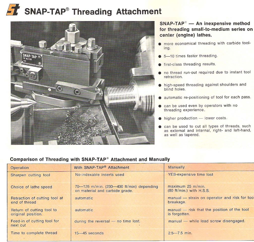

      Do you know this threading attachment ? The tool is stopped and withdrawn just before the shoulder. This attachment is almost completely contained on a toolholder set in the toolpost. It’s not as efficient as the “single tooth dog clutch” but far easier to make and few costumization is necessary, whichever lathe you use. The result is like the one obtained on a CNC lathe, the tool is withdrawn always at the same place, no circular groove is made!

        tool stopped and retracted against a shoulder

              This attachment was (is?) commercially available, called "Snap Tap" from a Swedish company (now Seco tool I think).

                    jacques maurel
                      @jacquesmaurel42310
                      Thank you to Bazyle for the links.
                      I'll give more informations on the snap tap attachment. in the following days. The principle of function is very simple but confusing. I've made my own attachment and discovered that there are many hidden traps in the conception. It's almost impossible for an amateur to make a copy of the genuine as no adjustement is possible. Here is a first photo:

                                        A near relative of the "Snap-tap" attachment has been descrtbed in "Model Engineer" (no photo, only sketches). Try to find in which issue!

                                        Speedy Builder5
                                          @speedybuilder5
                                          Looking at the photos from Jacques first post, how is the HSS tool held in place ?
                                          BobH
                                          #133529
                                          jacques maurel
                                            @jacquesmaurel42310
                                             The problem with this tool (15° rake angle) is that it must be of the spring type for the tool not to plunge in the work as the chip is very wide for the last cuts.

                                              You'll find a near relative of the snap tap in ME issue N°4177 (sept 2002) title: A high speed thread striking attachment. The problem is : what happens if the feeding force is more than the spring one?
