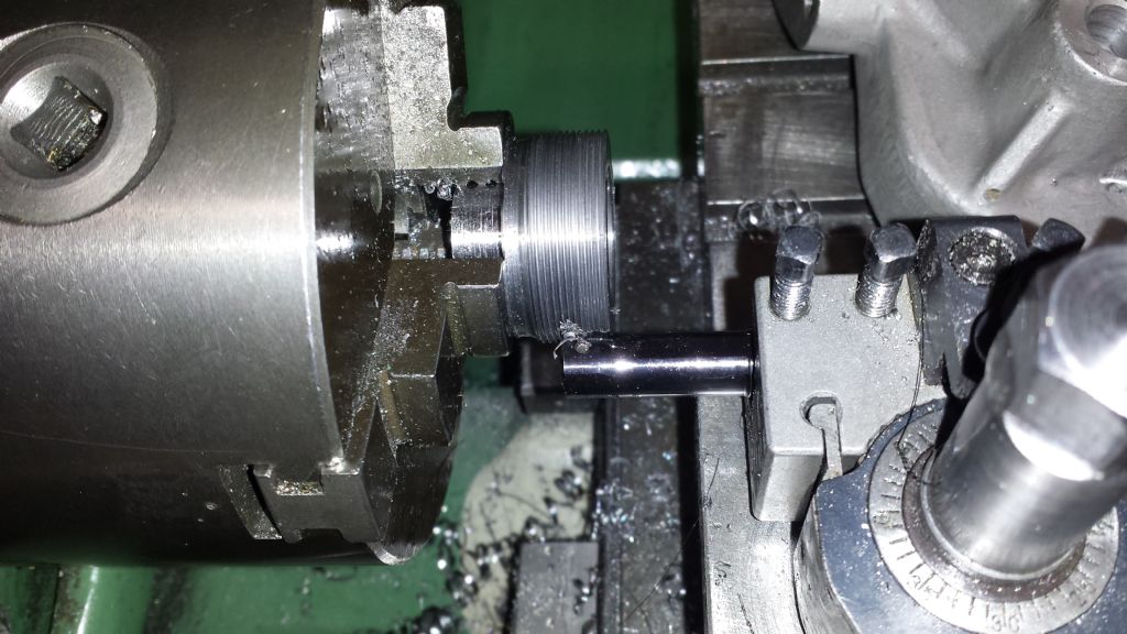

                                    #526383
                                    peak4
                                      @peak4
                                      Jason's is one obvious solution with a collet in the taper, directly or via an ER chuck or similar, but what sort of conventional chuck do you use?
                                      My method precludes the use of long bar stock but seems to work well enough>
                                      My 4 jaw is a Pratt Burnerd style slimline, fitted to a separate backplate.
                                      The hole through the backplate is a smaller than the hole through the throat of the chuck, so I just add a washer and some threaded rod as a draw-bar.
                                      For my Griptru, there is a gap between the front stub/register on the front of the backplate, and the back of the internal recess in the chuck.
                                      Again I use a washer/draw-bar, but this time, I've modified the washer.
                                      I've tapered the outside diameter, as well as cutting a pair of flats on it that fit the threaded bore of the backplate.
                                      This means that I can slide the washer up at an angle through the threaded hole in the backplate, and then it catches and locates OK when squared up.
                                      Bill

                                      Howard Lewis
                                        @howardlewis46836
                                        If you make or buy a Rear Toolpost, you could use a normal threading tool, "right way up" with the lathe running inn reverse.
                                        You don't need a special "upside down" tool. As long as any tool is mounted with the cutting edge on the centre line, and has correct clearance angles, it will cut.
                                        Parting off is better with the tool mounted upside down in a rear toolpost., and the lathe running forwards.
                                        I have parted off with an inverted tool in a rear tool post for 17 years on this lathe and many with the predecessor ML7, finding it a less problematic method.
                                        HTH
                                        Howard
                                        #526421
                                        Nick Hughes
                                          @nickhughes97026
                                          An option I used:-
                                          The ensuing discussion was here:- https://www.model-engineer.co.uk/forums/postings.asp?th=142307
                                          Edited By Nick Hughes on 11/02/2021 15:35:07
