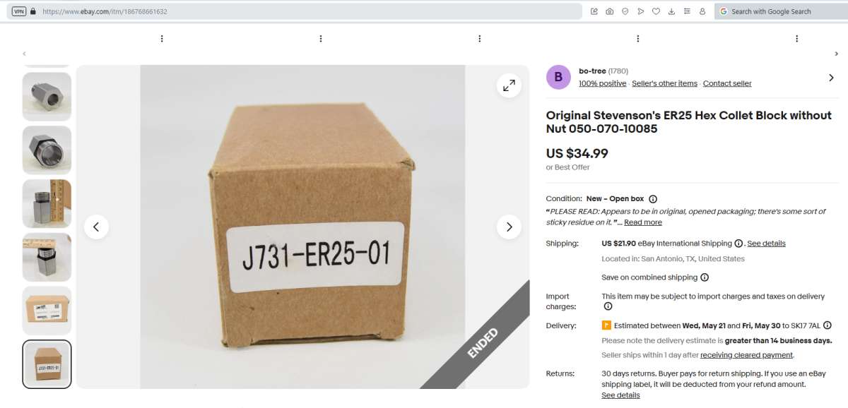

              #796162
              peak4
                @peak4
                See this old eBay description.
                https://www.ebay.com/itm/186768661632
                That number featured on an ER 25 collet block set.
                image_2025-05-02_170935287
                Bill
                #796178
                  If that is the case then a standard ER25 should fit. It does on mine but threads measure 31.8 for M32.

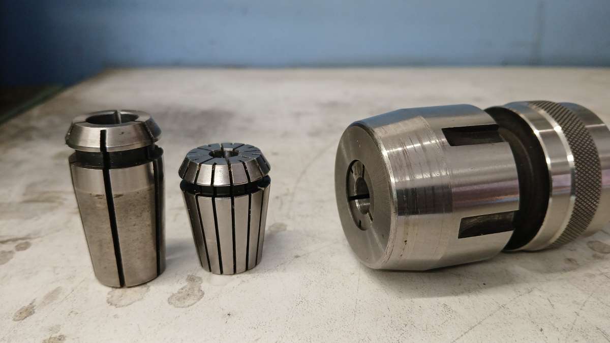

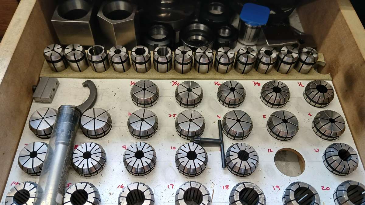

                            The money has long since been spent, they hardly get use dthese days as the ER32 infront see all the action. Also some ER25 and 16 stored elsewhere.
                            20250506_120325
                            Took a photo of one of these collets up against an ER25 so you can see the differences, holder on right.
                            20250506_120301
