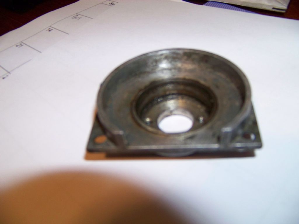

As Michael says a picture of the part might help, but as Clive intimates, heat is the one essential ingredient.
Depending upon what you are trying to do and its structure (which is why a photo might help) you may be able to make an extractor that will pull or push the bearing out. But even then, with old or fragile aluminium you need to heat things up. This, for example, is how one can remove Austin Seven main bearings from the aluminium crankcase.
Alternatively, if you can access the bearing with a brass drift – i.e. if it is not against a flange or lip – you may be able to knock it out. But again, heat is essential. Don't bash it cold. Old-fashioned brass stair rod may be suitable for the drift.
Try to heat the part to around 80°C and aim for generalized heat not local. A domestic oven is ideal for the purpose. In the Austin Seven context their steel hubs will give up their steel bearings quite readily when heated and you will probably be surprised how aluminum, once expanded by heat, will let go a steel bearing.
Good luck, just don't bash it cold!
