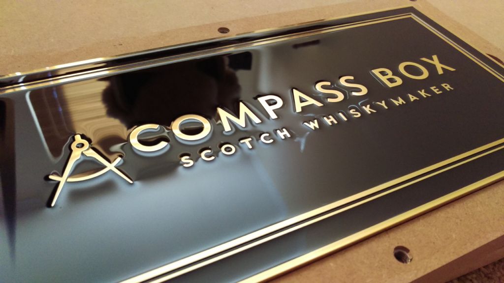

      Hello all.
      I have a project on at the moment which involves having brass plates coated with resin – here's an example of one I made some time ago, the current project is the same kind of idea.
      Compass Box
      Before the resin stage I need to polish up the raised details which means that polishing compound packs in to the letterforms and creates a whole world of ball-ache to clean up. I've managed to refine the clean-up technique to something resembling 'tolerable' but I'm stuck for what to use for a final wipe down. In the past I've used fairy liquid, a toothbrush, numerous cocktail sticks, and then hot water to rinse – seems to work okay, but I'd like to know that I'm doing the job 'properly'.
      Recently I read a self proclaimed de-facto explanation of how to prep brass for paint where the instruction was to use rubbing alcohol as a final wipe down. Okay, so surgical spirit (or isopropyl alcohol) then. But in many cases off the shelf stuff contains caster oil and will surely leave a residue and I'm not prepared to take that chance…
      Am I over-complicating this? Once visually clean do I just paint in meths to all the nooks and crannies and then hot water rinse?
      Many thanks.
      Wal.

                    Gorgeous brass plate in the photo, so the hard work method can't be far wrong!
                    I'd avoid Surgical Spirit for this purpose. Although mostly Ethanol and Methanol, a bunch of additives are added to make it undrinkable and improve its medical performance. Meths is cleaner than Surgical Spirit, but as pure Iso-propyl Alcohol is readily available I'd go for that.
                    Extreme cleaning is often multi-stage. I'd suggest:
                    1. Brush clean in hot water with detergent, followed by water rinse to remove the bulk. Or perhaps a pressure hose.
                    2. Ultra-sonic bath with detergent to get into the nooks and crannies, plus water rinse to remove the remainder of the polish abrasive
                    3. Rinse in Acetone to remove oily residues. (Unperfumed Nail Varnish remover might be clean enough.)
                    4. Rinse in IPA to finish off by removing Acetone residue and any additives left behind by the detergent.
                    Not all steps may be necessary. Much depends on what's in the polish and detergent.

                              So after further reading and taking into account advice given here and my own travails to date, I'm going to go with the following method:
                              1. Polish as usual
                              2. Use a detergent to clean off the polishing residues
                              3. Rinse
                              4. Use 99.7 pure isopropyl alcohol (RS do 500ml for about a tenner) to clean off detergent residues
                              5. Rinse, dry and buff
                              I just don't think there's a way of avoiding detergents and the related surfactants when it comes to cleaning up the black polishing residues that get into the tight areas of detail. The pure IPA should be the final word on clearing off the surfactants that are left behind by the detergent.

                                                      Just thought I'd post back with a bit more on how this has gone / is going.
                                                      Post polishing, the plaques look like this:
                                                      This is a rough vid describing the clean up stages (soap/rinse/alcohol/rinse):
                                                      From there the plaques go straight into new plastic bags and won't be touched again until they're up for paint.
                                                      Water lies evenly across the floor of the recessed areas after the alcohol has been rinsed off, so should be good.
