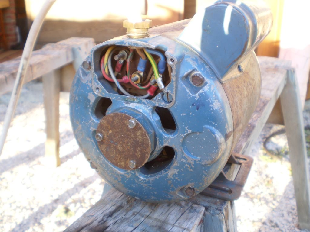

              Brian, I don't know that I can answer your question. The plate:-
              Crompton Parkinson Doncaster
              A.C.Motor BS 170 69H Insl Class E
              BS Frame No VPA 5643A
              BHP (I think 0.75, but plate is well scuffed up.
              RPM 1425
              Volts 220 / 240
              Amps 5.4 (May be 5.1)
              PH 1 Hz 50
              Rating CONT.
              BobH

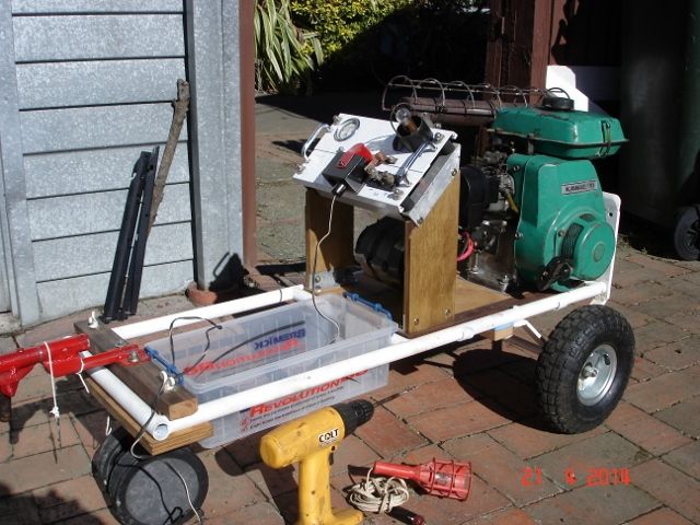

                                                      My home brew portable gen set uses a 3hp Kawasaki motor to a car alternator, and I can get about 500Watts out of it, I have an inverter for it, but I'm yet to try it on the fridge. The base that the unit is sitting on doubles as a sack barrow, and is rigged as a trailer to be towed by my bicycle. I can boil enough water for a cupper in about 20 minutes
                                                      Ian S C
                                                      Edited By Ian S C on 18/02/2018 09:28:19
