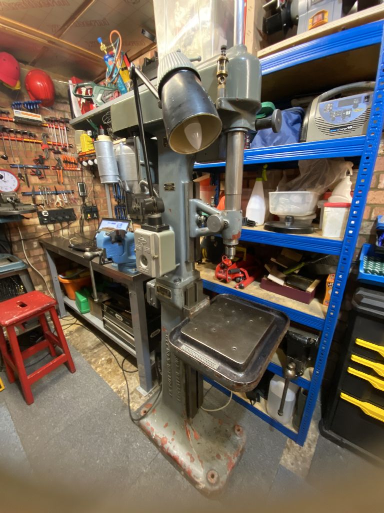

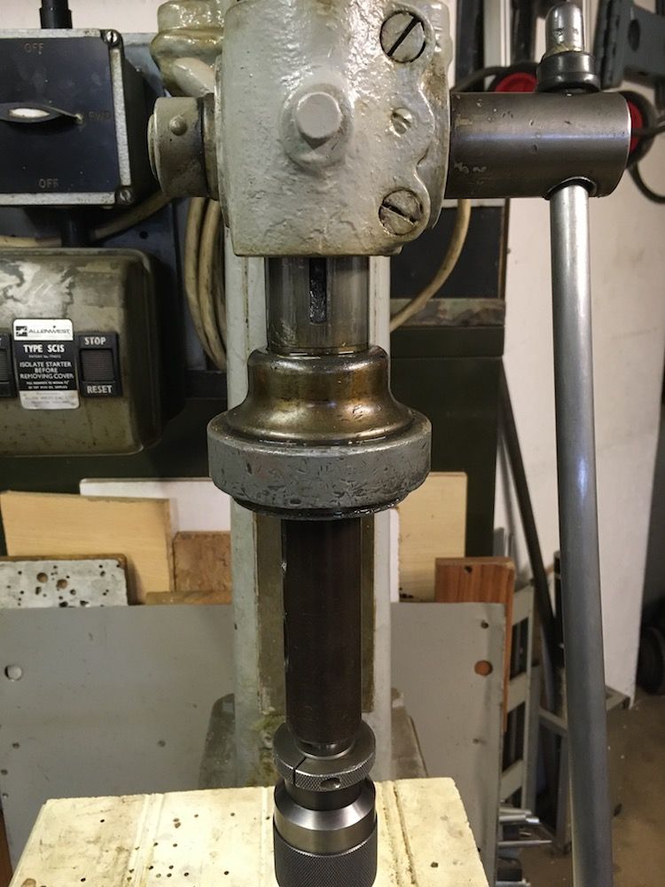

      Hello all, I have not posted for a while, I appreciated the information I got on my wee Hobbymat lathe and since then I bought a bit of a basket case Hobbymat mill which I have restored to working order and now working on making a mill base for it which is going well.
      But, I am looking for some help on getting any information on my not that recently aquired Pollard 12 AX, does anyone have any leads to getting a user/parts or service manual for one of these? – or the FX as it is basically the same apart from the pedestal. I did get a reply from Tony at lathes.uk but they only have the 13AX which could be very different unless anyone know otherwise.
      Apreciate any help.

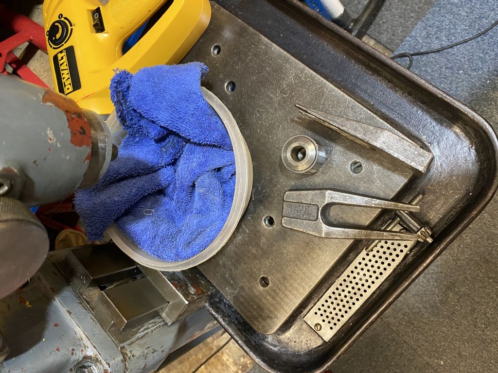

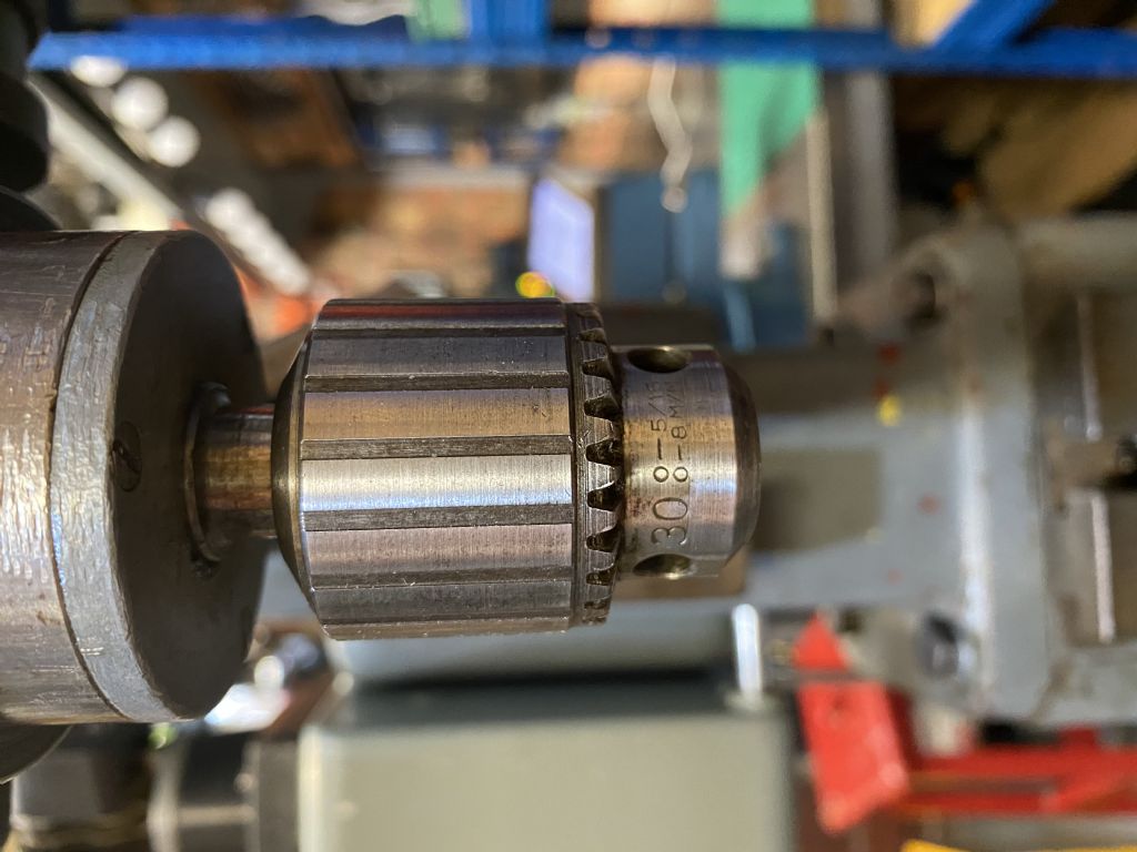

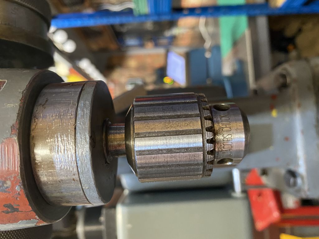

            Thanks a lot Clive, appreciated, I will post tomorrow on some basic questions re the J2 chuck and some photos.
            I want to know how to get it out without damaging the chuck or the arbor and if the spindle would accept an MT2?
            Cheers Chris

              Just realised it's a Corona – the spindle nose has a male Jacobs taper machined directly onto to it, remove the chuck using taper wedges – My example used a JT2 taper (if there's room to get calipers in, about 0.57 or so imm. above the chuck) – tho' I imagine they're all the same.
              The spindle in these machines is solid and of small diameter, so there's no room to fit an internal taper.
              There's a thread here with some info and pictures of wedges for chuck removal;
              Model-engineer – Jacobs chuck…

                Spindle diameter is probably insufficient for MT2 adaption. Minimum diameter for MT2 seems to be around 1 1/8" inches, 1 1/4" sounds safer. Yours is probably about 1".
                Picking up on the mention of Corona models by DiogenesII it looks like these, later machines, were fundamentally an update of your drill with muti groove vee belt drive, silly skinny looking thing, and a few, mostly cosmetic changes. The Corona 100A/1 I owned before I getting the 15AY was fitted with an MT1 taper in the spindle.
                Generally the Corona versions appear to have been for woodworking use with appropriately higher speeds.
                Pollards made a huge variety of machines and there is lots of commonality through the ranges. I suspect the sliding carrier for the quill & spindle assembly is the same as that used for the metal working machines with MT2 and, possibly, MT3 spindles. Easily checked by measuring quill diameter. If so it would be mechanically practical to chop the end of your spindle off and weld on an MT2 carrier.
                Something I considered for mine when frustrated by the inability to use larger drills. Plan A being to operate on an MT2 jump up sleeve.
                Never summoned up the courage to try! Sleeve is still kicking around here if you fancy a go!

                  It is confusing – if you do an image search for 'Pollard 12AX pedestal drill' a number of images turn up, a 1930's style massive CI-bodied machine that used flat belts – that's the machine to which I am referring.. .. I see a dark blue one, a light green one, and a single picture of a red one..
                  In the example I had, the business-end of the spindle is 5/8", the driven tail is 1/2" with opposed key slots that reduce the core to 3/8" – all driven by a sleeve of suitably modest dimensions.

                      Thank you for the replies, good info there.
                      Yes it is a Corona 12AX pedestal, quite a substantial floorstanding bit of kit, with the flat belt setup, the FX I think is the bench type of the same model. I have seen variations in pictures of the same model also.
                      That's a a bit of a blow on MT compatability, the idea of welding on an MT2 carrier is an interesting one, my MIG welding is as accurate as a scud missile so I would have to get that done by someone better.
                      The longer plan was to slow the machine down to be able to use bigger drill bits on metals. It has been converted to single phase and does work smoothly but I want to convert back to 3 phase motor with a VFD.
                      Are these J2 wedges still available? I would rather not wreck the chuck or the arbour for now as they are fine.

                          MSCDirect – Chuck Removal Wedges Set JT2

                                            In case it is of any interest re the JT2 wedges, a really nice guy has lent me a pair of "Smallbone" made wedges which worked a treat with just a few hefty taps either side. Meaty things, not like those weedy ones advertised on ebay which cost 25 quid each! the ones pictured are about 18mm at thier thickest and about 50mm across.
                                            Having googled the company https://archive.commercialmotor.com/article/27th-may-1966/93/wedge-extractor-tool I see that they made ball joint splitters -> so something like this could be adapted as they are 18mm down the inside which would fit – > https://www.ebay.co.uk/itm/154367635664?ssPageName=STRK%3AMEBIDX%3AIT&_trksid=p2060353.m1438.l2649

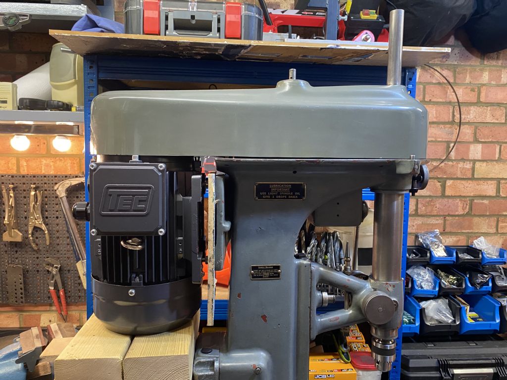

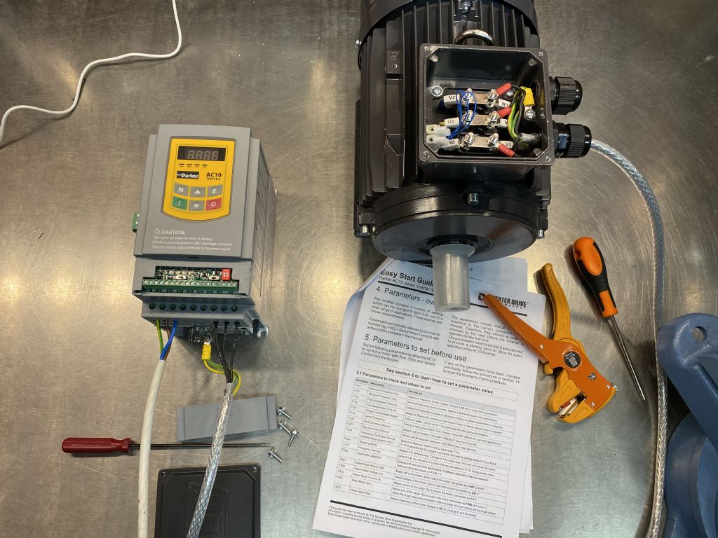

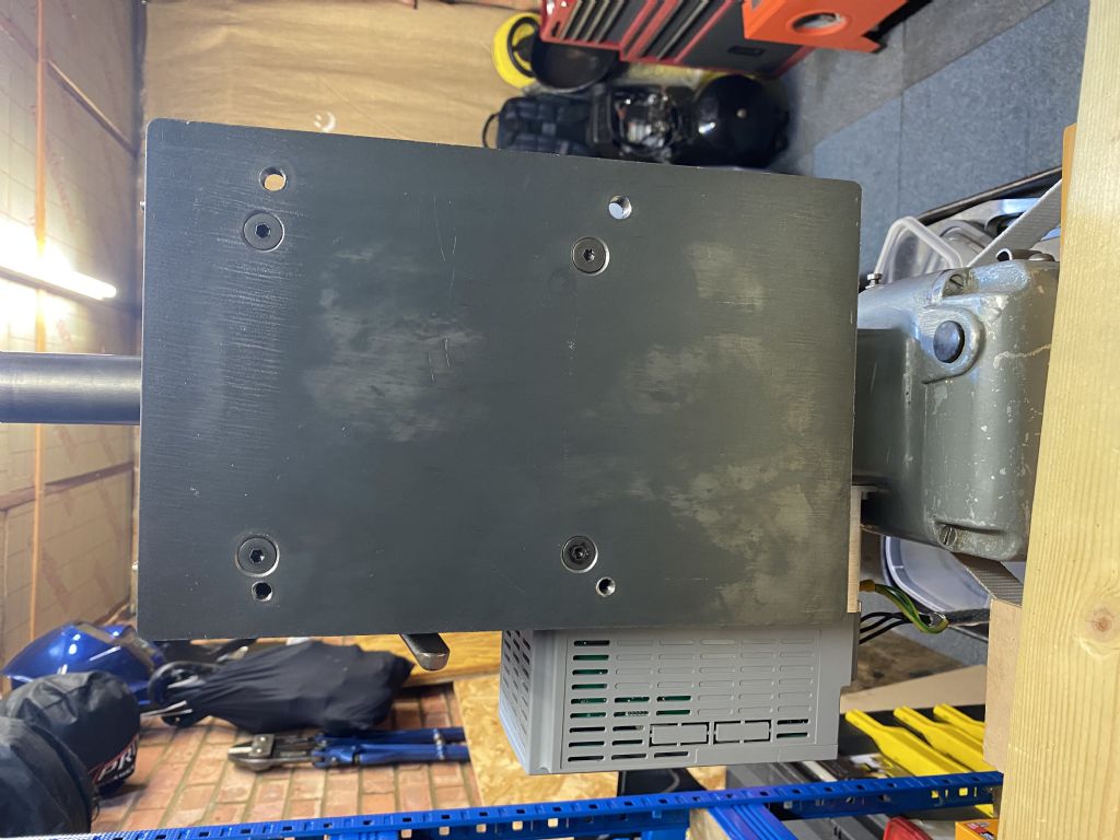

                                            #611090
                                            Chris Gragson
                                              @chrisgragson62922

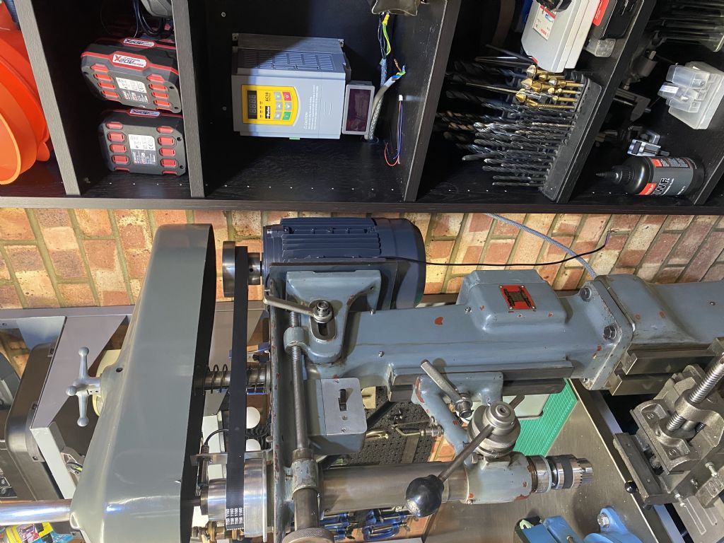

                                              Hi all, in the end I went 3ph & VFD which meant could keep the original pulleys, although the driven pulley had to be bored to suit the motor drive. I made a 10mm thick backplate to mount onto the OE plate which also does the belt tensioining, getting that central and height correct took some working out with MDF before I commited to cutting and drilling/tapping the plate.
                                              I needed to bring the motor closer than the woven original belt would allow or the hood did not sit right over the TEC 3ph motor, I could have cut and rejoined but went for a shorter belt from BB which was perfect.
                                              It's working great, left to do is a remote with reverse/jog etc and wiring up the tacho.
