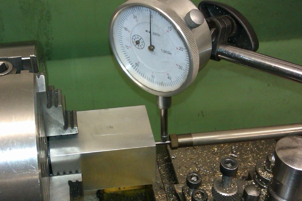

      HI guys, I've got to use a 4 jaw chuck for the first time soon so have been reading up on how to easily centre work… I found a reference to a simple looking tool called a Centre Finder Wobbler which has a mount you place in the tool holder, than a longish indicator bar which has a short end and long end with a ball mount in the middle – you carefully put the short end in the centre pop of the workpiece then as you rotate the chuck the long end wobbles about to indicate which way you need to tighten the 4 jaw – sounds much simpler than fiddling around with DTI's for irregular components….
      Can anyone ether tell me with I can buy something like this or share 'how to' plans so I can have a go at making one myself please?
      cheers. Jerry

          Could you tell us what the part is you wish to centre find as there are many ways of doing this. A piccy of item would be helpful

            Hi Bob, it's a very simple part – I'm going to be building an Elmers #25 Wobbler and the cylinder is bored into a rectangular block, with the cylinder bore off-set a little from centre of the rectangular end – so I plan to mark up and pop the centre of the hole, then mount the block in the 4 jaw (a bit offset) and drill/bore.
            cheers. Jerry

                  Easiest way is put the block in the 4 jaw chuck with center pop towards tailstock. Bring up tailstock and place another MT center on the tailstock center and the point in the center pop. The MT center will wobble as you turn job and you can by eye bring it into center very easily, then using a DTI complete the centering accurately. No need to buy any expensive one off tooling.
                  Clive

                    But my preference is a sprung centre they located into yout punched hole and the tailstock centre, this gives a round surface that you can then put a DTI against.
                    Firefly3
                    The spring keeps the tool in place as the work moves about unlike doing it with a solid pointed bit of bar, I'll dig out a drawing later unless someone else comes up with one.

                      Like Thor, I favour the sort which is supported by a centre in the tailstock, and using an indicator on the end near the workpiece. I made one; picture here. The cannibalised dart is soft soldered to the brass tube, with a spring between it and the steel rod to hold the device in place.
                      In no way is it concentric, but as the friction between the rear end and the centre is far greater than the friction at the pointy end, it doesn't revolve and concentricity isn't an issue.
                      After taking the pic, a 1" slit was cut along the side of the tube, to take a pin into the rod, so the thing can't fall apart. All very crude, but works a treat.
                      If making one like your sketch, consider mounting the long rod in something springy, like through the hole in the end of a piece of old hacksaw blade sticking out from the toolpost. That would save the bother of a ball joint. It does strike me that the rod, which might be rather slender and prone to getting bent, must be dead straight to line up properly with the tailstock centre. But why bother lining up with a centre? Simply adjust the chuck until the far end stops waving around in little circles. Then, a bent rod wouldn't matter.
                      Andy

                          Keep it simple. The accuracy is dependant on your abillity to place the center dot.
                          There is no point in having a fancy wobble bar and DTI if you can't place a center dot to within a thousanth of an inch.
                              True, if you want to put the dot dead centre in (e.g.) an existing finished diameter. But if you are leaving that until afterwards, a dot which is few thou out won't matter, will it? Surely the idea of these devices is to enable the chuck to be adjusted to get the dot centred..

                                Andy say you wanted to machine an eccentric with a throw of 0.188" you would put the dot 0.188 from the center and pick that up so the placement/throw of the eccentric relies on the accuracy of the punch mark, thats when an optical punch comes in handy.
                                Or when there are more than one centre on the same item such as this its all down to the placement of the punch mark.
