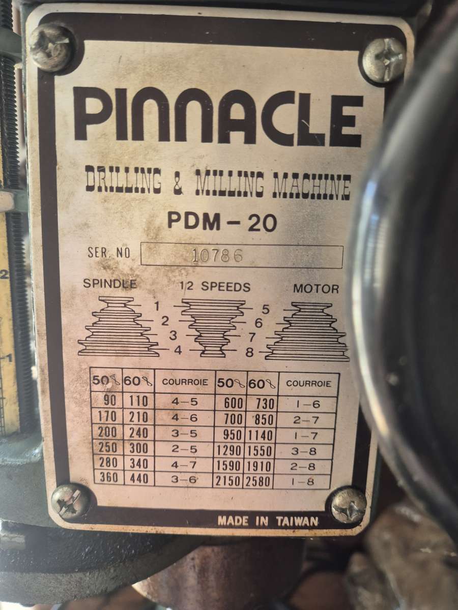

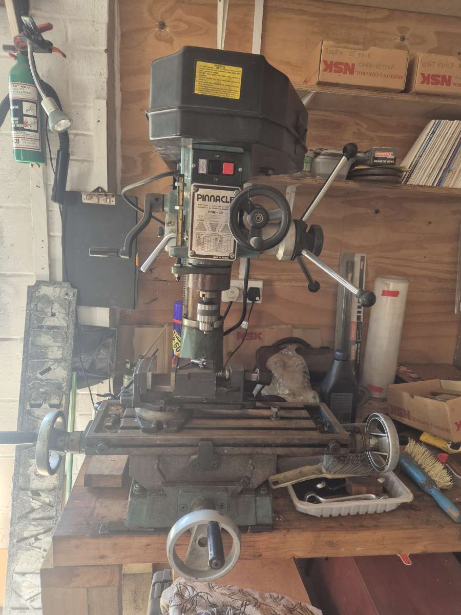

      Can anyone let me know what the value is of a pinnacle milling machine please
      20250522_14213220250522_14213920250522_14212520250522_14212020250522_142158
      #799260
      Andrew Tinsley
        @andrewtinsley63637
        Depends on condition. I would not pay more than £250 for one as they are not exactly the most desirable of machines.  Others may disagree!
        Andrew.
        #799272
        Bazyle
          @bazyle
          They do not get a lot of wear as they are only used for hobby work but do suffer cosmetic (rust) deterioration. Good machines if you are not trying to hog off cubic inches per pass as if it were a two ton industrial machine. Often appear on ebay at around £750 which would be about half the inflation adjusted new cost.

            Three sizes, this one is the smallest. Also sold as the Warco Economy in the 80’s. It needs a collet chuck to mill with.
            #799361
            Howard Lewis
              @howardlewis46836
              It might be a look alike of either the Warco Minor or Major.
              It certainly seems to have the same speeds as the Economy, but the same pulleys may have been used on the larger models.
              They were available in Imperial or Metric forms.
              Comparing specifications, (Table travels / size) may make identification easier.
              Presumably 3MT spindle, and 3/8 BSW drawbar?
              Although it is a round column machine (with the inconveniences that that brings), as long as it has not been abused, damaged or neglected, it could still be useable machine.
              Howard
              #799403
              Diogenes
                @diogenes
                I thought (that underneath the grime) it actually looks like a nice unmolested machine – look at those virginal screw-heads, and the paint is still on the handwheels.
                Whilst they came in many variants, Taiwanese ones like the Pinnacle have a better rep. for build quality than the later models. For many years they were a hugely popular home milling machine.
                I really like the Major I have – I don’t recognise the ‘loss of register’ as an issue at all, one just needs to plan the work and use the right techniques & tooling – and even then, ‘picking-up’ features on an existing workpiece is a pretty elementary machining skill.
                Good luck selling it.

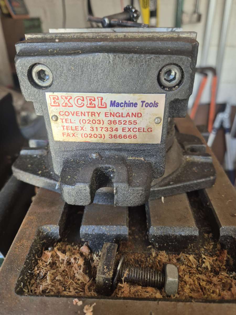

                          I see it was supplied by Excel machine tools,  it takes me back to 1980 when I visited their place to buy a cast iron 10″ table saw which I still have. The owner and his son were Asian and the saw I wanted was out of stock so they let me have the more expensive version at no extra cost. I remember putting my back out as I bent to unload it at home and had to wait a week before I could assemble it.
