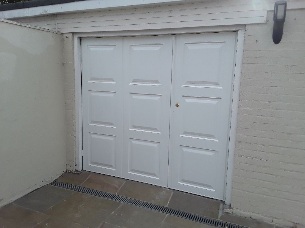

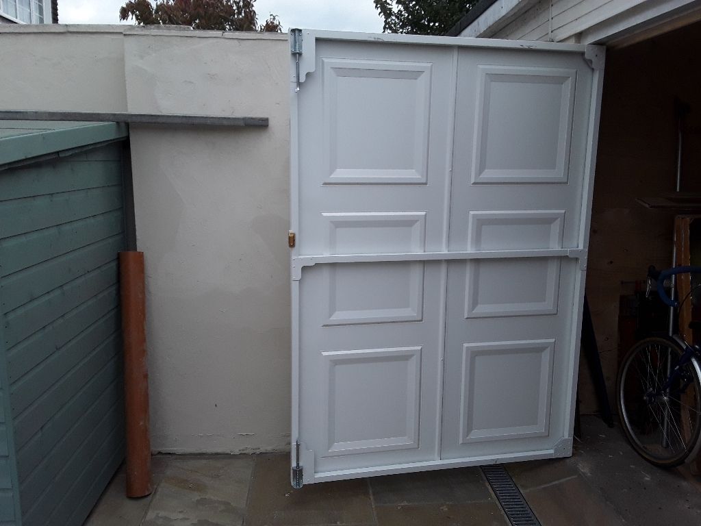

                          What would you chaps recommend for sticking Kingspan to the inside of a steel garage door?
                          TIA,
                          Rod
                          Edit: photos added
                          Edited By Roderick Jenkins on 27/10/2018 15:12:05

                            Yes I would like to know, pinkgrip failed on my metal garage door to stick foil backed insulation.

                              Maybe Silicone sealant in a good thick bead is correct for your application as this is unlikely to attack the foam in Kingspan and it should get a grip on foil. It is not a grab adhesive though so you will have to hold it in place until it sets.

                                The problem might be the different expansion rates of the metal to the insulation. Try SikaFlex 512, which is the product used for mounting solar panels on campers/mobile homes…to quote the manufacturer "Sikaflex 512 is a flexible adhesive to allow different materials to expand and contract at different rates"
                                Most importantly make sure that both surfaces are abraded and cleaned. Sikaflex instructions say 3mm bed minimum.
                                Just one note of caution! Its good stuff, once its set you will need to chisel it off to remove it

                                  It might not need much to hold it. If in full sheet form, I would cut it to exact size and secure with self tapping screws through holding strips.
                                  My workshop door (a single) has a patchwork of 25mm pieces, as it is braced awkwardly, then a sheet of 25mm over those pieces. The stiffening bits on the door were conveniently about 25mm deep, so all fitted in nicely. I may well fit yet another 25mm sheet on the other side of the door as it is inside a garage. No risk of a howling gale catching mine, mind.

                                    +1 for Sikaflex for Kingspan to steel door. It's used to hold commercial vehicle panels and trim together, not just solar panels on. Alternative similar product is Tigerseal.

                                            More seriously, silicone should work well but apply it as thick, well spaced beads as this is far less likely to work loose when affected by cycles of temperature.
                                            #377987
                                              Mirror Adhesive such as Dow 817
