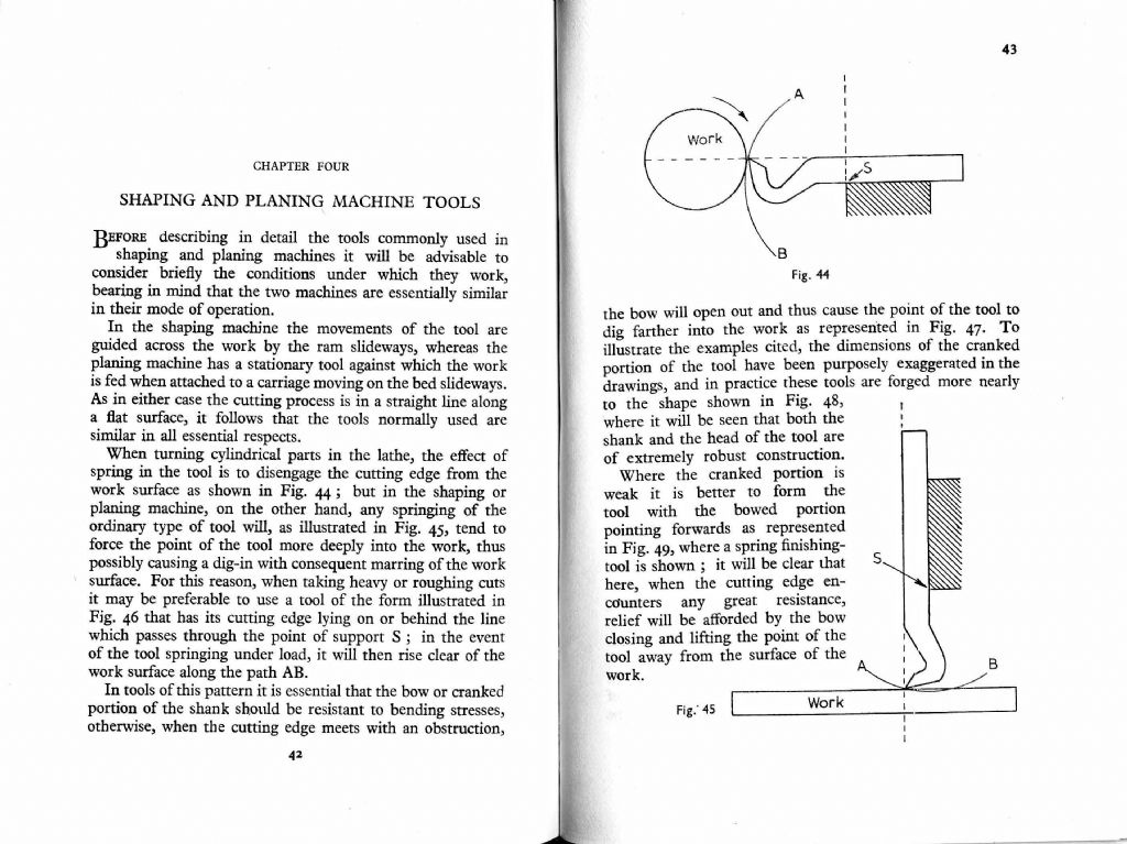

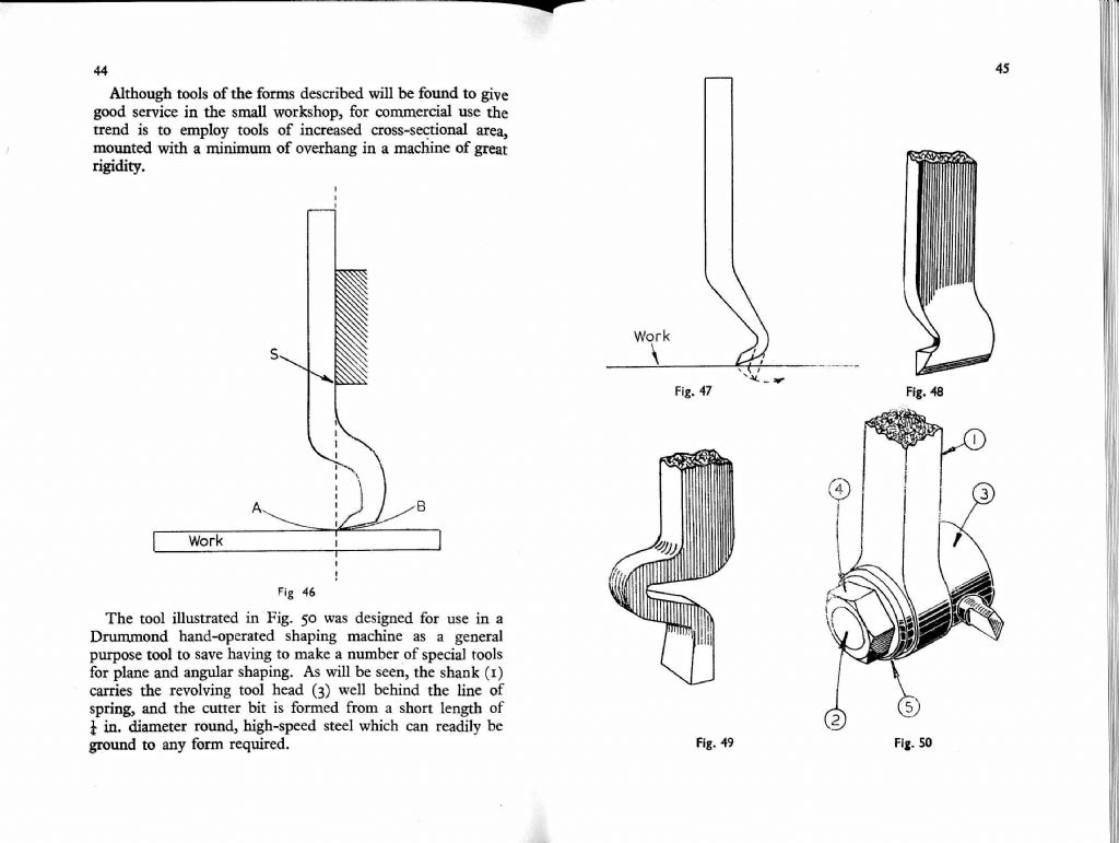

                    I mentioned a book by "Duplex" but may have been only half right. For general interest, here is a brief extract from Ian Bradley's "Shaping Machine and Lathe Tools":
                    The tool in Fig 50 was apparently made from one end of a cycle crank, a feat which I shall not be attempting although I like NDIY's suggestion of a custom tool holder.
                    #481149
                    Brian Oldford
                      @brianoldford70365
                      Looking at those lovely swan-neck tools got me thinking.
                      Wouldn't it be possible to make a tool that relieves the cut if the bend of the swan-neck moved the cutting edge further back?
                      #481273
                      John Olsen
                        @johnolsen79199
                        That is supposed to be the idea of a swan neck, however there is no guarantee that it will bend in the direction desired. If the tip has too much rake it will try to pull the tool into the job, while if it has too little it will be pushed out. I've found that the best result come from everything being as rigid as possible and the tool as sharp as possible. That keeps the cutting forces low. Flexible things like goose necks will bend in whatever direction the forces pushes them.
                        The cycle crank type is not too hard to make, the main point being to find a steel crank, since they are mostly alloy these days. The rest is mostly si9mple turning, apart from the square hole for the tool bit, and you could use round hss for that. It is actually a fairly close copy of a commercial type, I have one for my largest shaper, made by jones and Shipman. (the tool, not the shaper.) It lets you adjust the angle of the toolbit, which can be handy, but the bit has to be quite long to be usable. There are also conventional jones and Shipman type tool holders for shapers. The difference from the lathe ones is that there is no built in rake. I have one, but it is too big for any of my shapers, it needs about a 24 inch shaper. My biggest one is 18 inch.

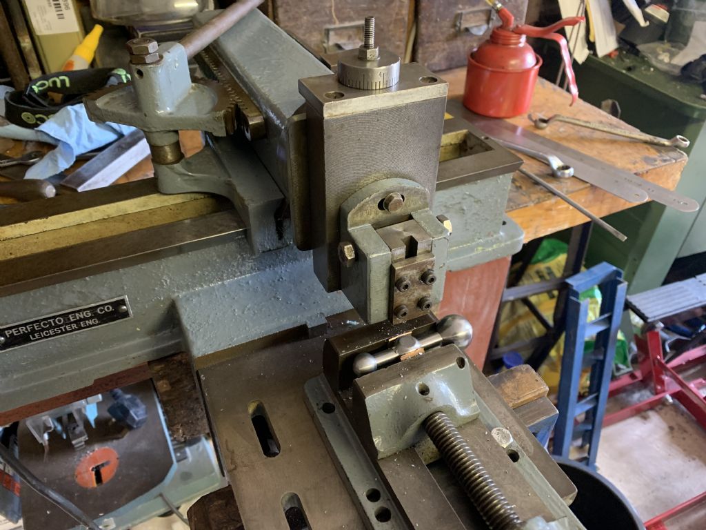

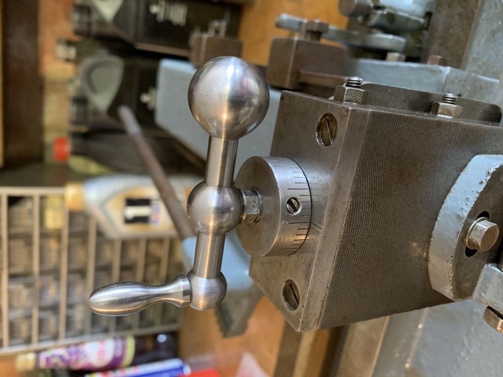

                        Mark Knight 4
                          @markknight4
                          Finally got the handle finished, thanks again John for the drawing, I’m really pleased with the end result
                          I even put the shaper to good use in order to produce accurate flats on the spheres.
                          #483177
                          John Hinkley
                            @johnhinkley26699
                            Nice looking handle, Mark. Glad it turned out so well for you.

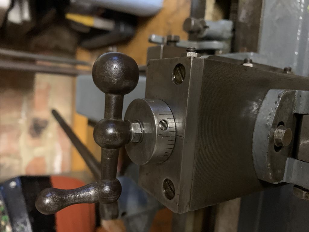

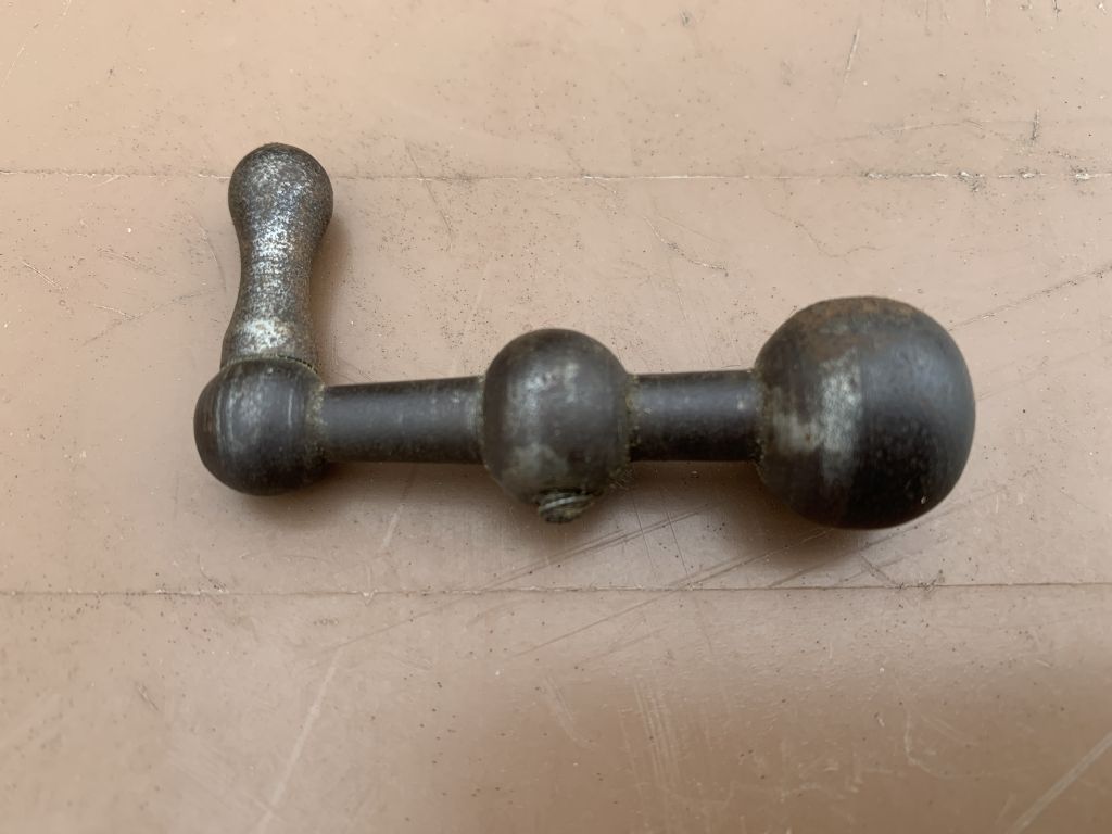

                              Mark Knight 4
                                @markknight4
                                Thanks Rod and also thanks for the handle drawings you posted a few days ago.
                                Now would you believe it, a couple of hours after finishing my new handle, I was looking through one of my Dad’s boxes of bits and this was in there!!!!!
                                I managed to get the broken stud out and put it on the shaper.
                                Much as I love my new one, I value originality more. This is now exactly as I remember using it about 40 years ago in my grandad’s workshop. Oh well, I enjoyed the challenge of making the new one!
