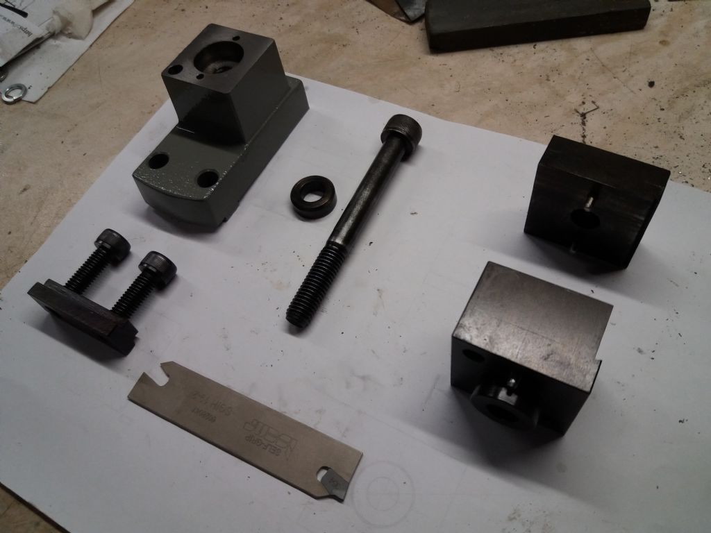

          I made a rear toolpost last year and it is excellent. I can part off at least 50mm bar without thinking about it and i can just loosen the top bolt slide the blade to required length and tighten still on center height. I am still using the same tip I fitted last year which hasn't worn amazing.

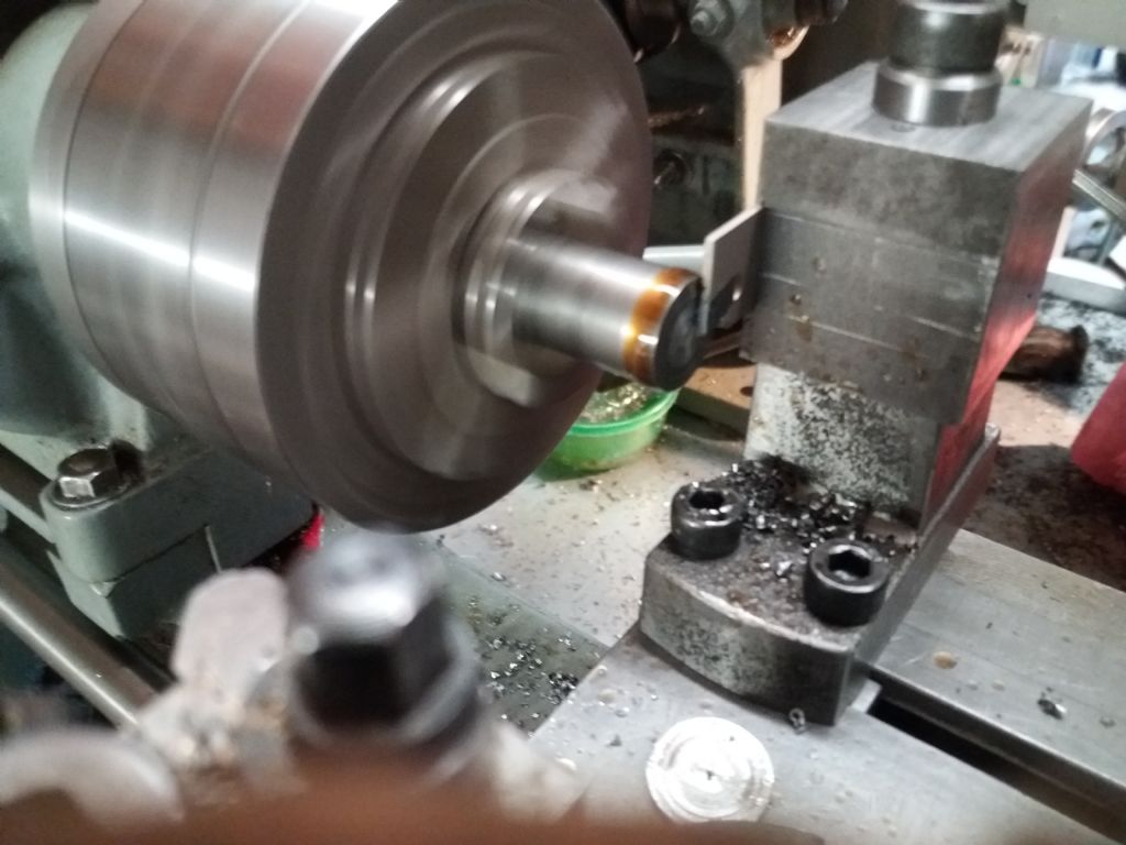

                  Not found an issue with the RDG one" nosediving" myself, worked OK doing the cooling fins on this bit of 40mm dia steel in a standard front toolpost.

                    I like the idea of a narrow parting tool. So far as I can tell from their website, the RDG blade is 1.4mm thick.
                    I assumed that the RDG clamp would have to project from the toolpost but Jason seems to have minimum stick-out?

                      This shot shows the stickout better

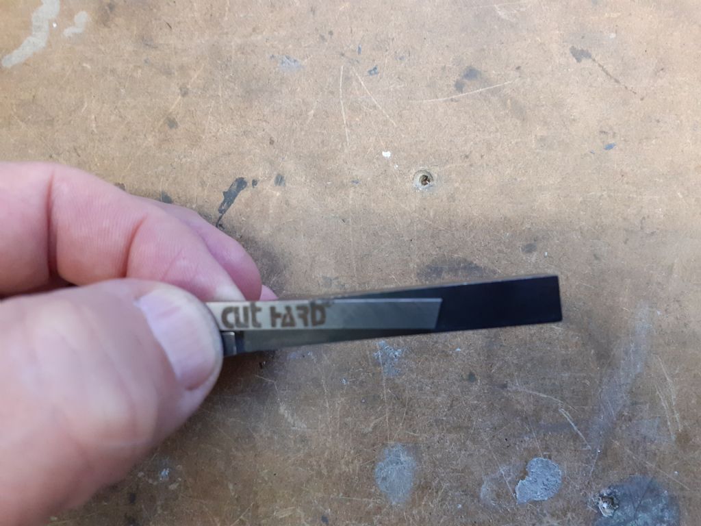

                      I tend to use this on material upto about 20mmdia as being a 1.5 x 6mm blade if you have much more out of the holder it can start to wander off sideways quite easily. I also have the ARC version of "another Chronos parting tool" which is similar width and 8mm deep, main advantage of this type is the tool is clamped firmly as I did find the single clamp type can let the tool slide back into the holder.
                      My preferred thin parting tool is the Nik-Cole Minithin with the 1mm wide insert but that will only do 12mm dia, it can also go right upto a shoulder unlike the single clamp type.
                      Bigger stuff gets done with a GTN2 insert tool
